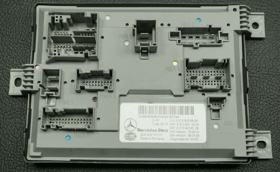

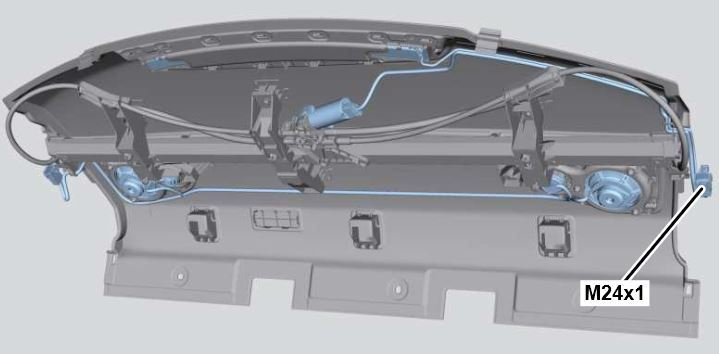

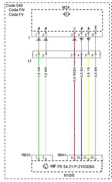

Worst case scenario rear SAM or shade motor may be intermittently malfunctioning. As suggested always best to pull codes but not sure any will be stored in this case. Here is wiring to check shade & rear SAM if so inclined to do so.
