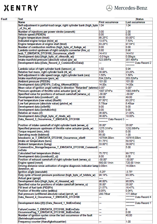

Old Nov 28, 2021 | 04:34 AM
Eng.A's Avatar
Joined: Jun 2020
Posts: 123
E300 4matic
Attached is the diagnostic result
Old Nov 28, 2021 | 09:01 AM
chassis's Avatar
Joined: Sep 2018
Posts: 14,696
Likes: 4,587
From: unbegrenzt
2017 GLE350 4MATIC
Please post the results of a XENTRY compression test.

Old Nov 29, 2021 | 04:12 AM
Eng.A's Avatar
Joined: Jun 2020
Posts: 123
E300 4matic
Still parts didn't arrive here is the extra pages from the report that I posted earlier,
It shows the following codes
P030085
P030185 (this is cylinder 1 which will we will replace its coil)
P06DA00
I notice the following (the car shake if it is between 1-2 rpm )
once I park the car too it shakes
the eco start/stop is not working at all
oil temperature/ radiator temperature is on good condition.
during my 150km trip yesterday, it wasn't having any issues in highway or any shaking only shaking occurs once i slowdown
I'll start with spark plugs then change a coil and hopefully it is not piston issue
