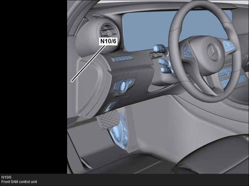

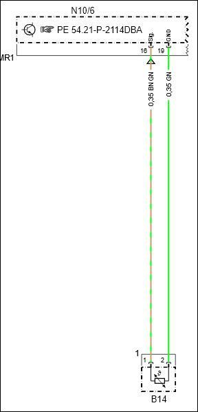

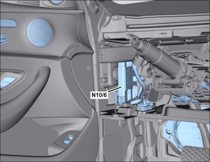

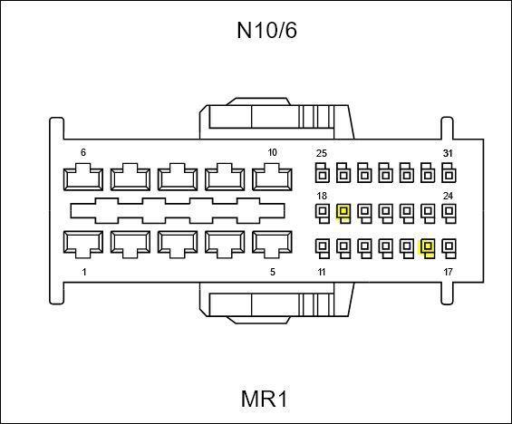

P0073, changed the sensor but still no temp
Changed the sensor and the temp still reads as - -.- and the CEL is on. P0073 was the only code that read when I scanned.
Anyone have any idea for fixes or should I take it to the dealer. Im starting to suspect the harness or that the code is a symptom of another issue.
