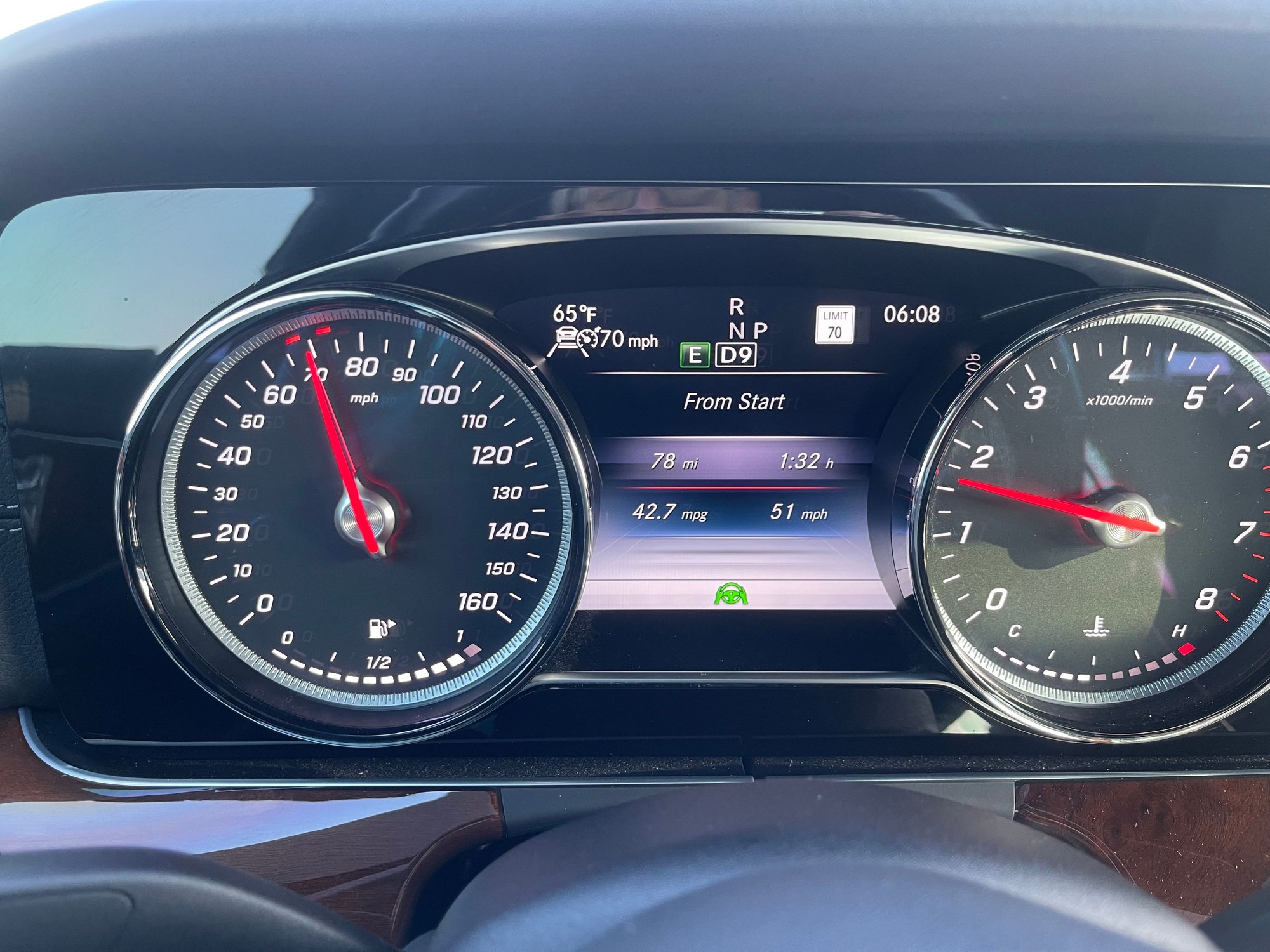

I’ve been pleased with my mileage
Originally Posted by Alan Smithee
Another fan of ECO mode for the AT wagon here. Engine response seems no different than in the default, and I don't mind it shutting off when not on the throttle; the stop/start integration is seamless while in motion. It's part of what makes this a cutting-edge ICE drivetrain. (That said, gas mileage has continued to disappoint.)
IMO the best part about ECO is the suspension setting. The shocks stay in Comfort, yet the springs lower for better aerodynamics...which yields less harshness than Sport over sharp road imperfections, and better body control than the default. Can't get that combo in any other drive setting, or Individual. Downside is you have to settle for the light and lifeless Comfort steering.
But, yes, I would like the drive mode to default to the last setting. The pop-up is a poor workaround in the UI; when it comes up varies by 2-8 seconds...often behind the backup camera image...and it only stays up for about two seconds, which is often not long enough.

^ Pretty sure we have different models.
Old Apr 22, 2024 | 10:09 AM
DeutscheBenz726's Avatar
Joined: Mar 2018
Posts: 356
Likes: 76
From: Elizabethtown Kentucky
2019 E 300 4matic 2013 SLK 250
2019 E300 USA version
