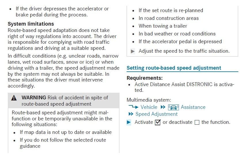

Have a new E450 and used Distronic Plus and went under a toll camera area. Shocked us when the car quickly slowed down to a crawl. This happened every time we went under a toll camera area. I could press on the accelerator and it would resume but it was very surprising to see that fast slowdown.
I assume the system thought there was a tollbooth at the location, but there have never been tollbooths at any of these locations. Is there a way to disable this? In Texas we fly through those at 70-85 mph so it’s definitely not safe to have the car suddenly slow down like that.

That is the route-based speed adaptation. All explained in the owners manual. Probably should read that to understand how your car behaves in various situations. It can be turned off as well.

Ahhh… I thought this would be something I could change somewhere. Thank you!
