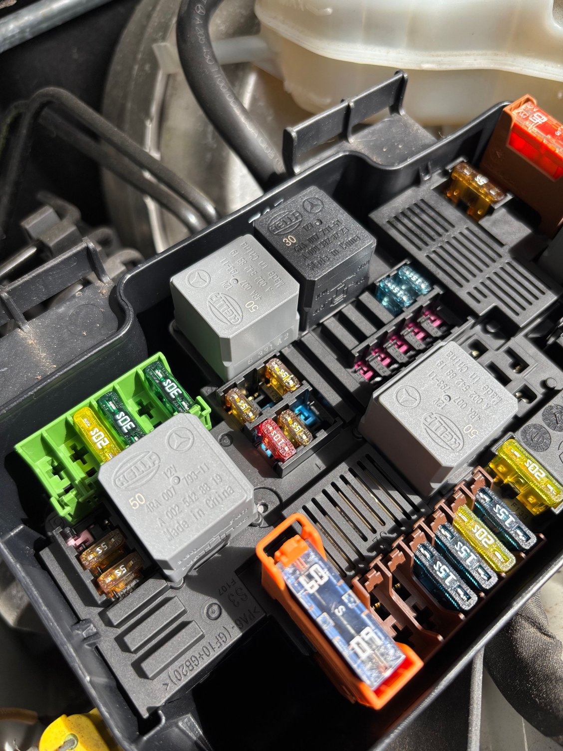

I’ve been doing some digging and it suggested that it might be a fault with one of the fuses under the hood. Location 121. That was a 10S fuse and although it looked OK I have just swapped for a standard 10 and the car now seems to be fine. Fault gone.
I’ll check the 10S for continuity when I have a moment but aware the S designation is, I think, for a slow fuse type. Perhaps the new voltage converter just needed some time to clear the codes.
Let’s see, I guess relay is next if needed. Hopefully the fuse has failed and lack of continuity would be a nice simple confirmation.

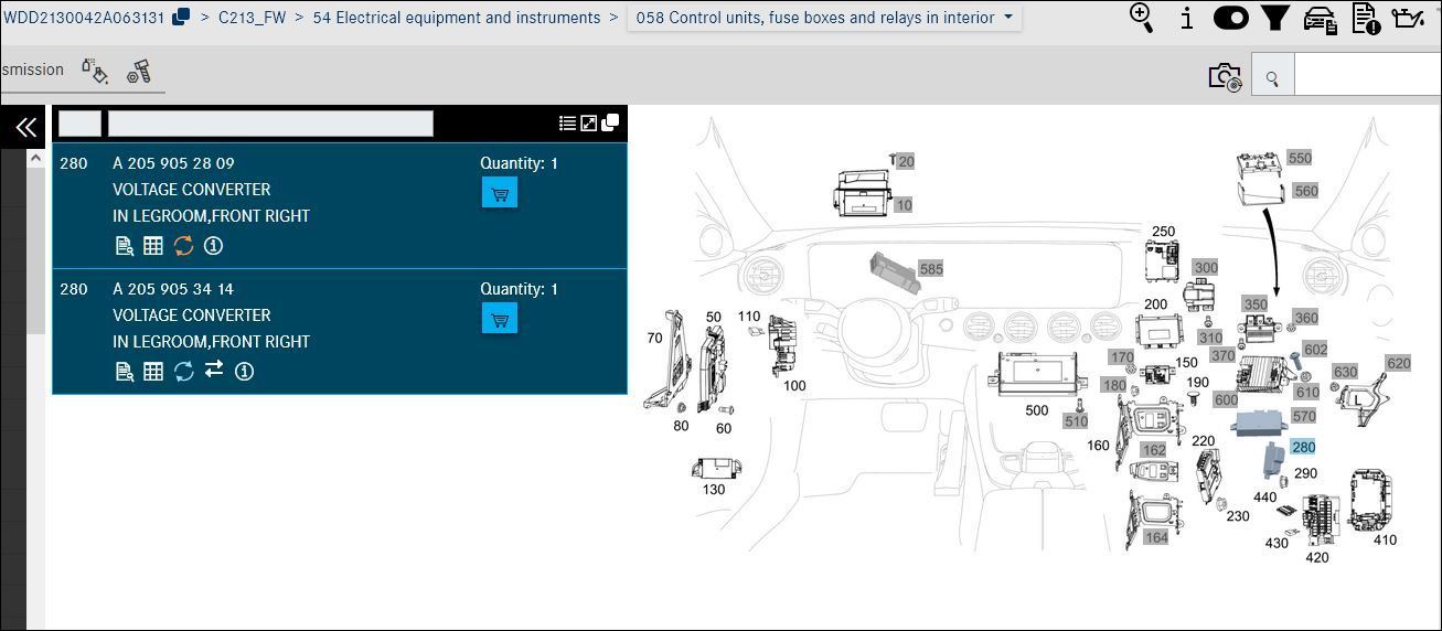

No relay as it pertains to your vehicle since there is no aux battery but rather voltage converter. Regulator is just storage that replaces battery.
File Type: pdf

So, OP bought an auxiliary battery for a car that doesn't use one?
Is A2059052809 a voltage converter that looks like a battery?
Me confused...

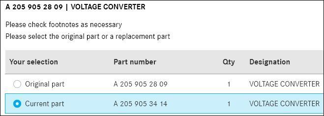

The Mercedes part I removed from the car was: a2059052809 and the two replacement parts claimed to be compatible.

EDIT: This is quite an old thread so I won't bump back up. I thought I had updated but apparently not. In summary, this finally got a new voltage converter (or whatever it is called) from the Mercedes dealer and the problem went away. Has been fine for a long time. My advice? Buy genuine parts in this case.
Thanks for sharing but I have done the swap a few times now!
Does the updated part number make a difference?

Using Xentry (MB diagnostics) erase all stored codes & perform quick test for definitive answer. Reluctant to do so 2809 would most likely be aftermarket or used unless supplier is liquidating old MB supply new, try current 3414 MB genuine.

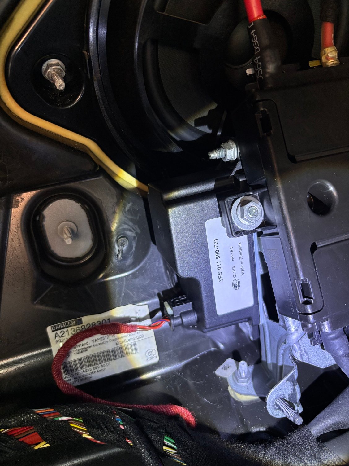

Thank you for your thread. S213 2017 e250 wagon with m274
i had a low voltage on main battery because i had not driven it for 6 weeks
started getting the annoying auxiliary battery malfunction message.
i replaced the main battery (was old anyway)
This didn’t fix.
so I went and replaced the voltage converter module under the passenger floor carpet.
this didn’t fix.

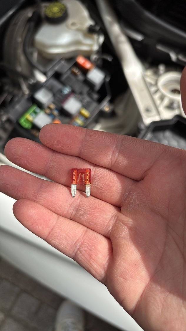

checked engine bay fuse box, found the 10s fuse you mentioned and it was blown.
replaced this and the error message went away.
hope this information helps anyone in future with same problem and saves them from some expensive diagnostics with Mercedes mechanic
