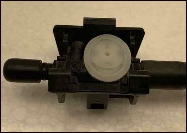

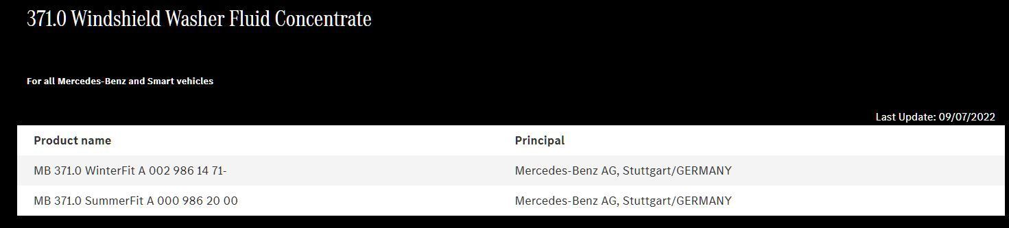

Normally aftermarket fluid causes problem i.e.: Rainex, etc. check for nozzle blockage first. Attached reservoir instructions & parts info.
