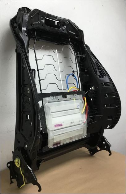

Remove backrest cover to expose lines (photo 1) if fine, you will need to remove/disassemble backrest valve block is located forward of frame (photo 2) see attachments.

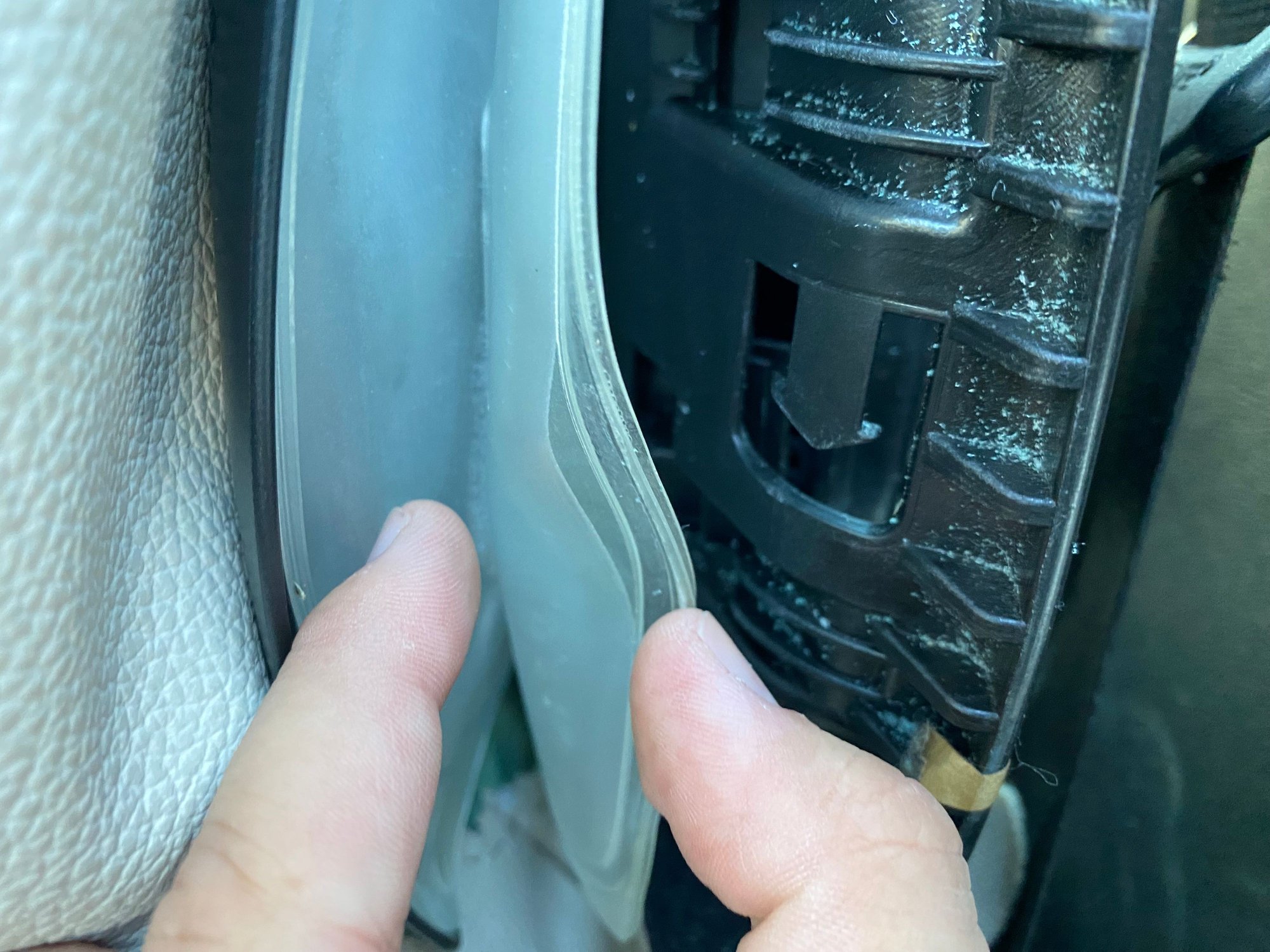

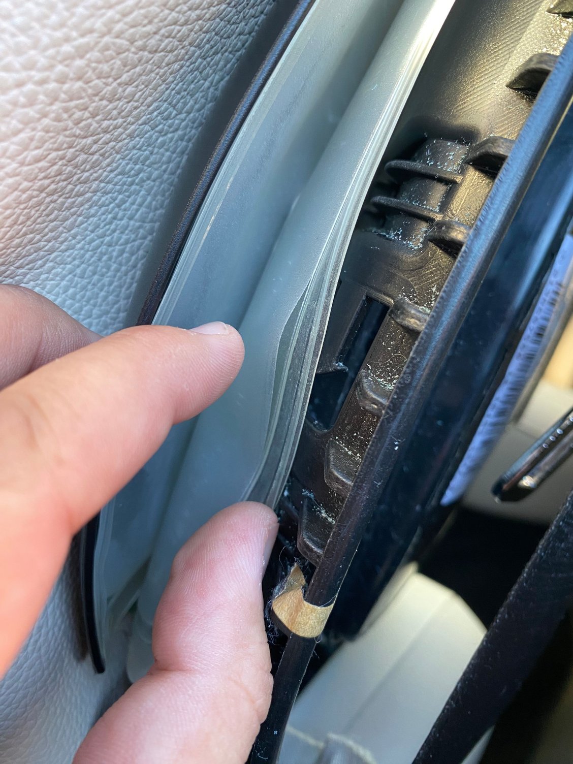

Mani thnaks @konigstiger !! The problem was burst side bladder on my driver seat (see pics). Now im trying to find a proper solution to fix it. I saw videos where i can use iron, but it not seems to be a long time solution. Is there a chance to replace only the cracked bladder and what's the part number for it ? Or just i should use some vinyl patch with glue and duck tape to secure it ? I'm open to different solutions, but if MB sold bladders separatley i will buy one. But if i should buy the whole kit for one seat i will pass.
EDIT: Is there a way and how-to guide to remove the side bladder + the plastic support ? This will save me a lot of efforts to fix it.
