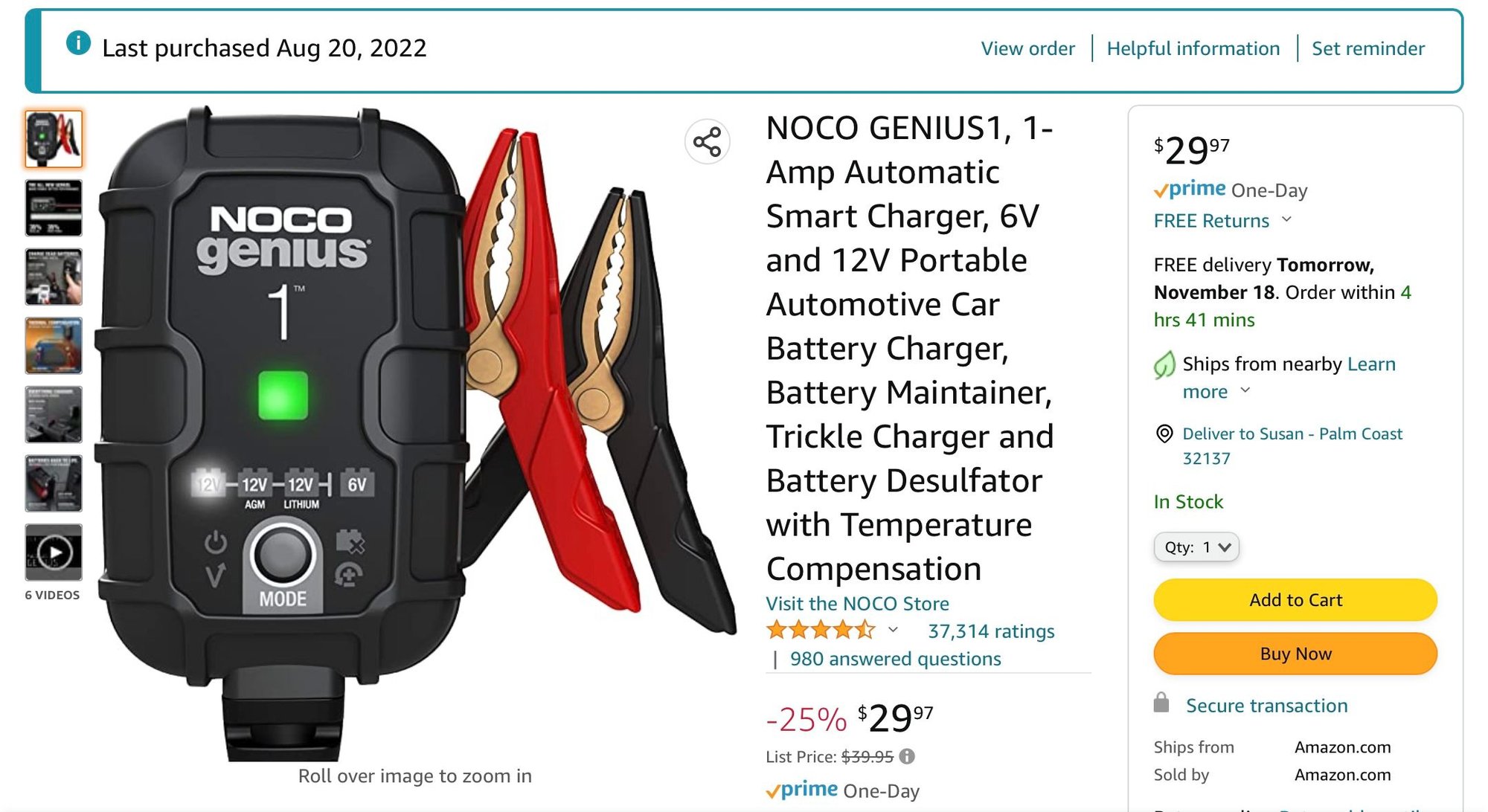

I bought a 1 amp charger for $29.95 on Amazon and hook it up occasionally and all is good.

Yes, AGM is a must, they are also standard on the E-450s, as far as I know.
As a long time boat captain I have seen the difference in performance and longevity between various batteries and AGMs come out on top.
Look for the Deka brand but they also make batteries for other companies and slap their labels on, West Marine, Costco, etc.
(On boats we abuse batteries more than on cars: Sit for anchor several days and run your fridge, your lights, your stereo etc, run them down, charge them up,
rinse and repeat week after week, year after year)
This trickle charger is what I use, highly recommended with a selectable mode for every battery type:
