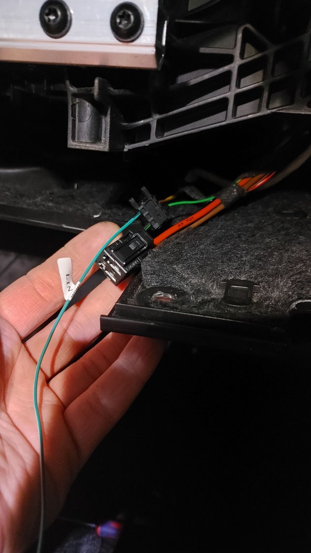

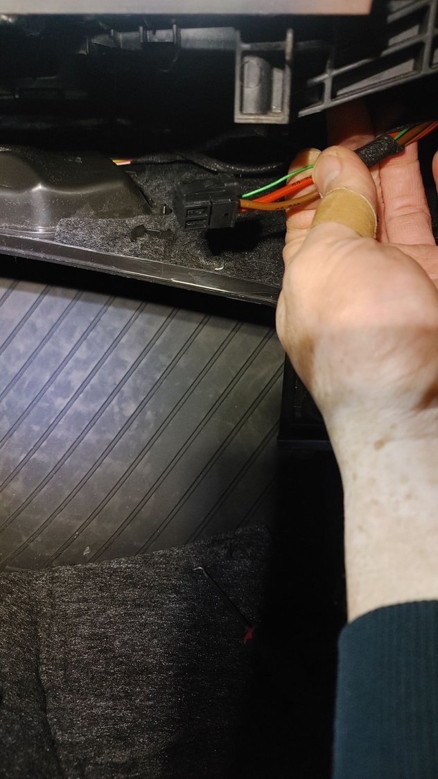

Originally Posted by DrJonesLaw
This was not my experience. Would you mind sharing your wiring? I have mine installed, the place I bought it from did the coding remotely, but I cannot figure out the wiring. I have the power and the gnd, but there are two more wires that must be connected to wires already under the dash.
Yes, 1 wire is tapped into blower motor. Look for the thin green wire.
The other wire is connected to glovebox light assembly.
See top 2 pictures.
See top 2 pictures.
I went back and did this as much as I think I could. In the picture it appears to be a white wire, my car appears to have a gray wire. However, I am sure that is just my eyes or picture quality.
Do you (or anyone else) have troubleshooting skills? When I go to the menu to turn it on, the default is "off" when I check one of the other choice ("low" "med" "high") it indicates my choice, and then 2-3 seconds later it goes back to off.
When I choose the ionization choice, it allows that.
The unit LED light is on. But it has done this since install. I am sure I have hooked up something wrong I am hoping someone can say "yes, you did X wrong, change it to Y" because I am getting tired of taking off the dash and glove box starting anew each time and checking all connections!
By yhe way I have 4 wires.
1 for fusebox
1 for ground
1 green wire labeled LIN
1 blue wire labeled BOX CHECK.
LIN wire connects to factory gray wire.
BOX CHECK connects to glovebox light wire.
