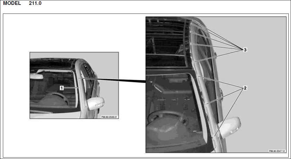

No adhesive just varying clips so either deflector and/or clip(s) should be replaced under warranty. Non to worry about water penetration serves as a water channel (211 shown).
