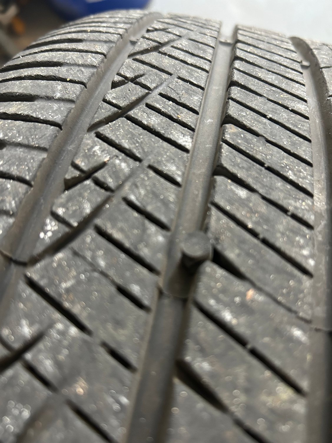

Got the leaky tire patched at Discount TIres, no charge. Will run these Run Flats a few more miles, then buy the Michelins in a few months.
(Have to quit spending money on houses and boats first)
Noticed today that the tire actually has a plug in it, rather than a patch..
I know, plugs are ok, but patches are better...?

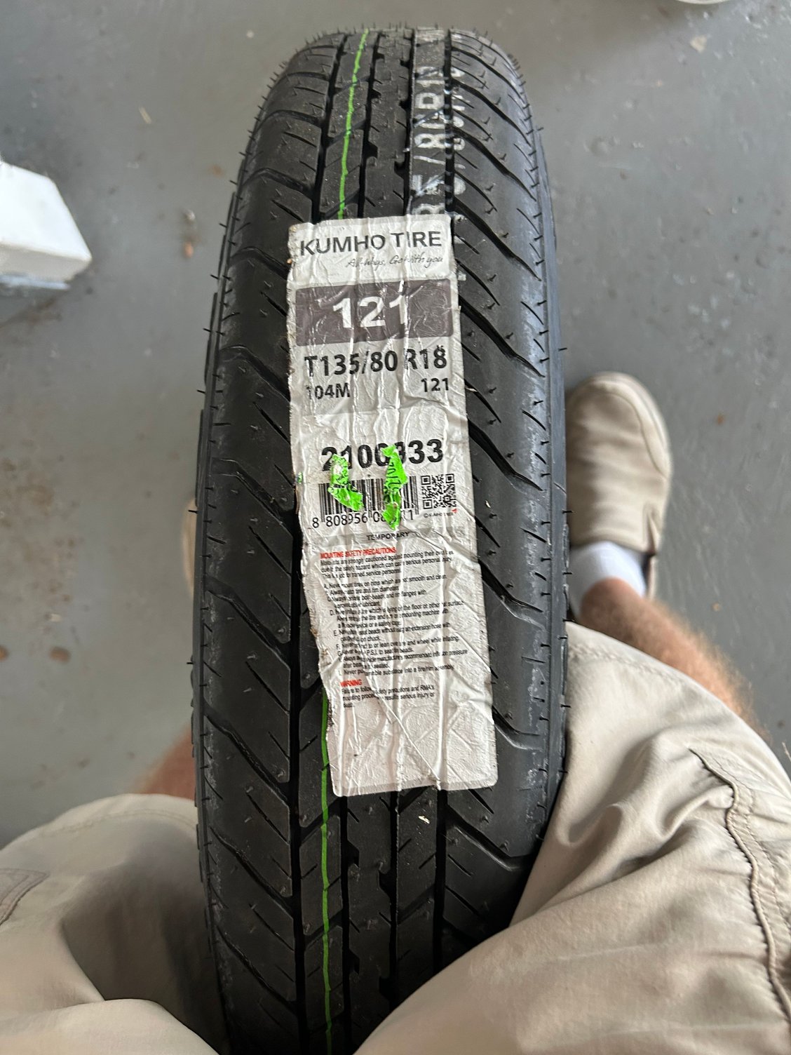

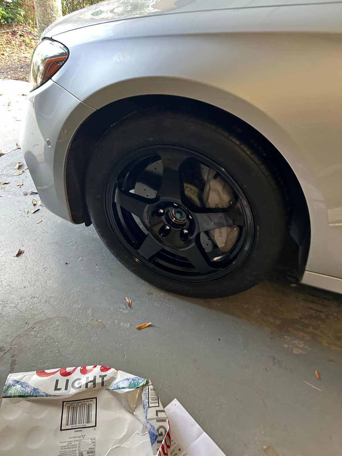

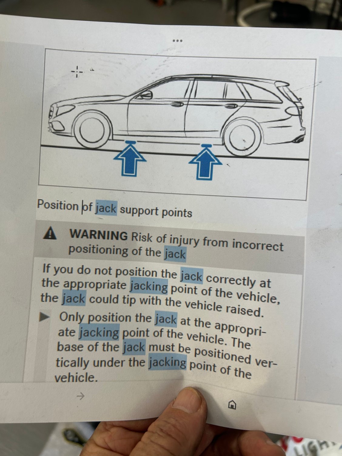

Got the Modern Spare kit today and decided to take it for a spin to check that everything is working.
Took me 12-15 minutes to remove the left front and mount the spare and about the same in reverse.
My initial thought driving on the spare was that it was "thumping", like it had a flat spot, I only went down the street
and back 2-3 minutes, maybe the thumping went away, Checked the pressure, 55 psi, 60 was the target. Close enough.
The Modern Spare kit was nice, everything was included and seemed to be good quality.
What I will need is cushion or pillow for the knees and a pair of light gloves.
Used an empty beer case to sit on instead but pillow next,.
All good,

It's both. A proper tire repair involves patching and plugging it from the inside. The plug keeps moisture from getting to the belts and cause corrosion.
Perfect, thanks..​​​​​​​

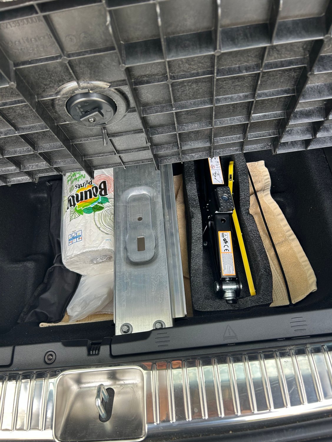

I will leave the tools, the gloves, etc in the trunk, under the floor where the Teutonic Engineers made space for a spare tire:
No spare for us Yanks in the colonies so the space under the aft floor is a free-bee for tools, rags, and stuff.
My Modern Spare will only be carried for long road trips. Need a flat floor for my doggie, she goes to the doggie park every day, or for a boat ride,
Tools in the trunk:

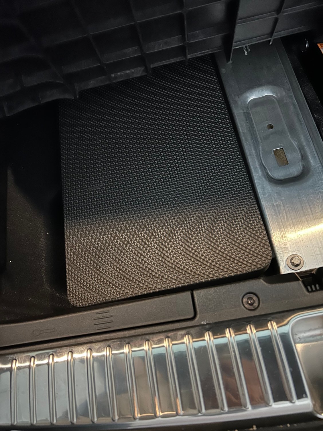

Got the Amazon knee-pad, perfect fit below the aft floor.
Ready for a another flat now, bring it on...

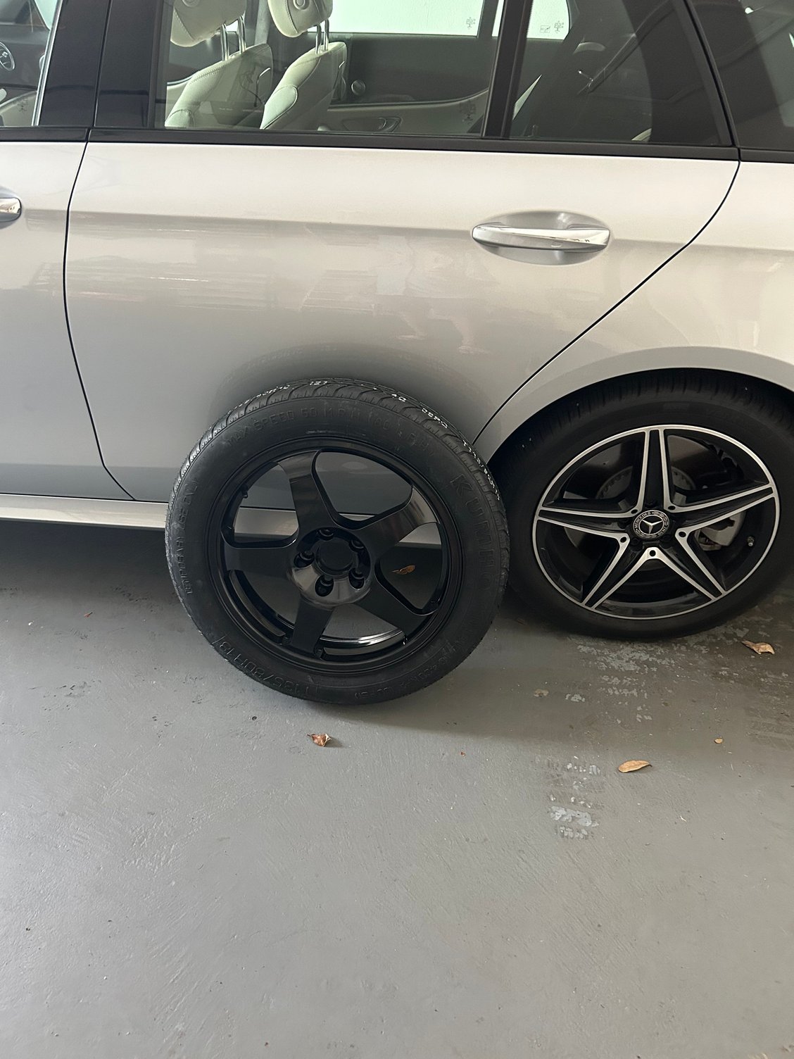

Took the skinny spare to Discount Tire today for a balance and to get the pressure adjusted from 55 to 60lbs.
They added air, but refused to balance it.
I asked WHY and the tech responded I was not supposed to drive on it: Only for emergencies!!
Told him I understood that, but I also wanted a balanced tire for my next emergency.
He replied there is no way he could balance it.
Yeah, I will contact Modern Spare and perhaps another tire place about balancing, but does this sound weird to you guys?

Never heard of balancing a compact spare. Full size spare yes, but the spare would already be balanced from the factory, so why do you want it balanced again? I'm assuming this spare has a 50 mph speed limit and max distance of 50 miles like compact spares do, so really even if you have a bit of a wobble on the drive to the next tire shop what does it matter? Wondering if the balancing machine simply doesn't have the parameters for these compact spares.

That spare tire is M rated up to speed of 81 mph. They should be able to balance that tire, try a different shop. Mechanics don't like to balance spare because you are suppose to go slow on them.
Honestly, if I were going to store my spare tire in the garage and only use it on road trips, I would have bought a matching size spare.

Once the new spare tire is balance from the factory, it should stay balance until you drive on it or something fail.

the tyre shop did not have weights for a steel wheel.
The spare is aluminum, not steel.
​​​​​​​ Once the new spare tire is balance from the factory, it should stay balance until you drive on it or something fail.
Don't think so, no weights on it and I felt or heard a weird thumping when I took it for a spin, not sure what it was, but a balance machine
should find any problem.
​​​​​​​ Honestly, if I were going to store my spare tire in the garage and only use it on road trips, I would have bought a matching size spare.
Good point, but a full size wheel is twice as big and twice as heavy, this 81 mph spare is a good compromise.
At any rate, I sent a message to Discount Tire head quarters, they asked the regional managers to deal with it and yesterday I got a call from the manager
at my local Discount Tire store: He was very nice and invited me to come in with the spare and have it balanced.
Will do just that tomorrow.
Stay tuned.​​​​​​​
Stay tuned.
From tirerack: "The smaller physical size requires the Kumho T121 spare tires be maintained with 60 psi cold tire inflation pressures and driving speeds restricted to 50 mph maximum driving speeds."
​​​​​​​A full size spare is better for your application since you are only using the spare on long trips. If get a falt on a long trip, you could just replace the tire and not have to look for a tire repair shop while you are on your road trip.
