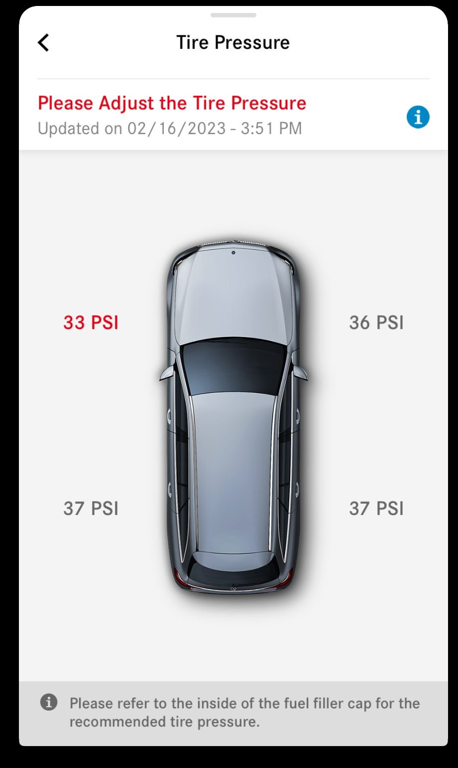

Got a low tire warning today and it kept going down.
Had to cancel lunch with friends and head home before it went below 30psi.
(No MB dealer within 35 miles for nitrogen fill)
The pressure went from 36psi to 32 then back up to 33.
(The tire pressures have been rock steady since I bought this car 15 months ago)
Stopped and looked for a nail or a cut in the tire, nothing.
Measured the pressure to 35 in my garage when back in my garage.
Looks like the sensor was bad.
Is this common? How much for a new sensor and installation at the MB dealer?

Don't know how people still fall for the nitrogen scam. The only advantage that pure nitrogen has over the 78% in regular air is that nitrogen is an inert gas, meaning it doesn't absorb moisture. The biggest issue and why race cars use pure nitrogen is the moisture in the air that results in unpredictable tire pressure increases once the moisture turns into steam. Race teams need to be able to exactly predict the tire pressure at any temperature. That's not something that's even remotely of concern in a regular E Class. One additional advantage is that nitrogen molecules are larger than oxygen molecules, so they are less likely to escape through the pores of the tire compound, so natural loss of pressure is lower, but with regularly checking your air pressure and topping off with a simple compressor or even a floor bike pump is all it takes. Nitrogen still expands and contracts with temperature changes, so in the winter your pressure will be lower and higher in the summer even with pure nitrogen and you have to adjust it. Every 10F is about a 1 psi change in pressure even with pure nitrogen.
As for the TPMS sensors, first off what you see in the app are your hot pressures. Pressure increases as the tire heats up, and the app only shows the last pressure at the time the car was turned off. Tire pressure needs to be checked with cold tires. The sensors themselves are not the most accurate. They only have a 1 psi resolution. One of mine is consistently showing lower than actual and the other three are showing higher than actual. They are a piece of mind, but not to fully rely on and they can go bad. The battery will also run out eventually.
BTW, most shops that offer nitrogen fills produce the nitrogen on site, extracting it from the air (remember 78% in the air), and the equipment is often not the best. So what you think is pure nitrogen isn't actually pure in reality.

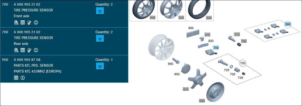

Here are MB part #s search should also pull aftermarket (kit contains 4 sensors if contemplating all one time). Check with local Discount Tire for install cost also check to see if they offer price match for same aftermarket sensor they offer found online. BTW they should also be to diagnose if sensor is malfunctioning.

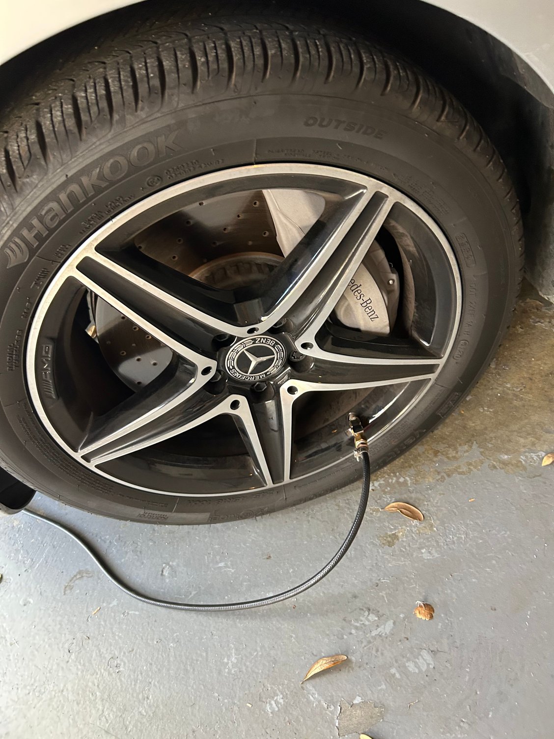

Glad I went home and cancelled my appointments the other day:
Today the tire was Flat, as flat as a Run Flat can go..
I suspected a bad sensor or a bad battery in the sensor, but it was a good old fashioned flat.
Now I will see if the nearest tire place can patch it.
If not, ditch the Run Flats and get 4 regular Michelin Pilot Sport All Season 4 tires.
My local Discount Tire quoted $1,118.02 including a "Protection Certificate", taxes and everything else.
Asked my MB Dealer for their price for the same tires, waiting to hear back,
Pumping up the Run Flat, Flat in the garage, no Nitrogen.
