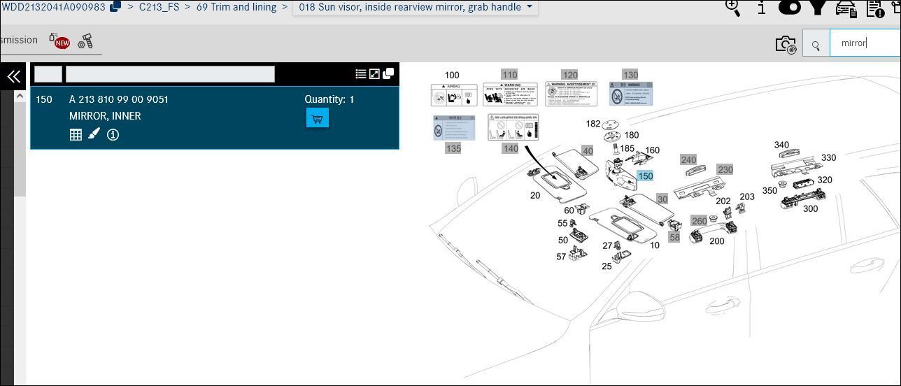

Old Mar 31, 2023 | 11:15 AM
konigstiger's Avatar
Posts: 15,901

From: North Scottsdale, AZ
'71 Pinto
Provide VIN I'll pull part #.

Old Apr 3, 2023 | 11:00 AM
Posts: 15,901
Likes: 4,632
'71 Pinto
Mirror cover can be disassembled by carefully working seam with plastic wedge to inspect internally if need be.

Old Apr 4, 2023 | 06:07 AM
Mago 51's Avatar
Joined: Mar 2021
Posts: 14
Merc. S-213 220d / Jag XJ-40 / Jag X-Type Estate
Abslolutely delighted with such awesome info.
Think will try to open the seam with some plastic tool or credit card for inspection, before dismantling anything else.
The bug is there, right behind the glass. Gently pressing my finger on the edge, the noise disappears. I'll keep you posted with he outcome.
