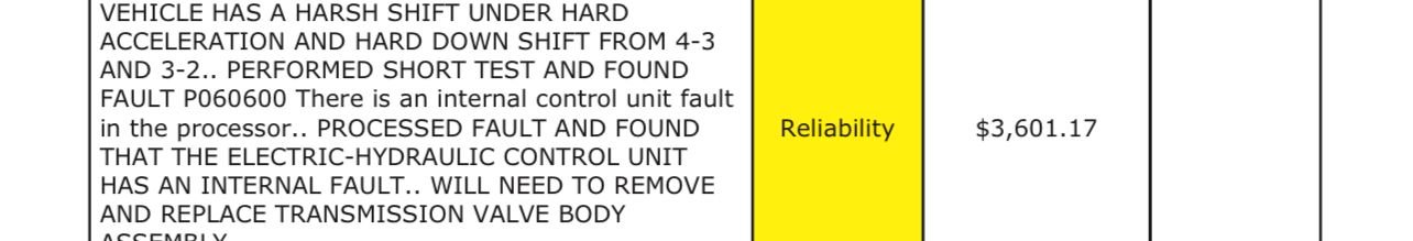

If your transmission jerks when shifting into drive from park, the reflash will not fix the problem. The issue is more likely to be mechanical or electrical, perhaps when the tranny warms up, something overheats such as a solenoid or a sensor.
they are still diagnosing it. Hope didnt do damage to the gearing. The dealership did mention that the fluid didnt have any metal shavings. Very confusing
Old May 16, 2023 | 06:22 PM
The G Man's Avatar
Joined: Oct 2015
Posts: 1,583
Likes: 293
2019 E300
i am glad they found the problem. Changing the module and valve bodies should fix the problem.
Hmmm that is pretty big, I wonder what led to the failure of the valve body and how it failed...
> Tall tab :
I believe you've had to pay to get a highly trained factory experts to produce this inflated estimate. I would ask for the written breakdown in parts and labor and the terms of the repair warranty.
What's gonna happen once you pay $4,000 with tax and your car still has the exact same poor shifts after 30 days of driving...?
> Valve conductor gamble...
I think dealership is aiming to fix this common isssue by doing "adaptations" and want to ensure the solenoids mesh filters are not plugged up by chunks of abused clutch material. Hence the valve body replacement.
> Transient fault?
I bet the tranny initial DTC fault is a stored transient error this is BEGGING TO BE RESET before any confirmation.
On the flip side if the exact same fault can be consistently reproduced then you have greater chances to get it fixed without painful aggravations.
Your poor gear shifts fall into the grey area of poor driveability performance... there is no error for that because: It is shifting!
