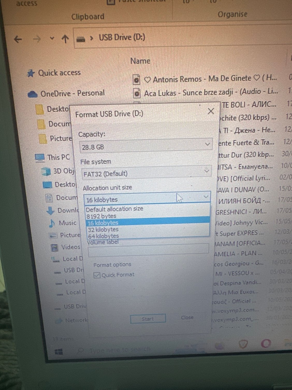

5.5 NTG is the version…
Here

The cluster size may be affecting performance. Try using the default size.
