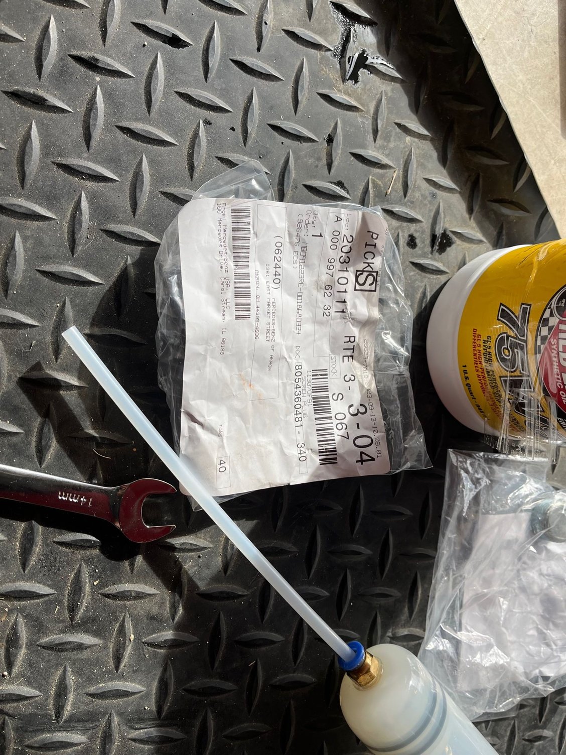

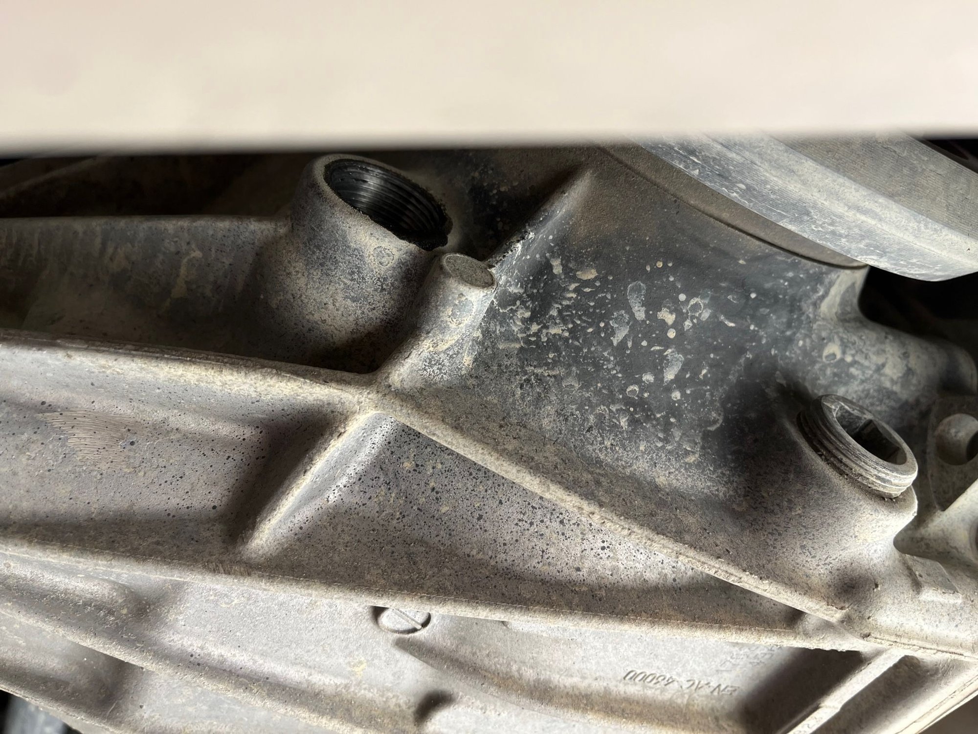

Changed the rear differential fluid today. There are two 14MM hex drain plugs on the driver side. Drain plug part number in the last photo.
