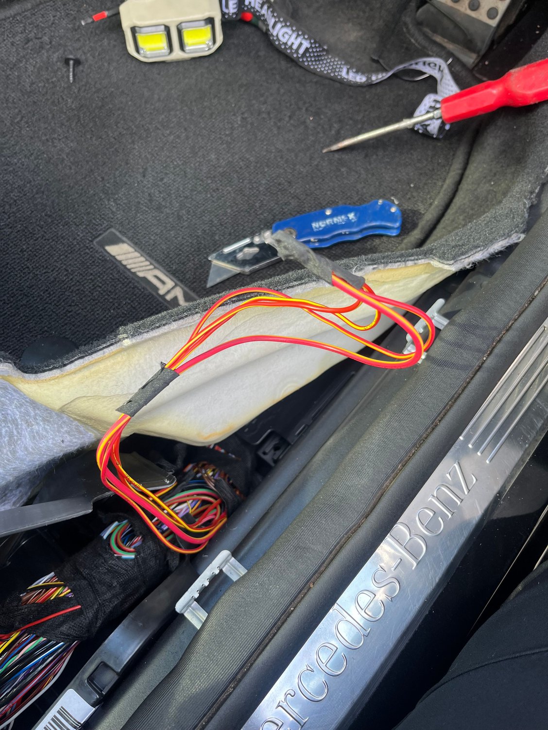

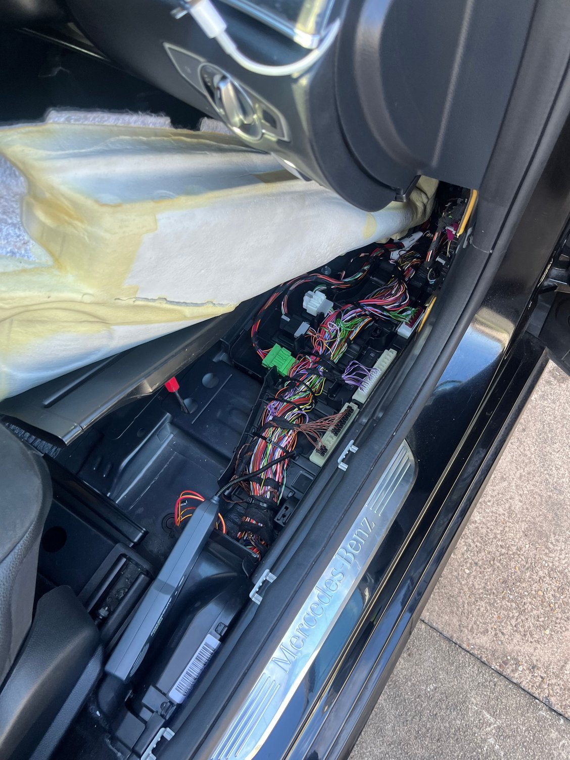

Followed red with yellow strip

I followed this wire from fuse box into driver side (right hand drive) footwell it’s goes into a a bunch of wires that splits back into the car and then I have up. 103 fuse is still blowing. Somebody must have resolved this issue. Pls help !
