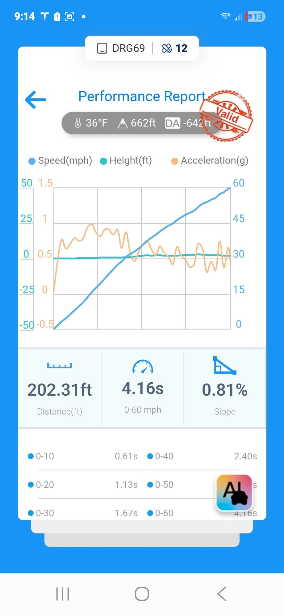

Sorry to hear after all that work the car did not go any quicker.I want to thank you for the information on Dudmd. After having problems with Jb4 including car having to be towed because it would not start with Jb4. Did get my money back. I had the Dudmb tune installed. 0.3 quicker than Jb4 . Best 0-60 so far is 4.16 on my 2018 E400 sedan
Temp was 35F which helped.
Good call on DUDMD; his tunes are solid and the pricing is tough to beat. I likely would’ve stayed with him if he offered TCU and CPC support.
​After a smoke test, I managed to track down and fix a boost leak in the charge pipe, replaced a leaking PCV, fixed the vacuum pump check valve, and swapped the boost controller. My 0–60 is down to 3.7s now, but I’m still chasing some missing boost. I’m also dealing with a bank imbalance. The CTS race cats have a poor fit (02 downstream sensor doesn't clear the axle), so I’m running a spacer on the sensor just to make it work so it reads a bit rich. I have it tuned out so the cats dont throw a light but it still returns voltage so it messes up my long term trims on that side. That being said based on air volume calculations its pushing 525hp at the crank.
