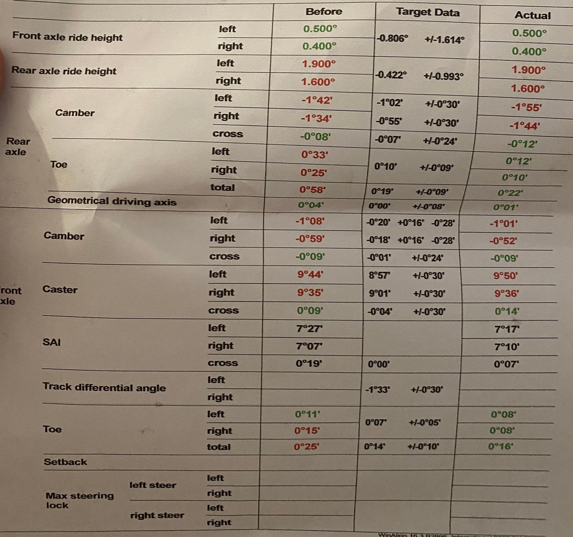

I Just had a wheel alignment done and I’m not sure how to read the report, please let me know if it’s all good or if I need to do another alignment…

Left column is OLD before they adjusted.
Right column is New After Adjusted.
Red = out of spec
Green = within spec.
Target = Spec and tolerance.
your Camber is out of whack and they cannot adjust it.
Penty of threads on Camber and how you have to modify suspension by using KMAC adjustable bushings or other adjustable Camber arms.
Wearing tires on inside edge? Camber Issue.
Notice they adjusted TOE which changes camber a little bit.
They did not go over with you?
