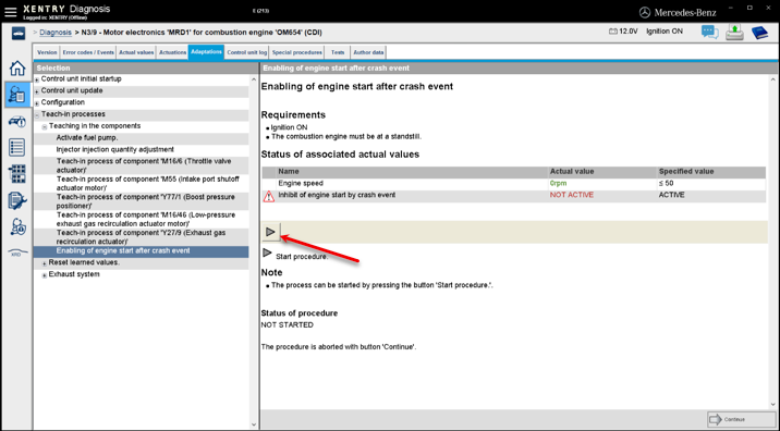

Hey friends,
Have you dealt before with a crashed Mercedes that cannot execute "Enabling engine start after crash event"? No matter how many times I try, it keeps failing.
Car is 2017 E220d, front hit, airbags and seatbelts engaged.
My MRD1 ECU & FCW213 Active Brake Assist show B1C3200.
SRS ORC213 module shows several active errors for the deployed airbags and seatbelts. (Clearing errors won't remove active ones obviously)
What should be the action plan please. I would like to get the engine started before I work on fixing airbags and seatbelts. Do you know how I could clear the crash event from ECU and is it really the reason that causes Enabling engine start to fail?
The screenshot is to show that apparently H relay for circuit 50 is blown, I'm ordering that one in the meantime, but that cannot cause Enabling engine start to fail, or can it?
Thanks!

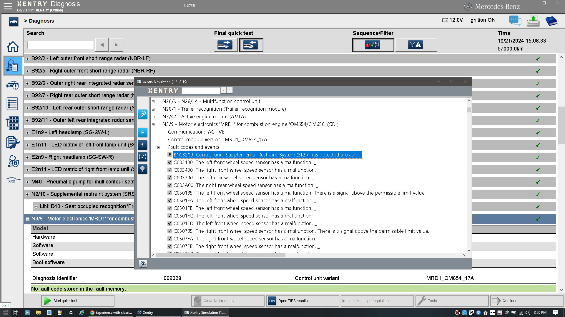

The screenshot is from Xentry, as I load N3/9 - Motor electronics 'MRD1', I get the prompt for "Enabling engine start after crash event" but it keeps failing... I'm suspecting it's not working because of the active errors in SRS (airbags/seatbelts).
There is B1C3200 stored in module.

The deployed airbags haven't been removed yet, I think some folks put resistors to make the ecu think those airbags were replaced. I never knew you could simulate a Xentry session like that.

There is a function called XENTRY Simulation that lets you try to recreate conditions and simulate behavior. They aren't always exactly what you want, but still a good way to learn what you can do.

This is my desktop with the BenzNinja copy of XENTRY and other software that he provides. You can see that XENTRY Simulation is a separate program.

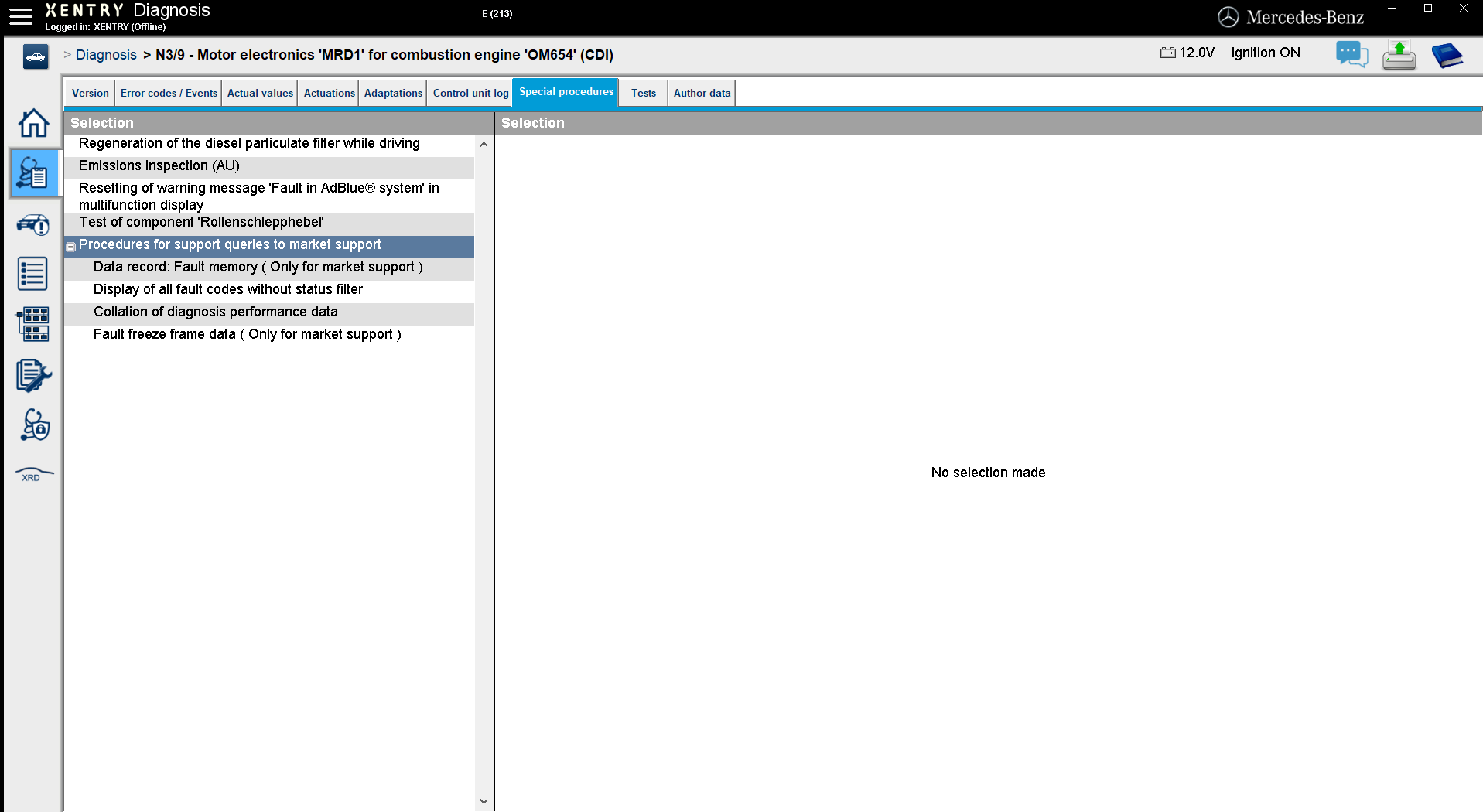

@JettaRed are you able to load the "Special procedures" tab of SRS/ECU please? Mine was password protected, I wonder if there is anything useful there.

Here's the tab. However, if there is a procedure that requires communicating with Mercedes online servers, you will need BenzNinja to do it since he has the license.

Under Adaptations, there is a procedure to Enable engine start...
Old Oct 21, 2024 | 06:55 PM
amandine's Avatar
Joined: Oct 2024
Posts: 25
Thank you @JettaRed , yeah that's the adaptation that kept failing for me, someone had mentioned that weak battery could cause such failure, I'll have to give it a new try with a new battery.

Removing stored DTCs was possible, but the active ones like the one I had mentioned B1C3200 persist.
Thank you very much for the very clear instructions, yes after clicking that button it tries the procedure but in 2-3s it comes back with the error that the procedure wasn't successful, I forget the exact wording. I will try to record it next time I check on the car, but I'm suspecting the weak battery may have something to do with it.
