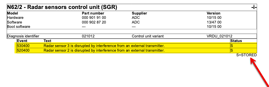

The problem is (at least for my 2015 car) is that Active Parking Assist isn't always available. I often get error codes about my sensors being disrupted and that disables the Active Parking Assist. I have no idea what the external transmitter is. The DTCs always show as Stored, meaning not currently active.

Ah ok, that’s what the dealer fobbed me off with on the test drive “it’s too busy a car park”, but it’s never worked (had it 1 week), it’s always coming up with the error.
just glad I’m certain it does have the feature now, and hopefully they’ll figure out why it’s not working.

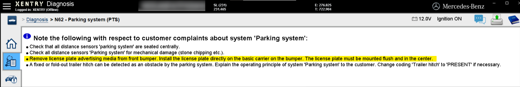

Here's something else I found. Basically, it is saying to remove any license plate frame and ensure the license plate is flush with the bumper. This is another great use of XENTRY.
