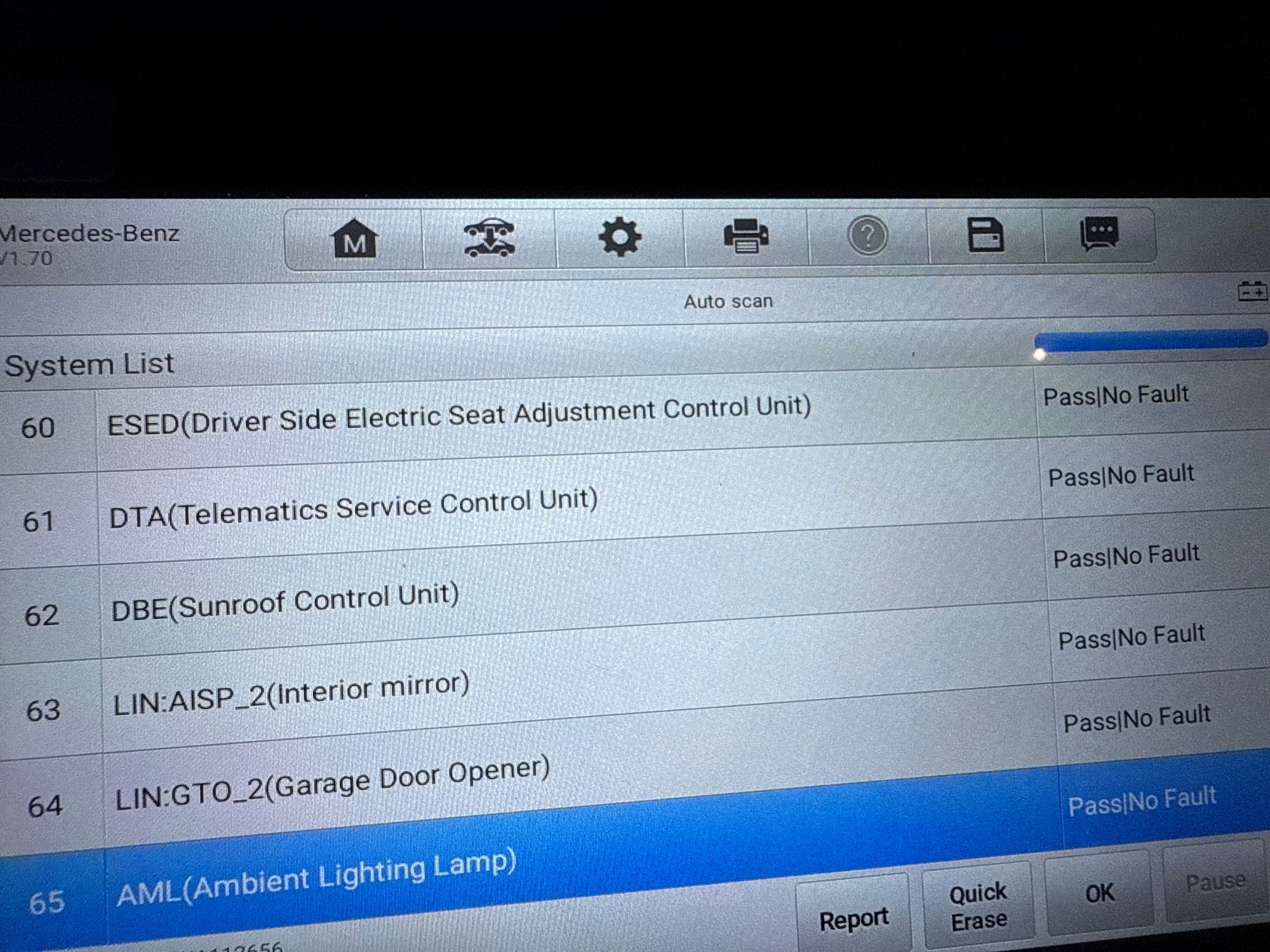

So I spoke to another MB dealership in CT and they too told me that there is no teach in process, and that I should bring the vehicle in for an inspection of all wires, the LED chip, etc. Being skeptical, I bought an Autel scan tool and looked at the Ambient Light feature.
went to “special function” option:

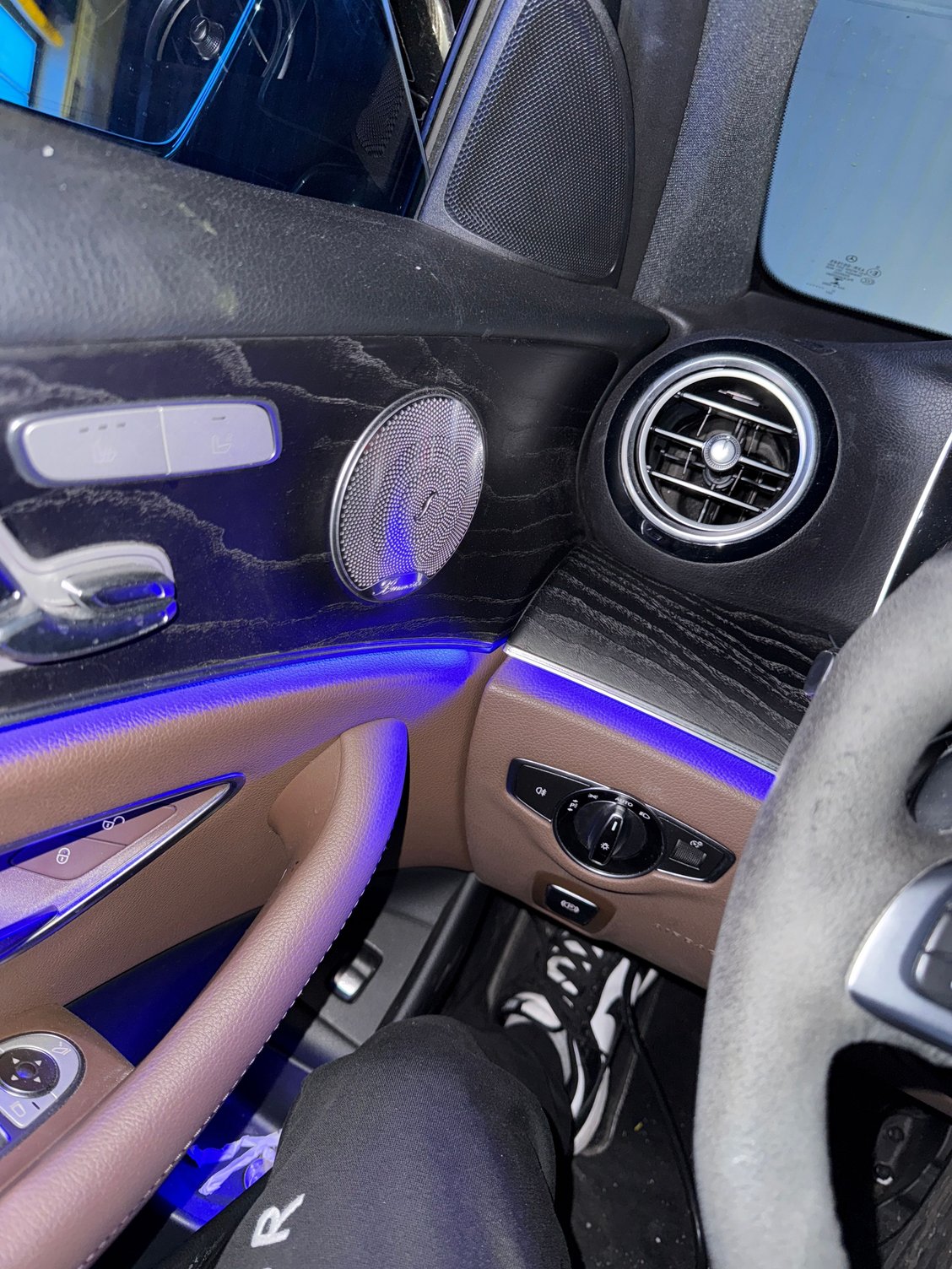

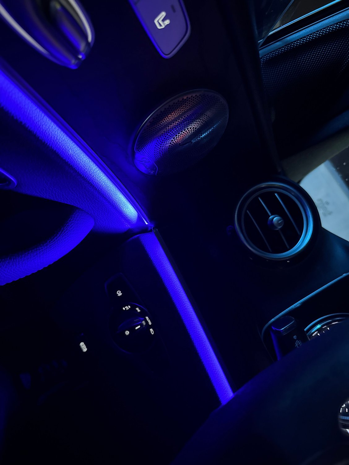

the LED now works!! If anyone has the same issue as me, replace the LED light and teach in.
