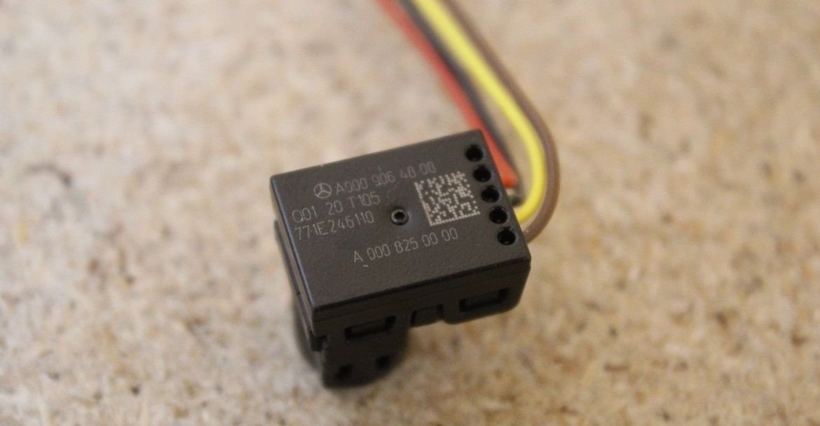

''This is one single tri-color chip supplied by external power + network.", being just one chip for all colors, there is no blue LED exchangeable.
The actual reference number is A 000 906 48 08 and it costs approximately 15$

this plastic package has convenient snaps that open up to reveal the ¢5 RGB led Chip that is questionable !
little snaps easily opened/closed
If you have luck a bad solder will save your time searching for replacement part.
One tiny LED chip integrates all 3 colors.... ebay

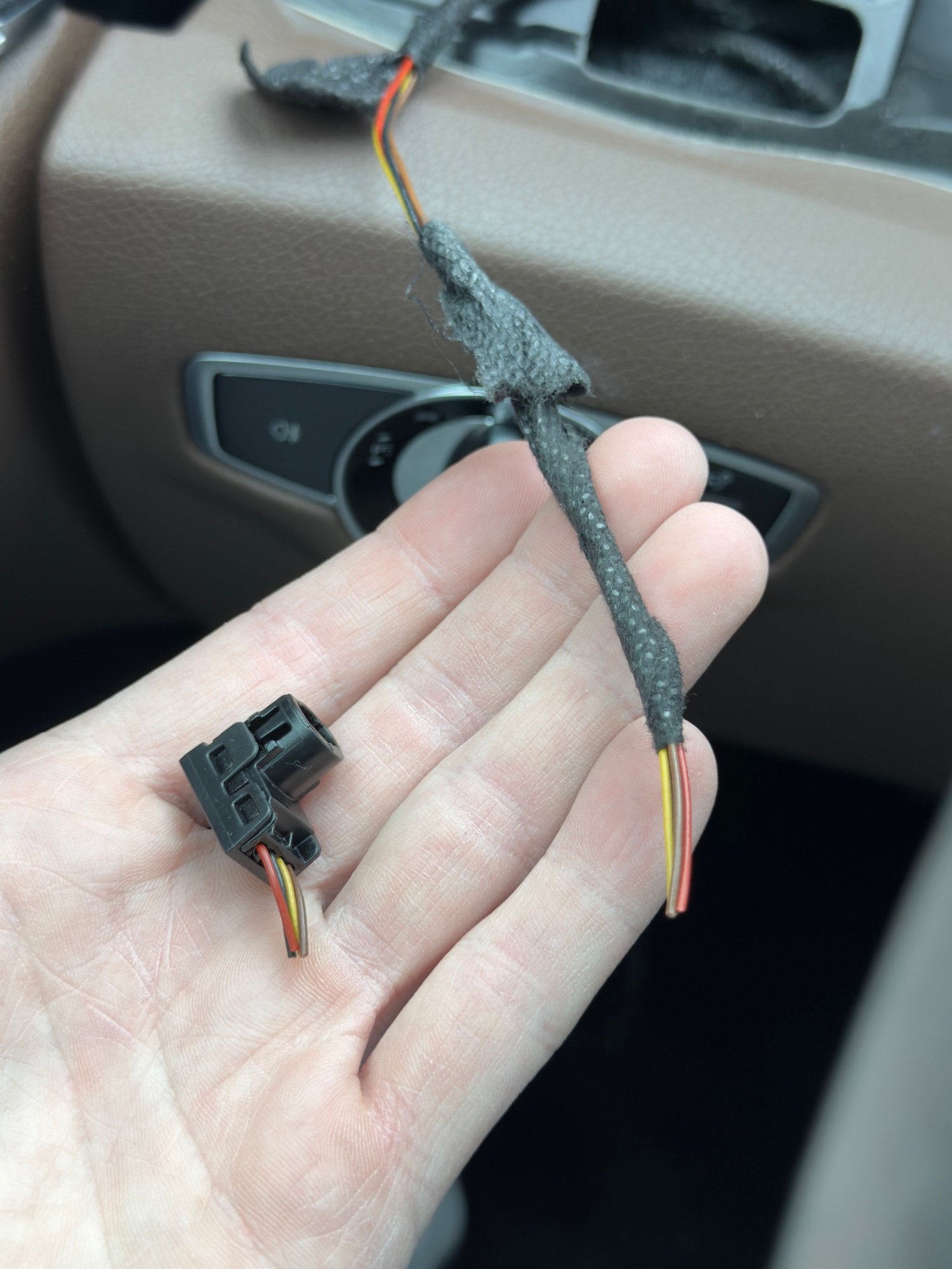

Update: Removed the plastic housing from the LED chip. You cannot simply remove the LED chip and replace it. You have to unsoldier and resolder the new chip, or you have to cut the existing cable and or splice the existing cable with the new one. Unsure what's easier, but I will be attempting to cut the existing wires and splice in the new one.
You will be okay to cut and soldier cable.
Old Feb 12, 2025 | 08:51 AM
trigital's Avatar
Joined: Dec 2011
Posts: 1,698
Likes: 489
From: Spain UTC/GMT +2 hours
W213 All-terrain
Indeed, no need to remove cover from new LED, just cut the cables and solder the new ones.

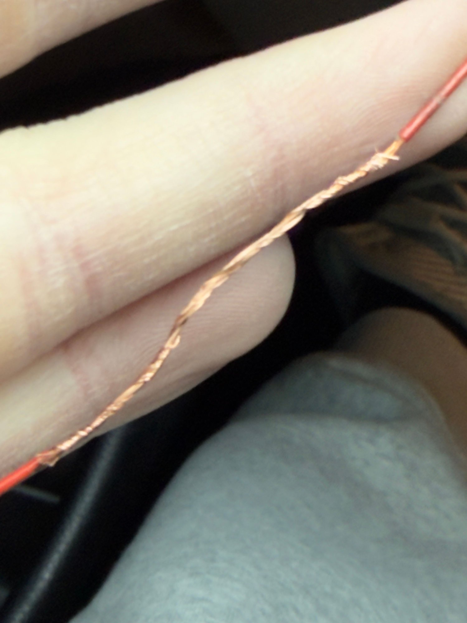

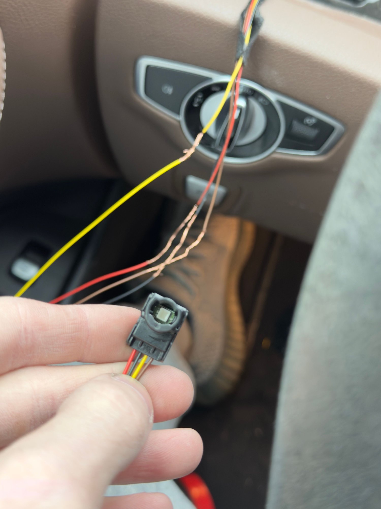

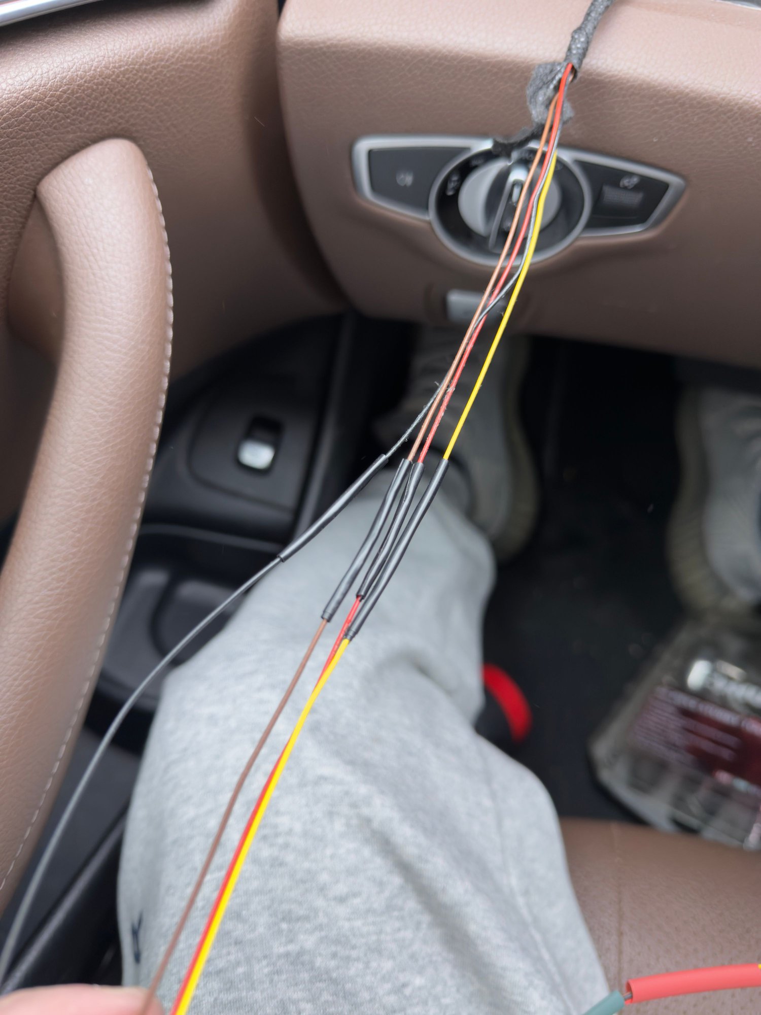

So the replacement LED chip didn't work. I cut the wires and taped the new wires/chip and it didn't work. I checked the work I did and there was plenty of connection and twists between the existing wires and the new wires. Unsure what else could be at fault here. Anyone else have any ideas?

Checked all fuses and they all seem to be fine. Also all other lights and footwell lights are working. Anyone have some tips on what to check next?

I was under the impression that you made a diag before any spending....there is no fuse for LED's but you can easily measure as Red is positive, Brown is Negative and the yellow/ black is Lin bus in/out both around 10V.
Also, as those are adresabile, sometimes after repair it needs to activate a Teach in routine with Xentry for the system to recount all the LED's.
