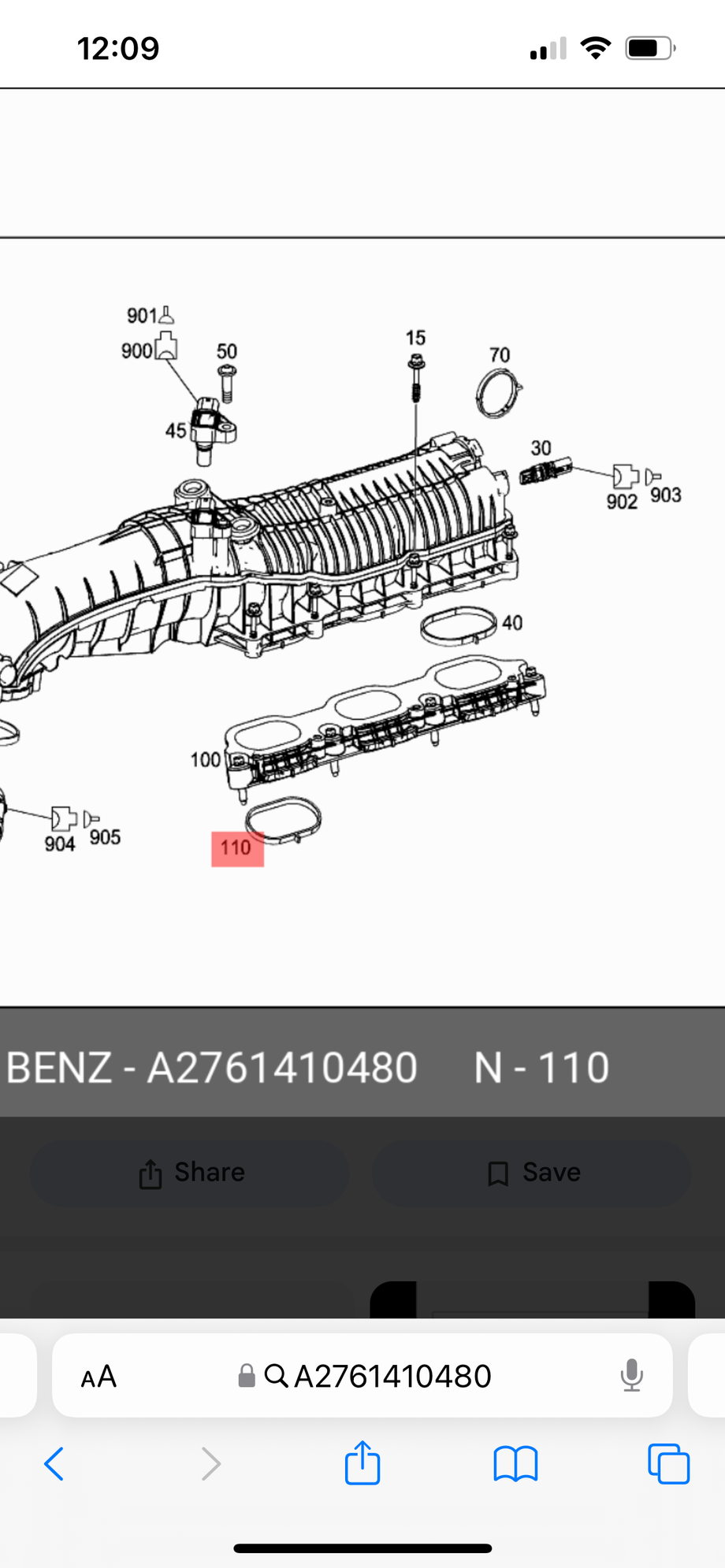

Searching for the torque spec on this type of manifold.

Are you referring to the M276 engine? You gave no context other than a part number. If it's for the M276 engine it's 9Nm of torque. A simple Google search will show you a lot of info.

Thank you. Yes 2016 V6 twin turbo. I found the same 9nm on other types of intakes like with the large round gaskets. I found this to be 9nm too.
