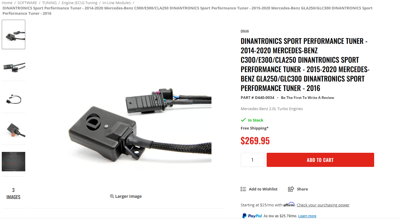

I have a 2020 e200 with a m264 engine that i want to tune, and need help with a couple of questions.
1) if i tune my engine with dinan sport tune meant for an e300 is that ok?
2) if it is ok would it give me e300 power with a tune (280-ish ig) OR e200 power with a tune (240-ish)
3) also 98 RON isnt available in my region can i still run the race preset on 95 RON? What are the possible outcomes of using 95 RON?
Im sorry if this is alot but i cant find anything online, thank you to anyone that can help
https://www.dinancars.com/products/s...arts/D440-0034

For anyone that wants to know, i contacted Dinan and they said this tune wont work on m264 engines.
It seems they changed the sensors between m274 and m264.
If you have an m264 just get the jb4 tune basically
