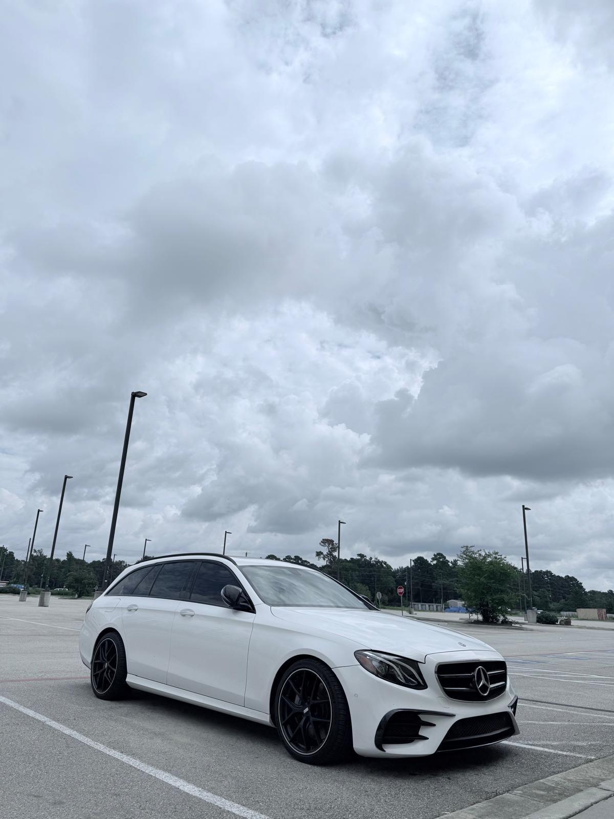

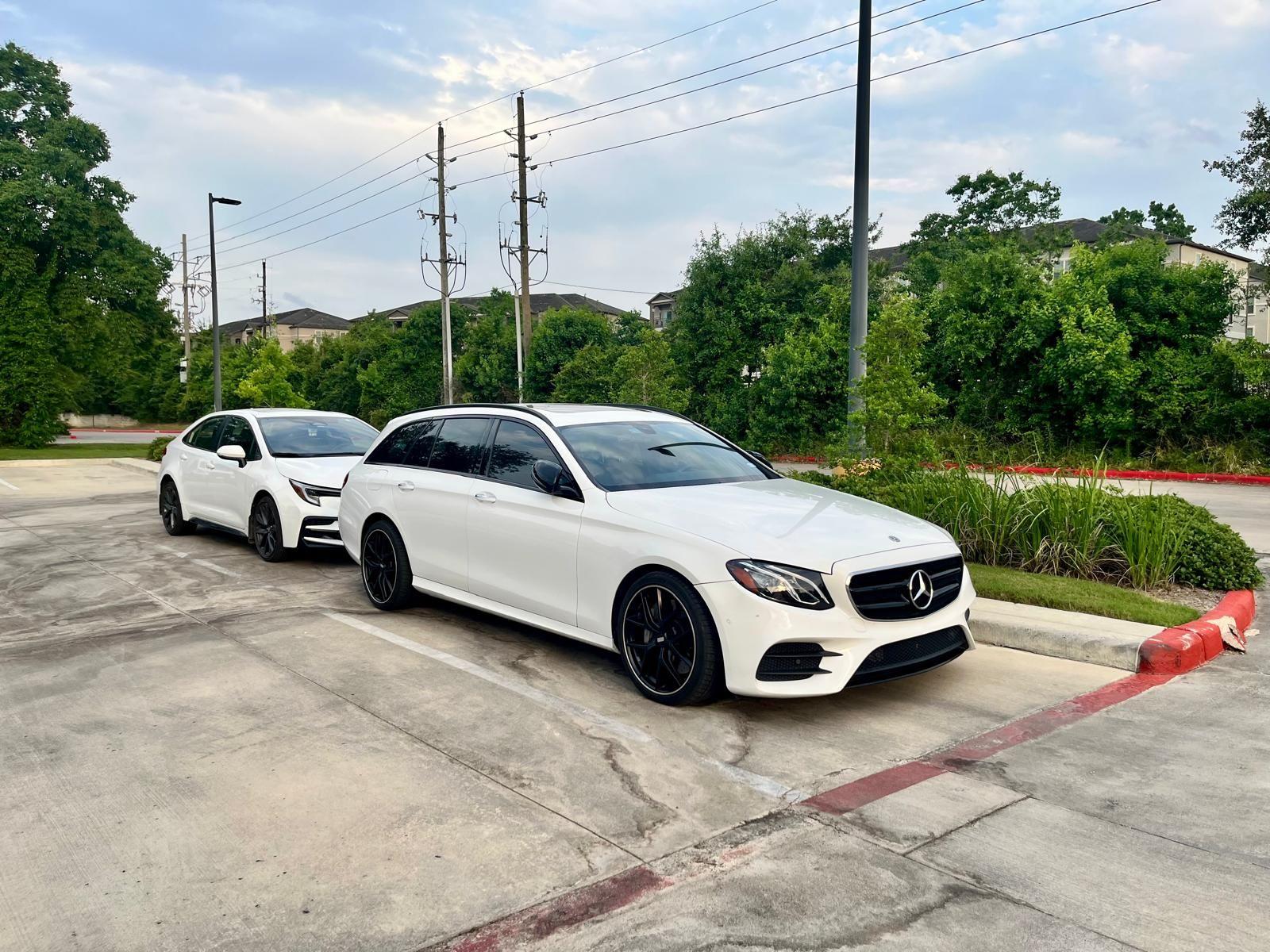

I had about a 4 finger gap before when I put the 19's and then after the H&R Springs after they settled, it was 2 -2.5 finger gap. The problem is I had the Sport Suspension on the white wagon, and on my new wagon I have the same, so I don't think the difference is that drastic. The rear links were adjusted to what the front settled down to.
Heres the before and after on the old wagon:
BEFORE:
AFTER:
