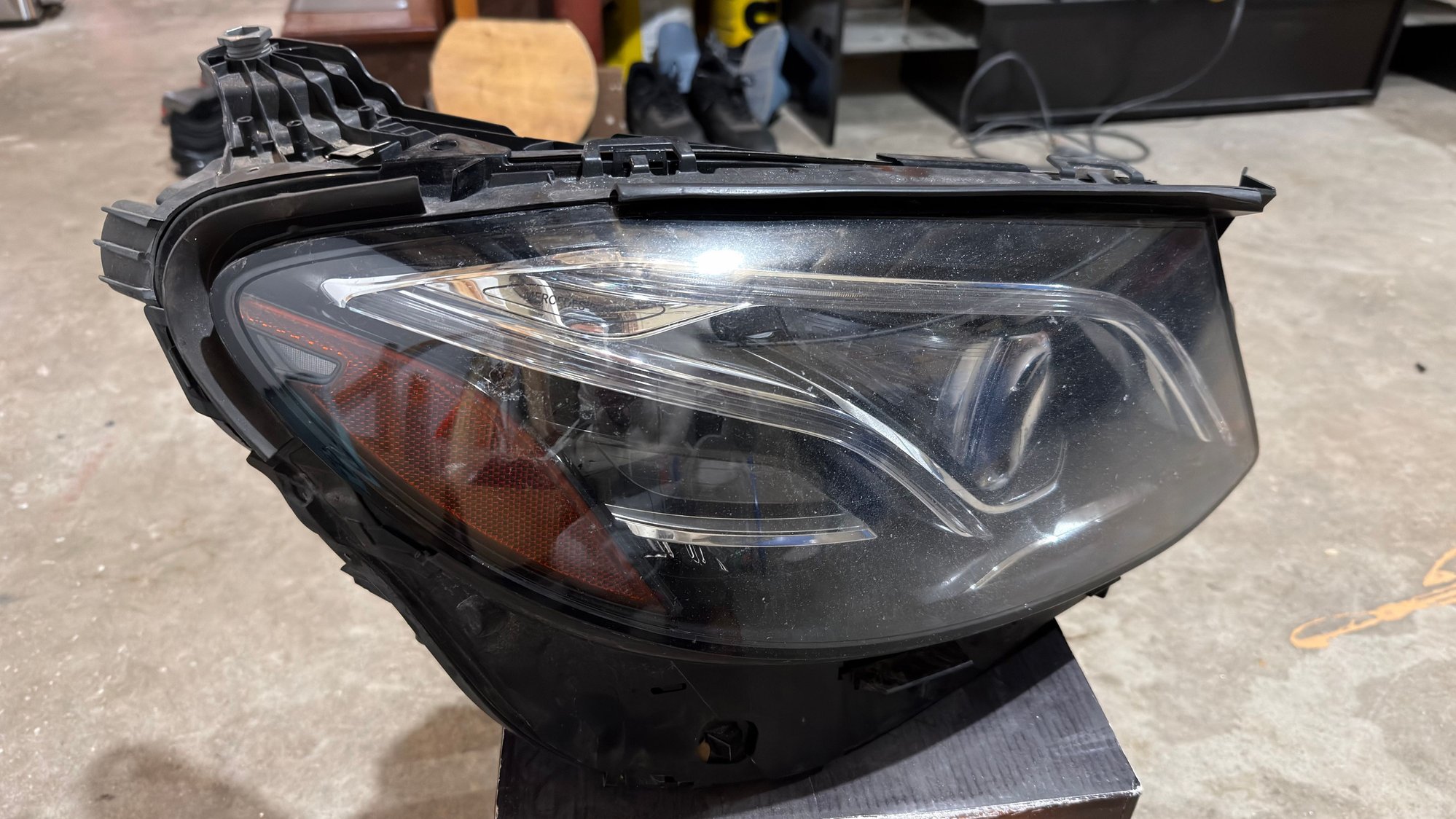

Hi everyone. Hope this finds everyone well and healthy. I’ve been in an accident and unfortunately when I took my bumper off I saw that there was a plastic tab that holds the headlight to the chassis that’s gone broke. Since I am shipping my car to Europe, I thought I’d buy the EU version since they don’t have that stupid amber side marker in the headlights.

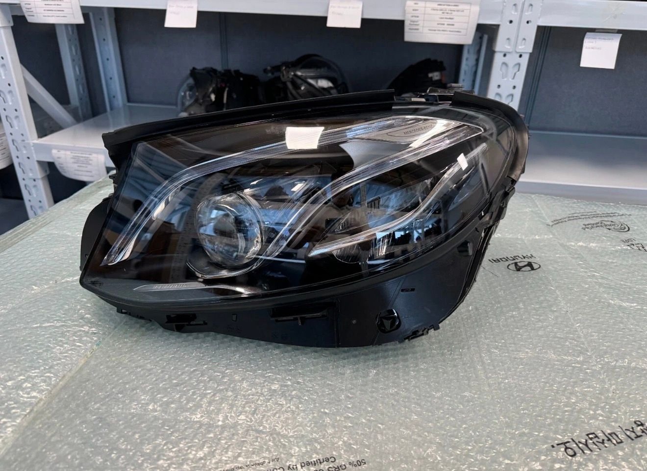

I found a really good deal of both EU headlights at a junk yard in Amsterdam were I plan on buying the units.
I know I’ll need to do some coding as the LED code will need to be swapped and I’ll probably need the headlights calibrated. But my question is will these work at all? I have ILS+ enabled for intelligent Multibeam already in my current modules.
The connectors look the same for the modules as well as the actual headlight connector.

I just got my replacement EU headlights 3 days ago (shipping in Europe is terrible in my opinion) and it took way longer than expected. I've plugged them in and they work (as in light up, turn signals work, highbeams). However, I have an error message on the dash saying my position lights (the amber ones the US uses) are faulty. I'll have to code that out.

I used my old modules from the US headlights. They glow dark blue then turn to white strips. I didn't code anything yet.
I think I only need to program the ECU to tell it to turn off the amber side lights. I think it's just a matter of telling the car to use EU/ROW program instead of US. I'm not too familiar with how any of that works, but I'll have Elebest do the coding when I get some free time, and when he's free to do so.
