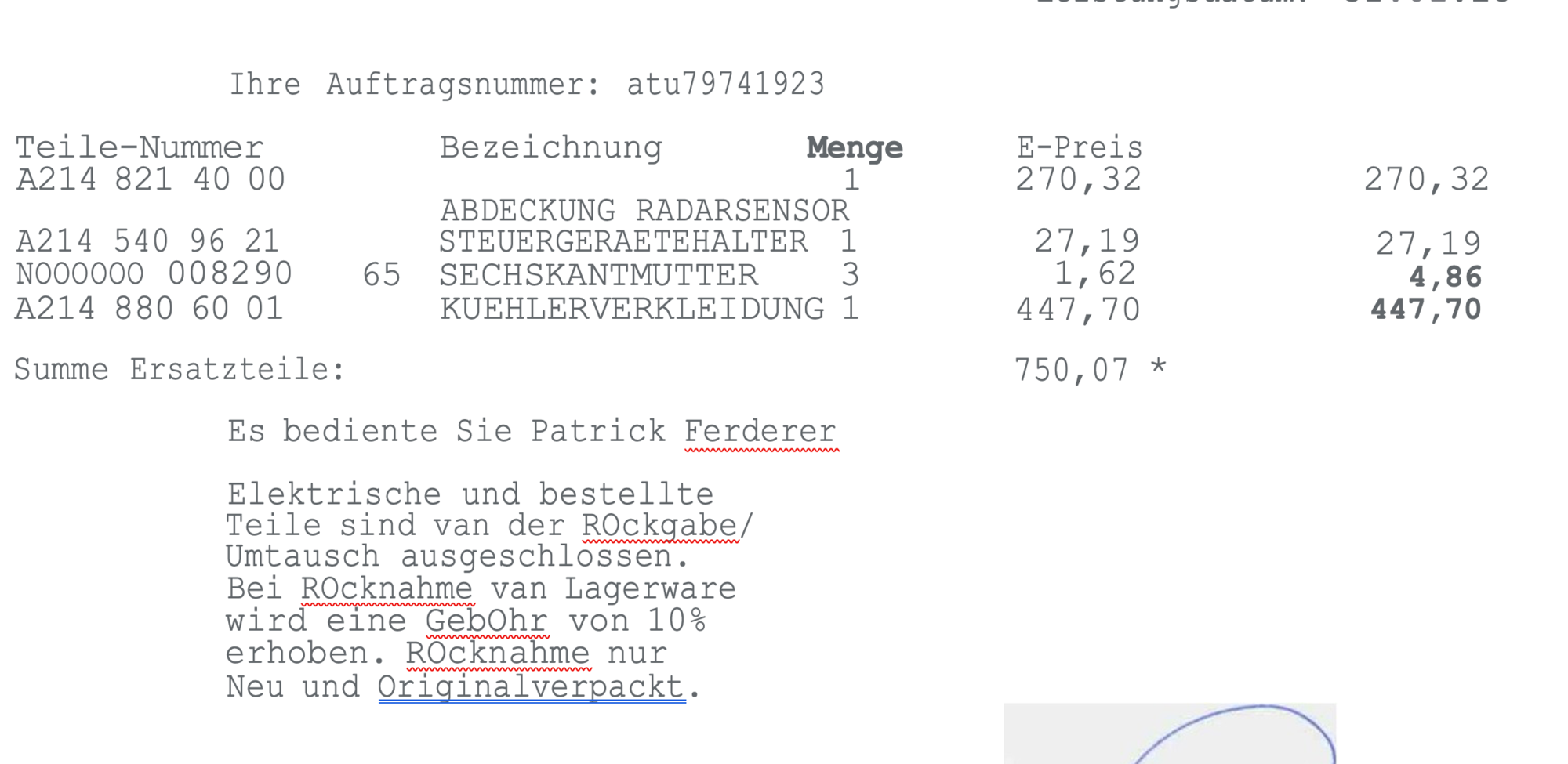

Originally Posted by ccrizk
No Coding required. Direct swap
Thanks for posting the invoice, along with the part#s.
So seems like for the Grille swap, the following part#s are needed (no coding needed, and is a straight swap-in):
A214 821 40 00
A214 540 96 21
A214 880 60 01

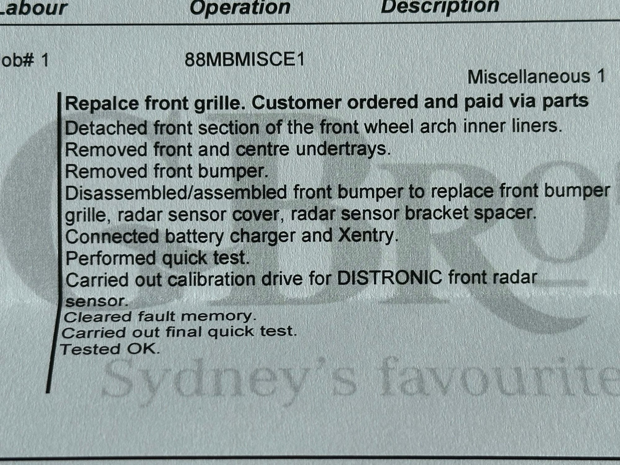

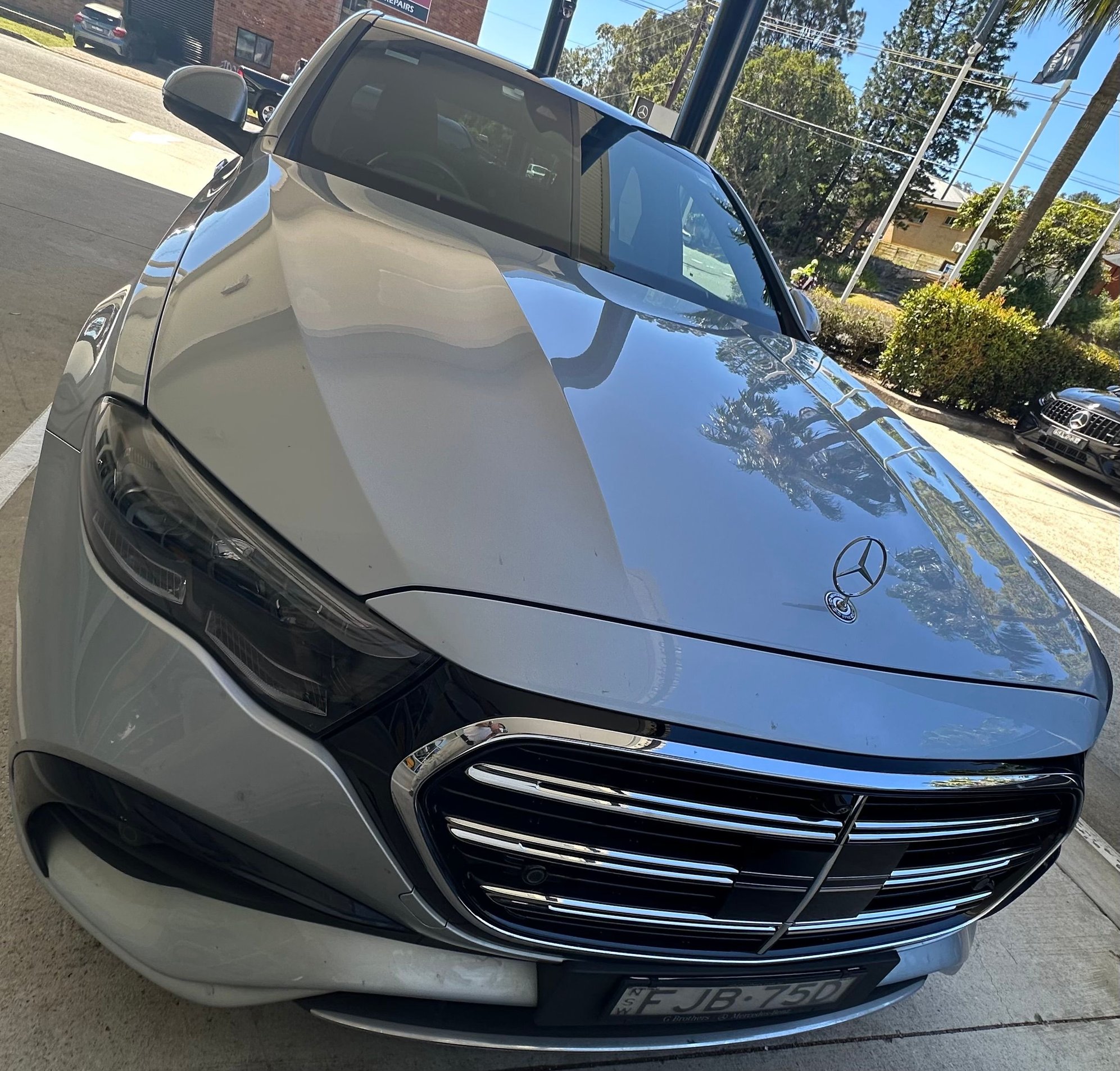

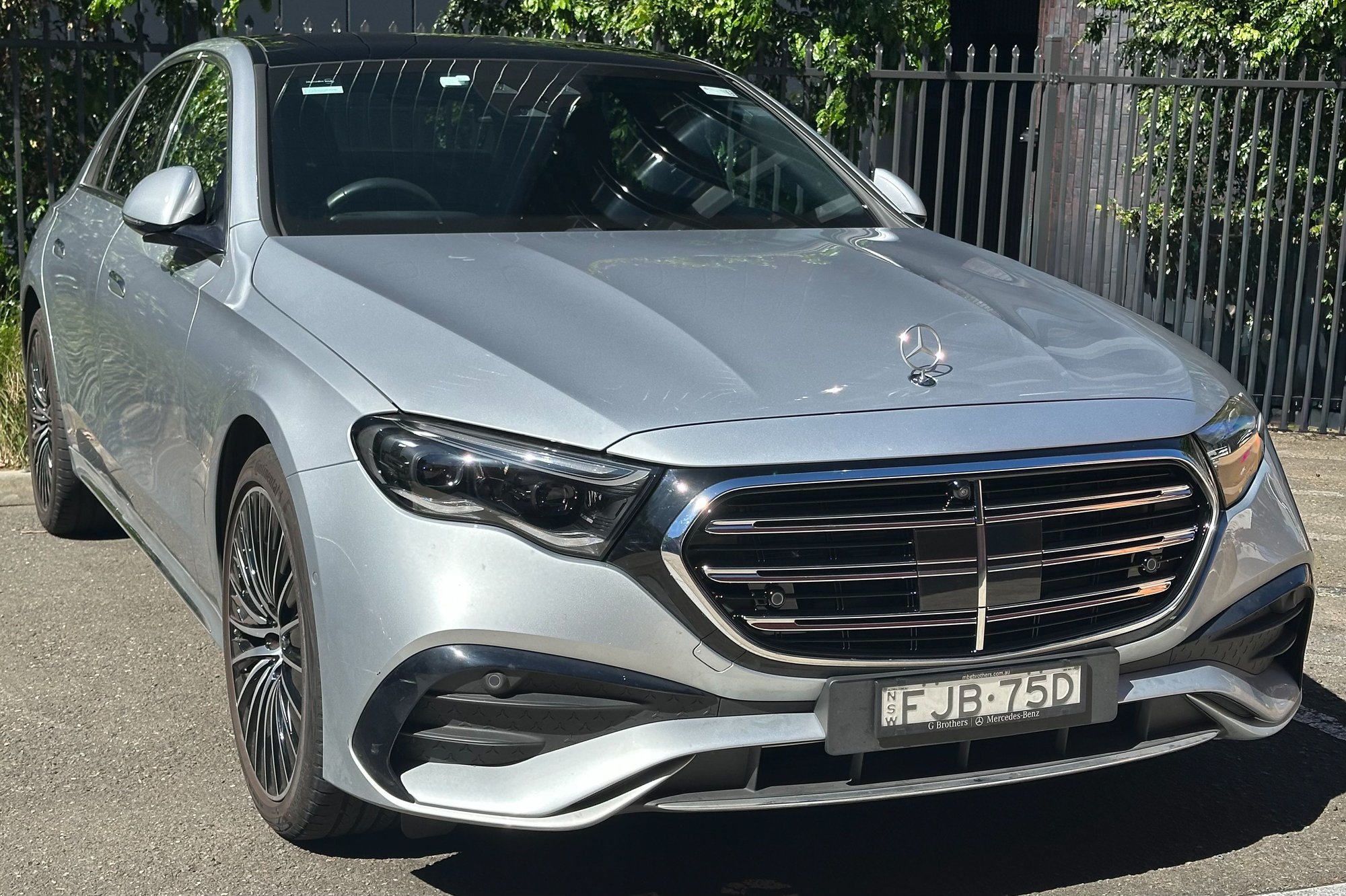

I am from Australia and ordered the grille from my dealer. They were surprised that there was not a block on the order. I reckon it is because the Executive grille is available now for the E200 (oddly, not for the E300!)
They installed the grille for me today. They also said they calibrated the camera and everything work as they should. I have been driving around a bit and seems everything is fine.

The grill swap only caused occasional problems. It was the active parking and remote parking that often didn’t work, which was a deal breaker for me.
I’m going to wait out the warranty period… then I’ll see if I put the grill back
