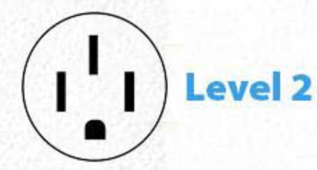

The 3 prong 110v plug is NEMA 5-15 which is a standard 110v plug.
The 220v plug is NEMA 14-50 which is used for Level 2 charging. It is also commonly used for 220v appliances such as dryers, ovens, ...
