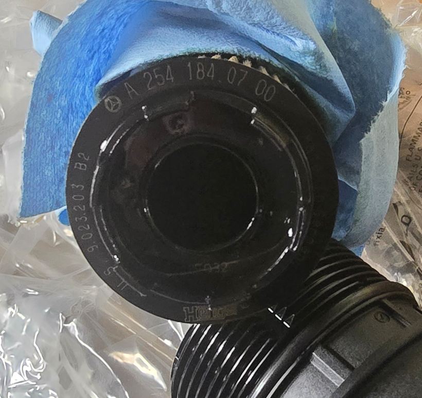

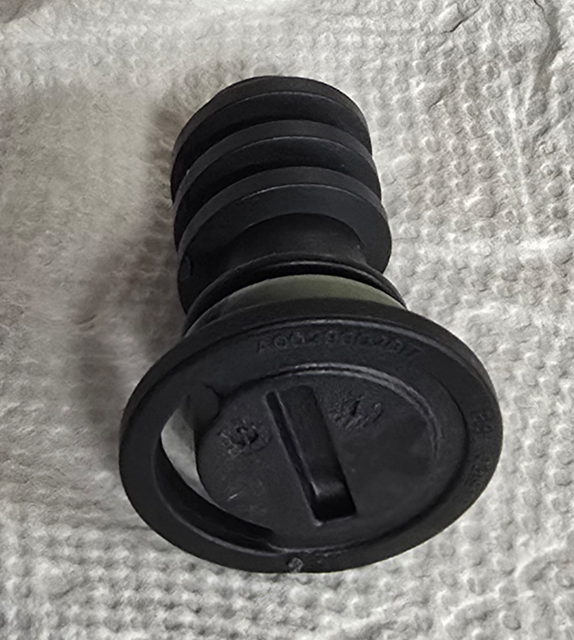

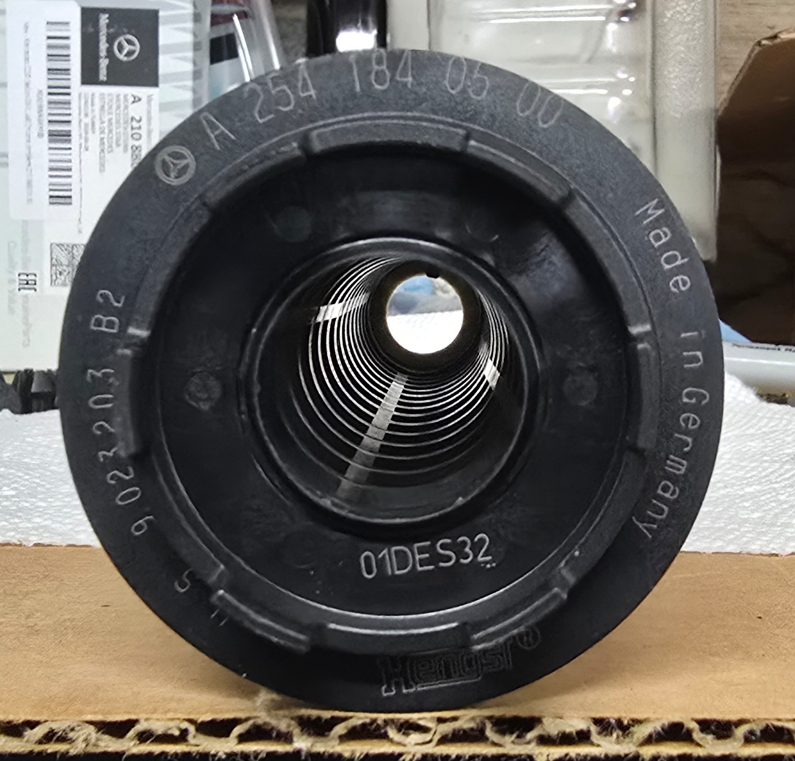

I've changed the oil in my 2025 E450 twice already. The oil I am using is Liqui Moly Top Tec 6600 SAE 0W-20 and can be easily found in the US. I ordered mine on
Amazon Amazon
, but you should be able to find it elsewhere. You can also use Motul 8100 Eco-Clean 0W-20 or Mobile 1 Ultimate X2 0W-20 which are all listed as approved MB Operating Fluids (https://operatingfluids.mercedes-benz.com/sheet/229.71) but I found it easier to find the Liqui Moly. Regarding the oil filter, the PN that came out of my car on the initial oil change was 254-184-07-00 however doing an online search for the M256 engine says 256-184-00-00. My dealership said the PN was 254-184-06-00 which is what I have used twice now and it worked fine. Mercedes-Benz also says you should replace the plastic drain plug however I kept the same one for my initial oil change, but changed it on the second. The original PN that came off the car was 654-997-00-5 but my dealership says the PN is 002-990-20-17. They look identical. Cost for the filter at my dealership was $21 and $17.50 for the drain plug.
Original Oil Filter from factory
New Oil Filter with PN 254-184-05-00 while the box and the order sheet from dealer says 254-184-06-00. I don't know why there is a difference but both the new filters I bought had the same dependency.
The two plugs, top is original factory PN 654-997-00-56 and bottom is new from dealership PN 002-990-20-17. They are identical.
Here is a better look at the new drain plug
A fat screwdriver works okay to remove and install this drain plug but there is a tool they make specifically for this. It's much easier than a screwdriver and there is less chance you will gouge the plug since it's plastic and fits snug into the slot of the drain plug. It's $10 and can be found on
Amazon Amazon
. If you are going to do your own oil changes then it may be worth getting. It short so easy to work in a tight space and the tool gives you plenty of torque to turn the drain plug. The drain plug itself is very loose until the last 1/4 turn where it has a clear catch to ensure it's tight.
One word of advice when draining the oil. Loosen the plug to where oil is coming out but don't take it completely off initially. Let it drain slowly with the plug in place but loose so you can control the flow. Then once it's going very slow you can remove it all the way. If you just remove it completely the oil will come out with such force it will splatter everywhere. I speak from experience here. I was planning on doing a write-up on doing an oil change but haven't taken the time. There are other things to watch out for such as how much oil you remove and how much you put back in while making sure you do not overfill the engine.

Originally Posted by L1Wolf
I've changed the oil in my 2025 E450 twice already. The oil I am using is Liqui Moly Top Tec 6600 SAE 0W-20 and can be easily found in the US. I ordered mine on Amazon, but you should be able to find it elsewhere. You can also use Motul 8100 Eco-Clean 0W-20 or Mobile 1 Ultimate X2 0W-20 which are all listed as approved MB Operating Fluids (here) but I found it easier to find the Liqui Moly. Regarding the oil filter, the PN that came out of my car on the initial oil change was 254-184-07-00 however doing an online search for the M256 engine says 256-184-00-00. My dealership said the PN was 254-184-06-00 which is what I have used twice now and it worked fine. Mercedes-Benz also says you should replace the plastic drain plug however I kept the same one for my initial oil change, but changed it on the second. The original PN that came off the car was 654-997-00-5 but my dealership says the PN is 002-990-20-17. They look identical. Cost for the filter at my dealership was $21 and $17.50 for the drain plug.
A fat screwdriver works okay to remove and install this drain plug but there is a tool they make specifically for this. It's much easier than a screwdriver and there is less chance you will gouge the plug since it's plastic and fits snug into the slot of the drain plug. It's $10 and can be found on Amazon. If you are going to do your own oil changes then it may be worth getting. It short so easy to work in a tight space and the tool gives you plenty of torque to turn the drain plug. The drain plug itself is very loose until the last 1/4 turn where it has a clear catch to ensure it's tight.
Kudos for the great details! My car is hitting 6K miles so will do that soon. Did you reset the engine oil reminder after each change?
