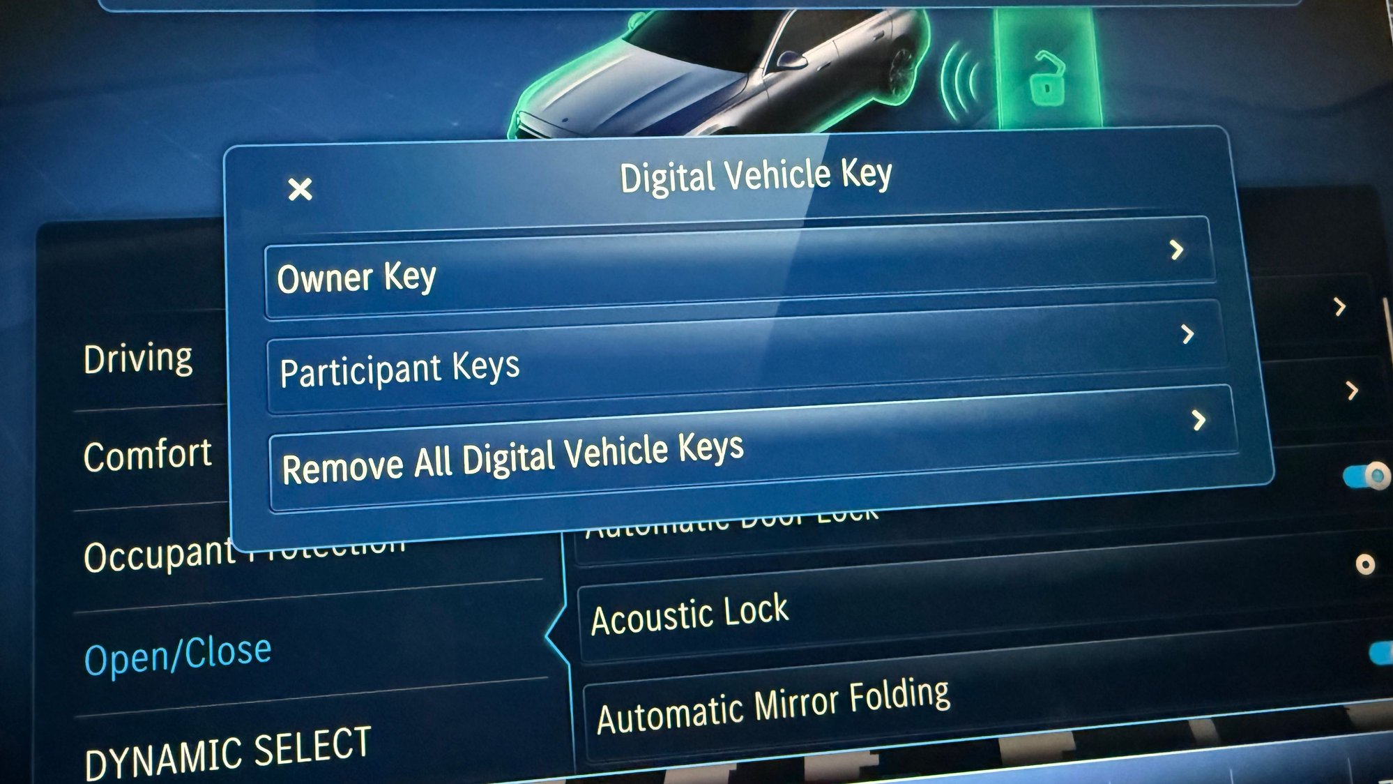

try from your car to delete all digital key and re-initiate the setup there.
I also had similar issues last Oct a couple of days after the iOS 18 update, and it was super frustrating. hope you fix yours soon.
What are these steps?
Old Oct 3, 2025 | 01:24 PM
helmsleyl626's Avatar
Joined: Sep 2025
Posts: 8
W214 E450
From here, the third option.
If you only remove it from your Apple Wallet, it'll still be in the car's system, re: when you check the digital key status from the phone app. It was only after this step that I can re-setup my digital key by initiating the "pairing mode" from the MB app
