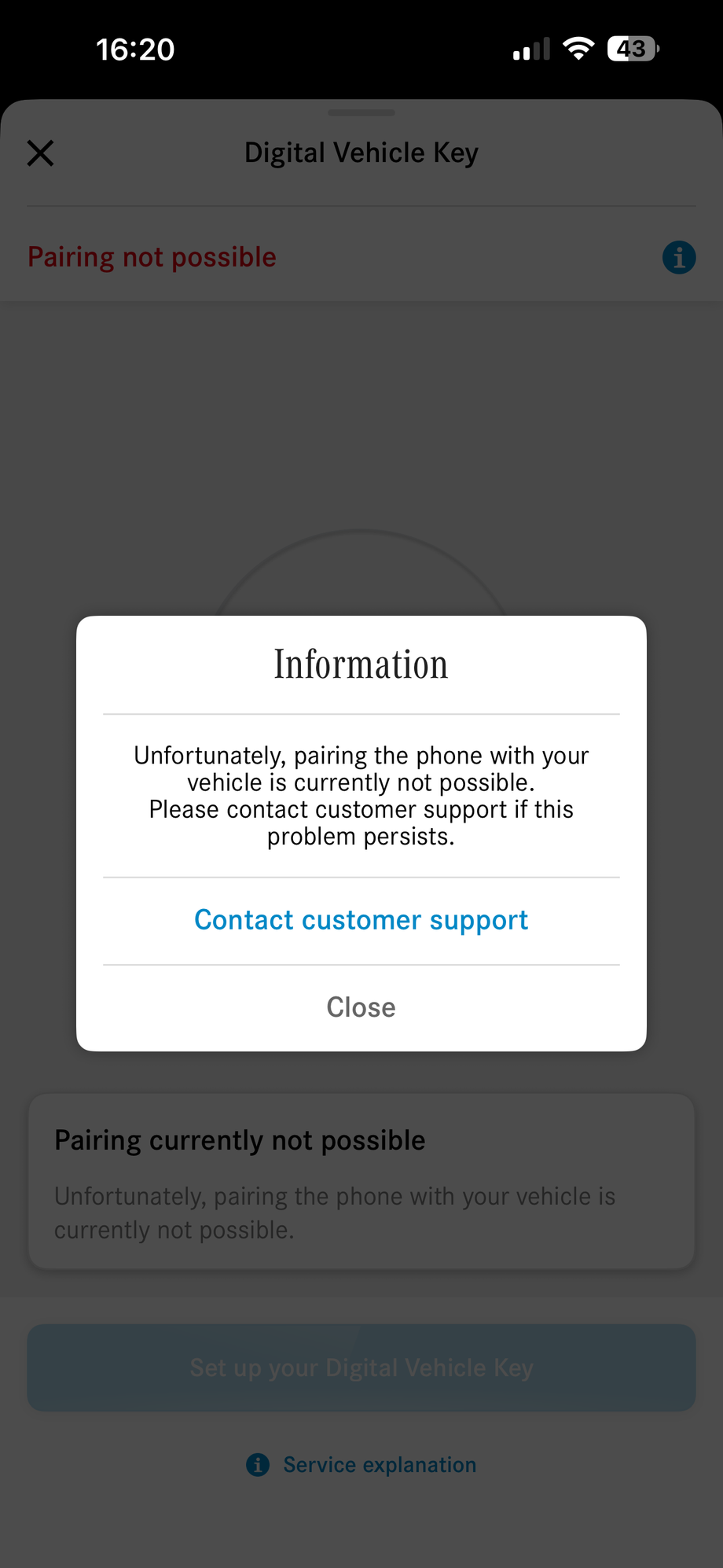

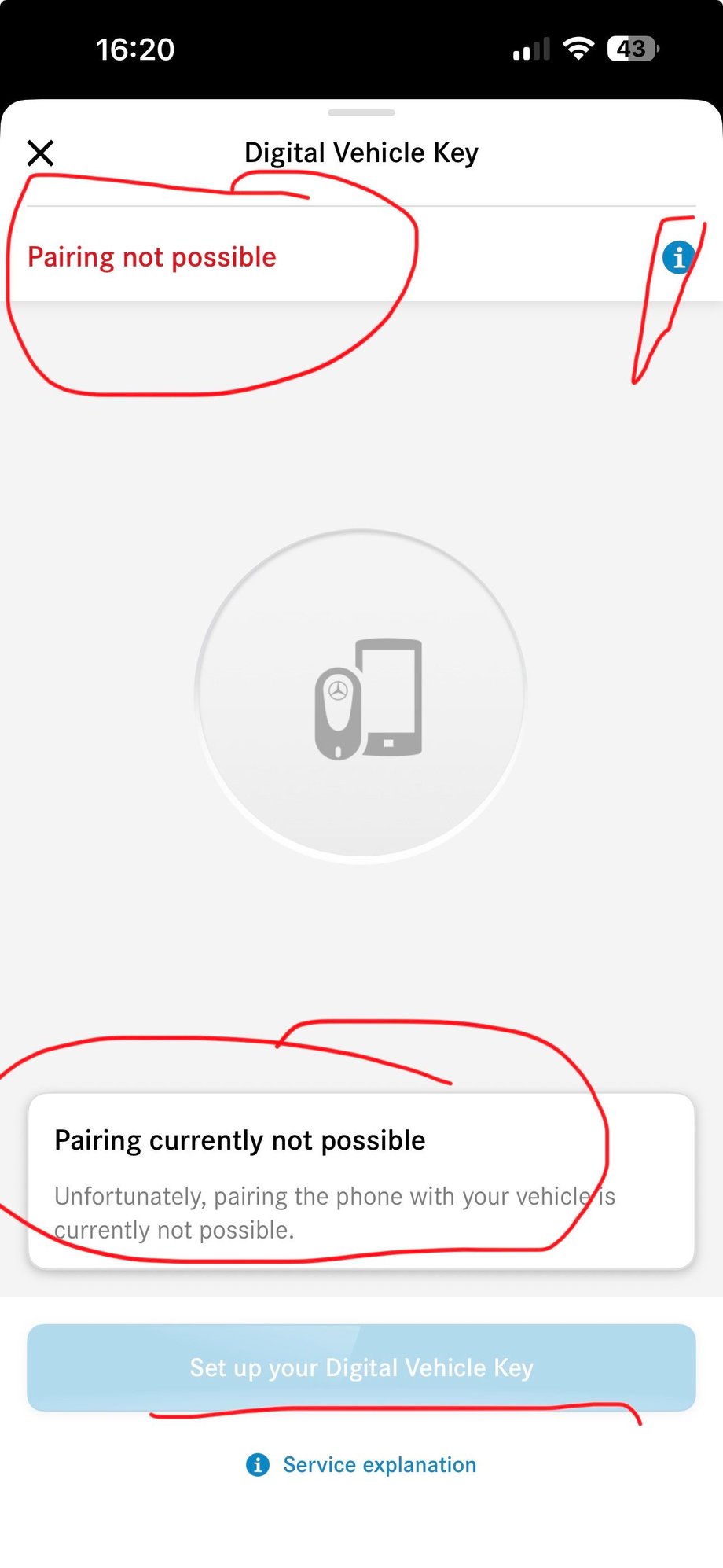

Originally Posted by Mukul Soni
I’m getting this error in Mercedes Me app in phone. Contacted to dealership but they could not able to solve it and asked me to contact customer support. If someone know about it or know solution for this, please help. Thank you
I work at a dealership and came across this message during a delivery. I resolved by enabling internet access for the apple wallet. Hope this helps This was on a 2026 450 E-class
