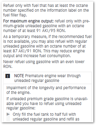

Originally Posted by JTK44
Inadequate fuel: Once you determine, without any basis, that regular is inadequate, then of course you will run premium. What you are doing is assuming your conclusion.
I prefer to keep an open mind and until someone demonstrates to me, and "my dealer heard" I will not conclude that regular is inadequate fuel. If you read your manual it does not say premium is required but only premium is recommended.
Like you: "I could give a **** less what you run inyour car. You can **** in your tank if you want to"
Can you provide the specific language in your manual and your fuel door where it indicates or implies that premium (91 octane or higher) is just a recommendation and not a requirement? Mine leaves little room for interpretation on the fuel door saying "MINIMUM OCTANE RATING 91". It's bold and in all capital letters making it seem extra important. The manual then says that you should "Only refuel with fuel that has at least the octane number specified on the information label in the fuel filler flap. Otherwise, engine output may be reduced and fuel consumption may increase." I can see how this statement alone may make you think that the only consequence to not following this is lower fuel efficiency. Further in the manual, it states to use at least the octane number specified in the fuel filler flap and that not doing so will cause "Premature engine wear through unleaded regular gasoline" and "Impairment of the longevity and performance of the engine". I looked at the 2019 E-Class manual and it has similar but not identical language. It also states to only refuel with the minimum octane stated in the fuel filler flap and goes to say "Unleaded regular gasoline can cause the engine to wear more quickly and impair longevity and performance". This doesn't seem like they are saying that it's just a recommendation as you indicate above. Can you elaborate as to why you think this is just a recommendation and not saying you should only use premium?
My fuel door
The 2024 E-Class manual
The 2019 E-Class manual
My fuel door
I wonder why he didn’t jump in for an immediate rebuttal to this post like he does on all the others?
