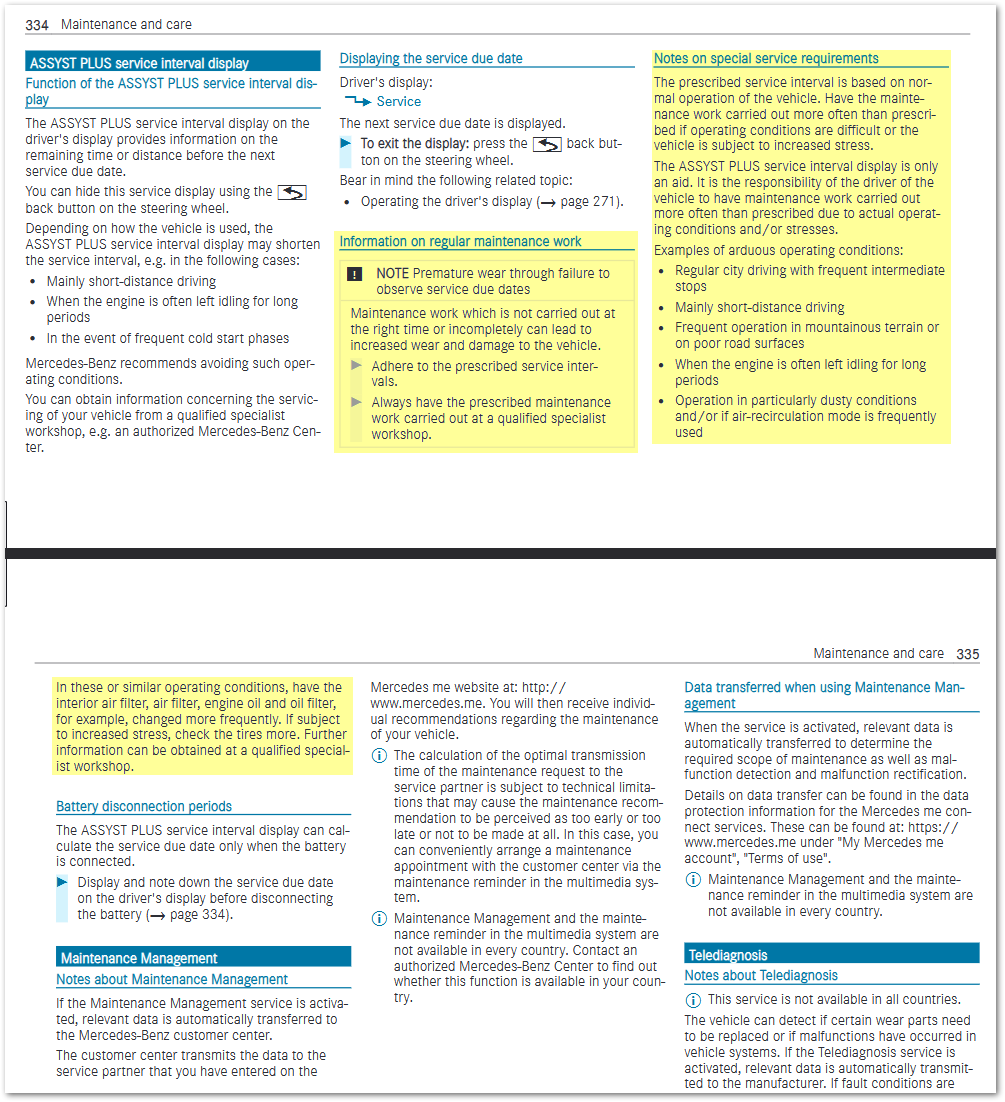

Oil change interval and premium gas in a turbo
There are lots of threads that become hijacked and devolve into arguments on oil change intervals and the use of low octane gas in a car that specifies high octane of 91 or better. I figured, why not start one where that is the topic.
I change my oil at a maximum every 5K miles and only use 93 octane fuel. Not because I enjoy spending more money, but because I believe it's better for the longevity of the engine. My thought is that the money saved in the short term will be saved in the long term with not having expensive repairs. I also prefer to keep my cars a long time. For those that lease or trade their car in after 2-3 years and prefer to abuse their engine before getting rid of it saying it's no longer their problem. Well, I have nothing to say to you.
I'll admit that I have no expert knowledge which is why tend to rely on other experts who have no skin in the game other than to help their fellow man. Here is one who explains the reasons behind shorter oil change cycles and use of premium gas in a high compression turbo engine. He is certainly not the only one, but a good explanation. You have to watch to the end for the octane discussion. He also has a lot of good advice on how to properly care for your turbo charged engine. I know this will not convince many or any of the people that save money but using low octane and change oil every 10K or more, but it explains why I and others do not do these things

Actually, it's you who are assuming. I simply made statements regarding people who abuse their car with the mindset that when the car is 3 years old, they will get rid of it and any long term damage they may have caused will not be their problem. I never said that following the manufacturers guidelines is abuse. All I am saying is that there are reasons the the manufacturers guidelines are not in a long term owners best interest and the video covers some of them.
What I find curious is that while you are so keen on saying follow the manufacturers oil change interval you completely ignore the fuel guidelines on minimum octane. All because you cannot notice an issue immediately or even days later. In 10 years and 120K miles when the piston cracks or the turbo fails, nobody will know that a poor maintenance schedule or low octane fuel may have contributed to that failure.
Anecdotal evidence you sited has no usefulness in this discussion. There are exceptions and edge cases to nearly everything. At the end of the day nobody is right or wrong here. We are all basing our decisions on what we perceive to be of value to us. I place value in taking care of the things I have in an attempt to make them last a long time. You had asked me in another thread why I believe the oil should be changed more often. Two reasons.
First is that I do not trust the manufacturers are acting in our best interest. They are proffit driven and will do anything to maximize that. Having long 10K oil change intervals helps them in that customers perceive long change intervals to mean less money on maintenance. It also helps with regulations. The 10K interval is designed to get the car out of warranty. Once it's out, it's beneficial to the manufacturer for that engine to fail. They know most people lease their cars and that 3+ year old car will now be in the used car market on its second or third owner. The sooner that car is dead, the better. The more maintenance that car needs the better. The original owner will be in their next new car oblivious to the long term issues of their prior car.
Second, I simply do not believe oil can protect an engine effectively beyond 5K in normal conditions and less in severe conditions. By the way, severe conditions include low mileage short trip cars, but many seem to think they can go further on oil changes because their car is low mileage. This belief is not just something I've fabricated. I have talked with plenty of top mechanics I trust who tell me what they believe based on the many years of building and rebuilding engines. Of course, there are plenty of counter opinions that say go 10K or even longer and at some point you have to make a choice on which to believe. I believe the people I trust who know much more about engines and lubrication than I do.

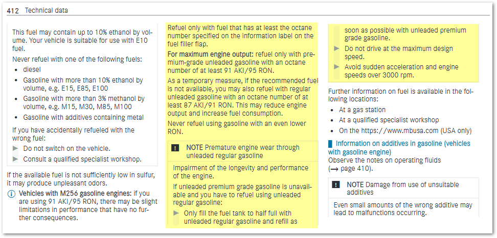

On to octane. This too, the manufacturer is focused on their own interests. They know that with the oil change interval there is little risk to the engine in the initial warranty period. With octane, it's more about fuel efficiency and meeting regulations. Also, better fuel efficiency gives the appearance of being less expensive to operate since you need less fuel. Nobody really considers the cost of that fuel since it fluctuates. They only focus on miles per gallon rather miles per dollar. But this is where the manufacturers own interests align with that of the long term owner. The manufacturer wants you to use high octane to improve efficiency while the owner should use it more to reduce premature wear on the engine and reduce the chances for costly repairs in the future. The manufacturer has the added benefit of if your engine does fail while in warranty and you have not been using the recommended fuel, they can deny your warranty claim. Win win for them.

You say you trust the engineers but you have said time and time that you use 87 octane even though the same engineers say not to. In fact, they go so far as to say that if you must use 87 that you do so only to get you to the next station to fill with 91 or better. It literally states in the manual that using lower octane will lead to premature engine wear and impairment of the longevity and performance of the engine. Here it is in the manual.

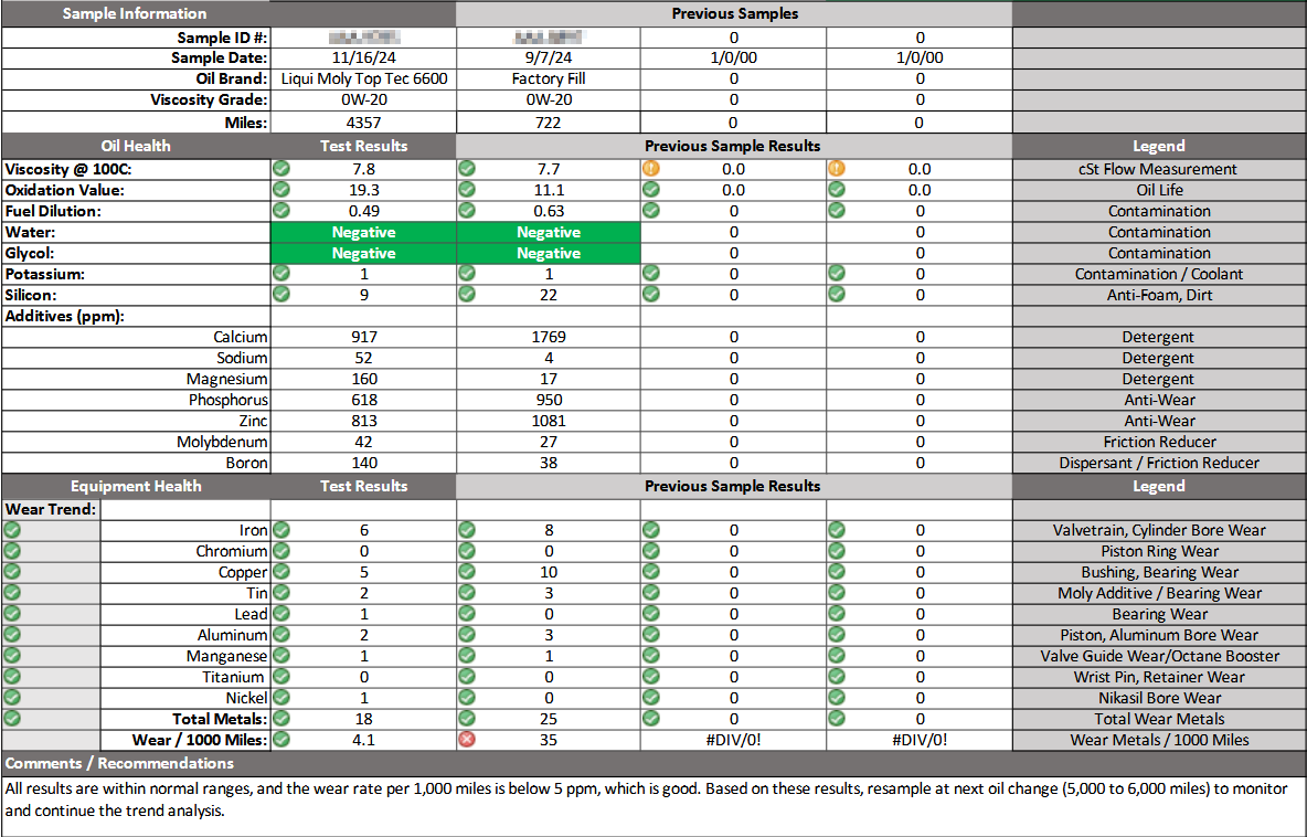

Turbos fry oil a lot faster. I have experience reviewing peoples used oil analysis. It really depends on your average drive cycle how much time you spend in traffic and idling because it's how much heat you put into it and how many times you heat up the oil per day. You can have far worse oil at 5k than at 10k for some people.
Oils a weird topic where people get way too attached to what they do and what they saw once whereas people in the service industry almost never believe what they see and rely on broad data from multiple sources. I recommend an interval of 7500 just because of the sheer amount of used oil I see. 10k is fine though it will protect for longer than that if it needs to in a lot of cases.
However theres only one way to know if your interval with your driving habits works for you, there isn't a set mileage. Used oil analysis. My referral numbers included in the link so itll support me/the forum.
https://www.amsoil.com/p/oil-analyze...it/?zo=7236674

Great point and that's exactly what I rely on. Being that the car is new, it's hard to say what the change interval is so I decided to do it more often. Here are the results of mine. I'll likely stay on a 5K change interval unless the oil analysis says to do it more often.

It is false economy to put 87 Octane, into a car that can readily use 91+ octane, due to the engine's compression ratio.
Yes, the car will not only make less power, but the lower power generation is present throughout the rev band.
So to be at a given speed (or to accelerate to a set speed level), you'd need a certain power number, and with lower octane fuel, you will need to be at a proportionately higher RPM, to be at that targeted power number. So you are in effect consuming more fuel (via being at a proportionately higher RPM), than you would have, by running higher octane.
