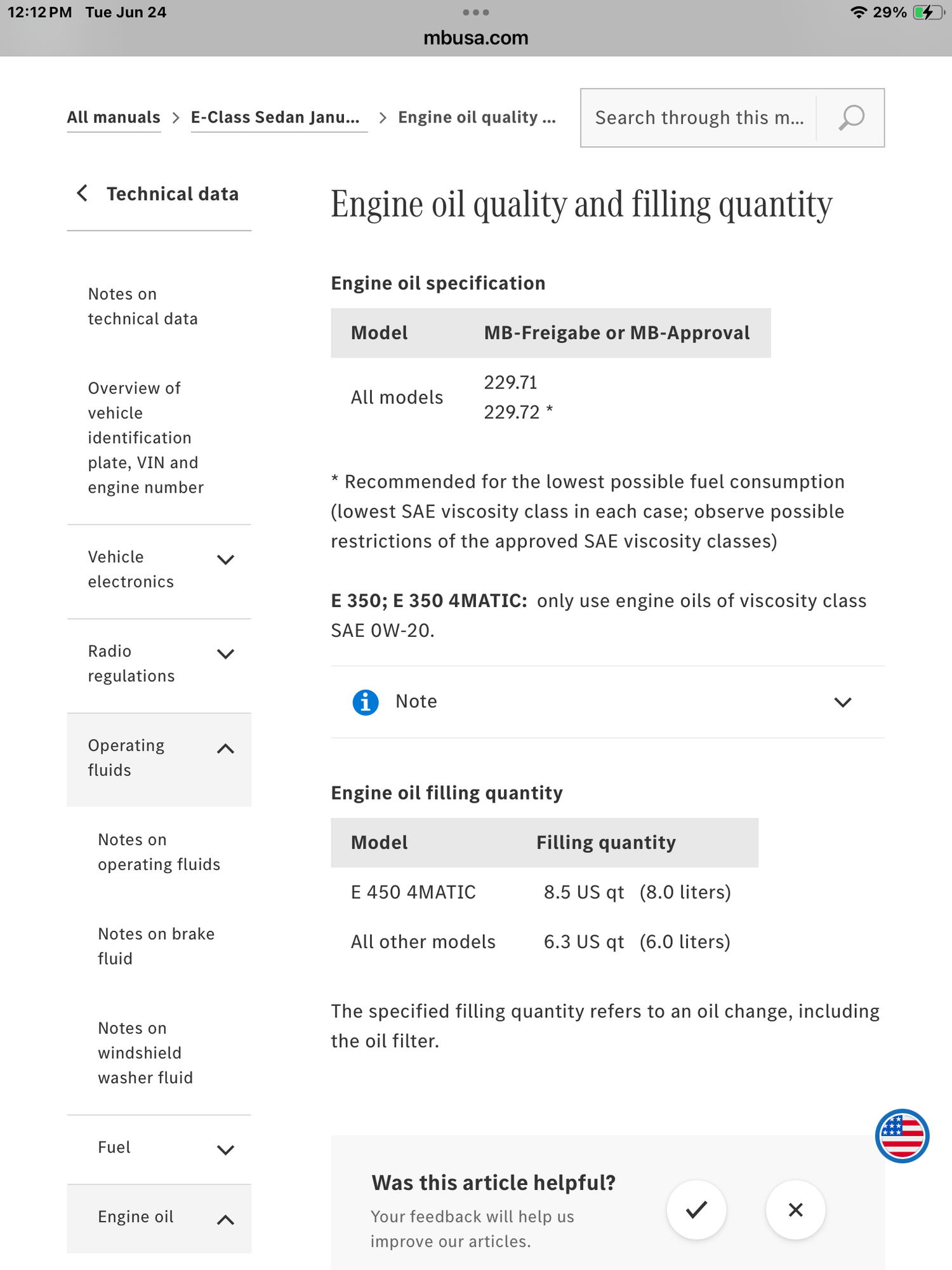

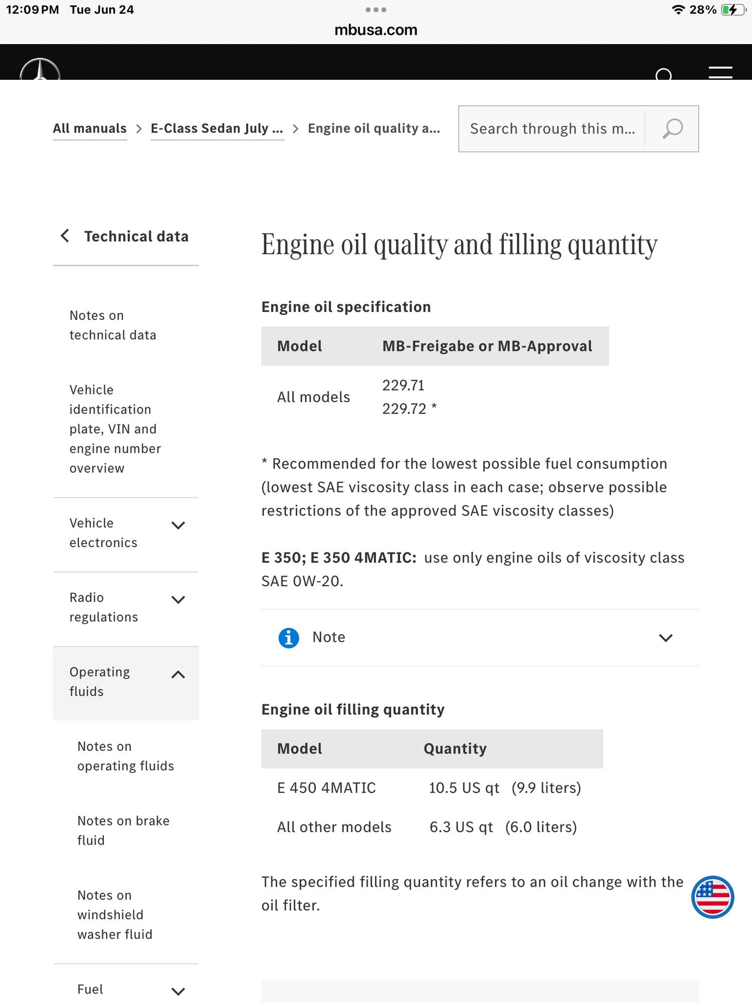

It's even more interesting that the online owner's manual incorrectly specifies 229.71 and 229.72 for the E53 Hybrid. Thankfully, the workshop menu in the car "knows" the correct oil grade for the E53. I have been corresponding with MBUSA since 7-May-2025 trying to get them to acknowledge the mistake in the manual. MBUSA claims they understand the importance of having the correct information for my 2025 E53 in the manual. Apparently its internal bureaucracy prevents it from correcting the error in a timely manner. I wonder how many oil changes have been done with the wrong oil.
https://www.mbusa.com/en/owners/manu...s-amg-vehicles
Creen from E53 Workshop Menu.
Screen from E53 Workshop Menu.
Another interesting thing is if I go to the online manual in the M Me app, if I choose the manufacture date of July 2024 (which is the timeframe for my build), it states oil fill quantity of 10.5 qts. If I choose the date of January 2025, it states 8.5 qts. My physical owners manual also states 10.5 quarts. What changed? If it’s supposed to only hold 8 quarts, how many people have dumped 10 quarts in their engine?

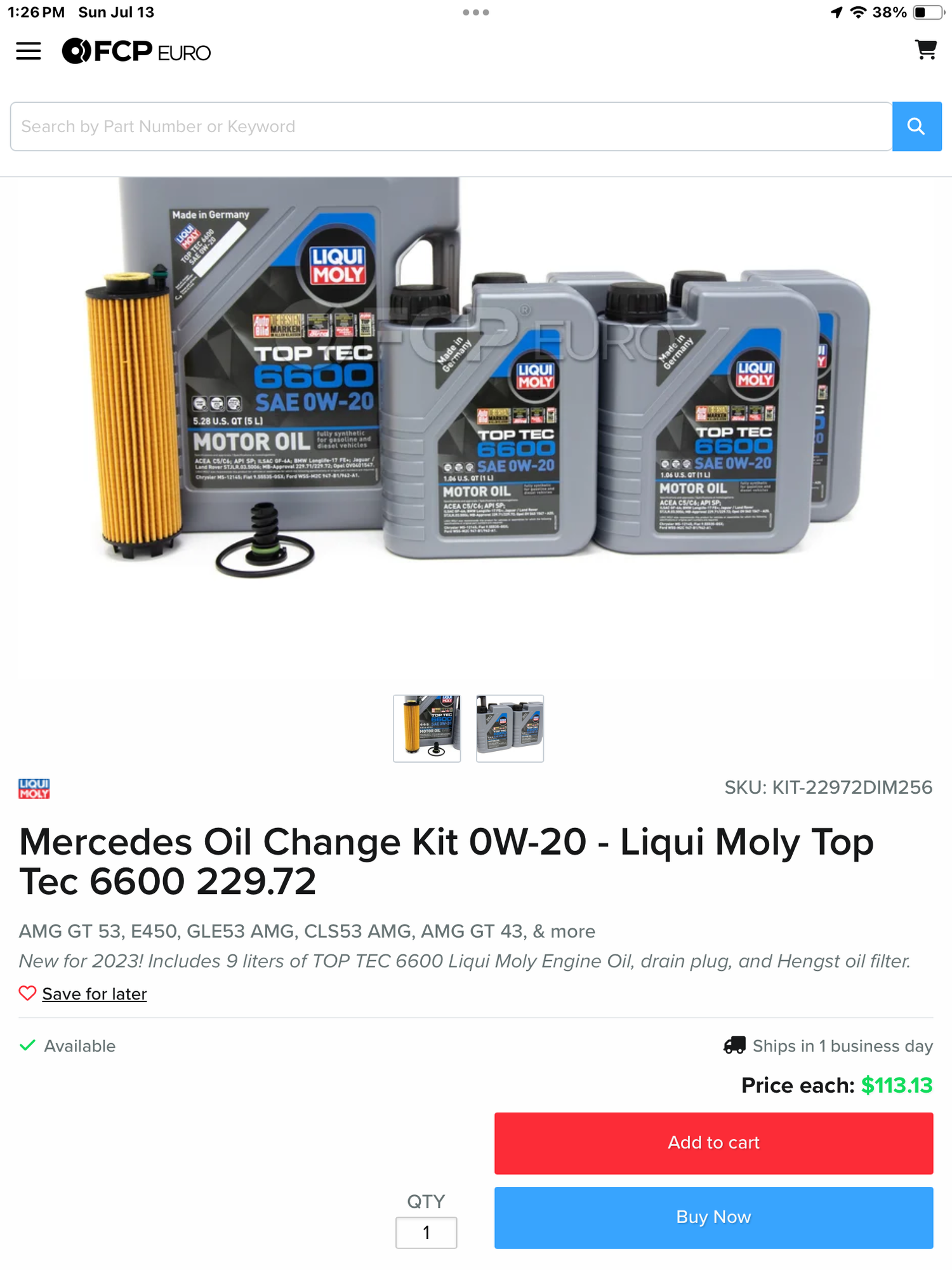

I’ve found this from FCPEuro which is what I’ll probably do when it comes time to service my E450.
