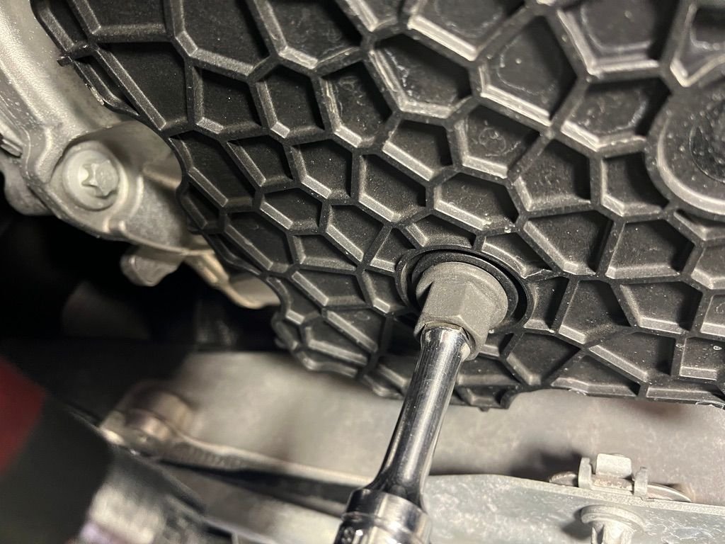

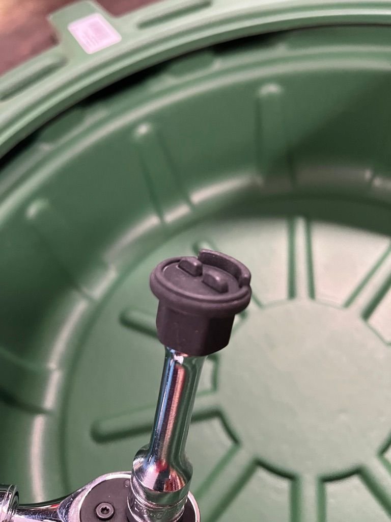

Oil drain plug is near the rear edge of the "oil pan". Very little oil, if any, remains in the engine after the drain plug is removed even when the front axle is on ramps. I decided to use the adapter to minimize any damage to the drain plug in case a source for replacement drain plug O-rings is identified. I measured 8 quarts of drained oil using the markings on empty 5-quart Mobil 1 oil containers. Factory specified capacity is 7.3 liters or 7 quarts and 23 ounces.
Location of E53 oil drain plug.
Adapter for removing/installing plastic drain plug.

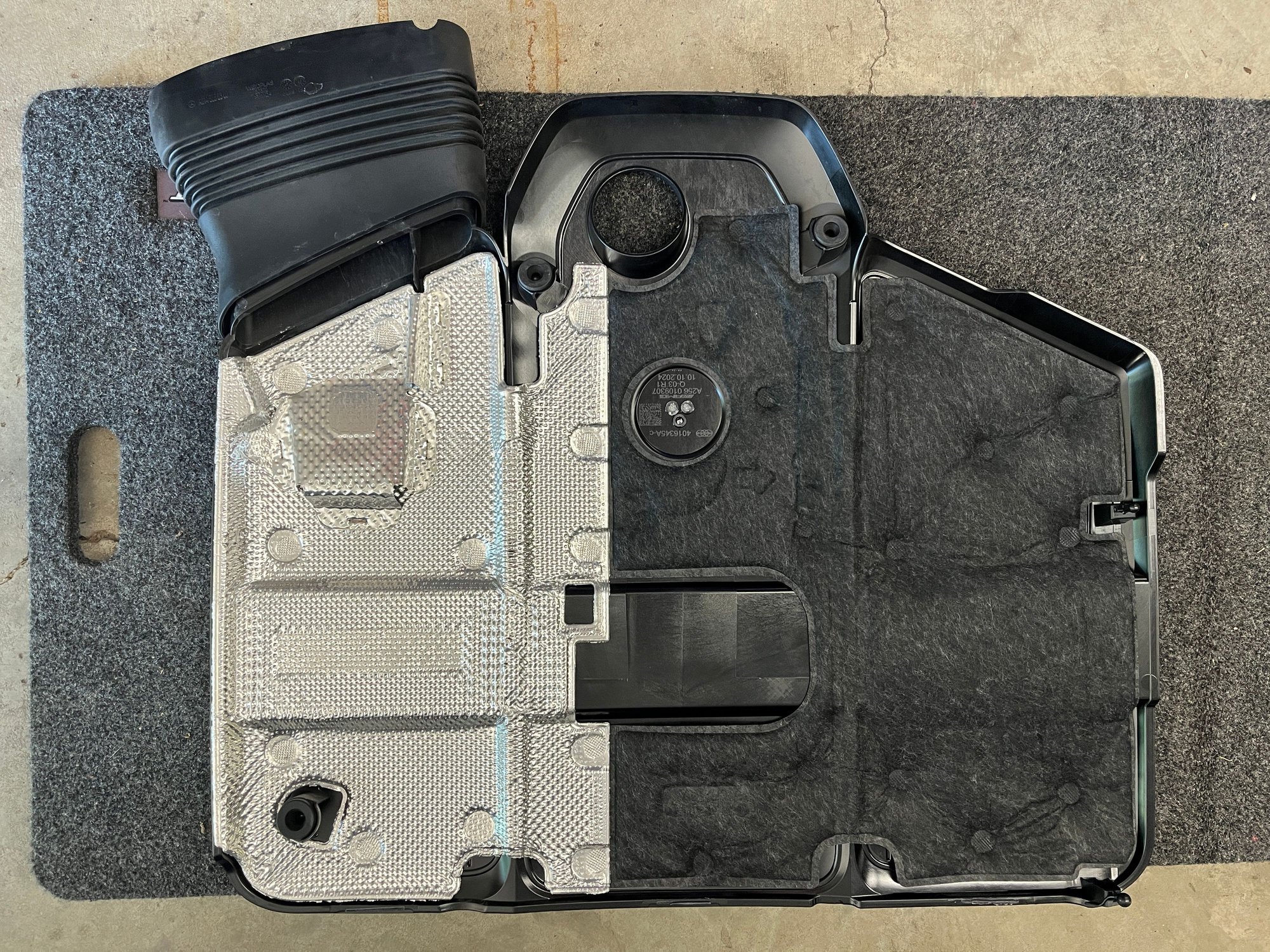

Bottom side of engine cover showing thee ball sockets and two ball posts that secure cover to top of engine. The rubber air duct directing cooling air over the turbocharger is a little difficult to remove and install on the inlet on the front right side of the engine compartment.

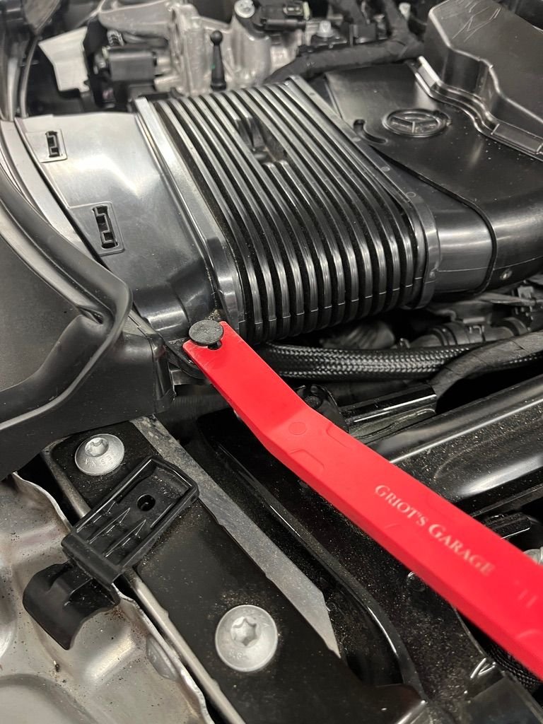

Air intake duct is held in place with two plastic push pins at front edge and two integral "latches" at the rear edge. Release the outer latch first and then swing the front end of the duct towards the engine to release the inner latch.
Push pin are front edge of air intake duct.
Push pin at front edge of air intake duct.
Two integral clips at rear edge of air intake duct.

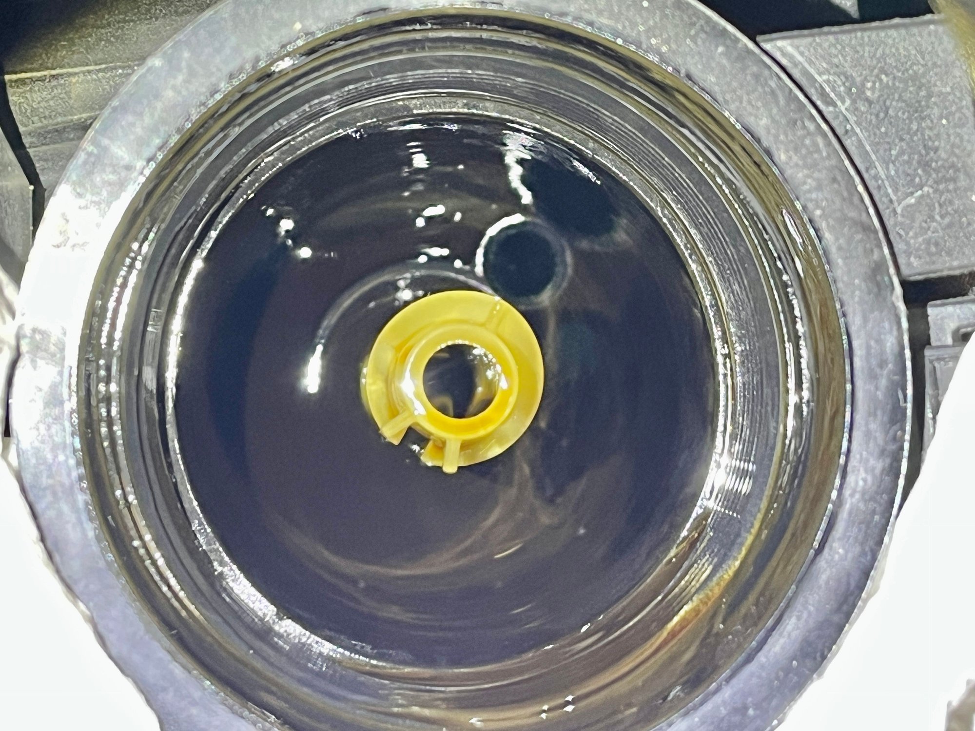

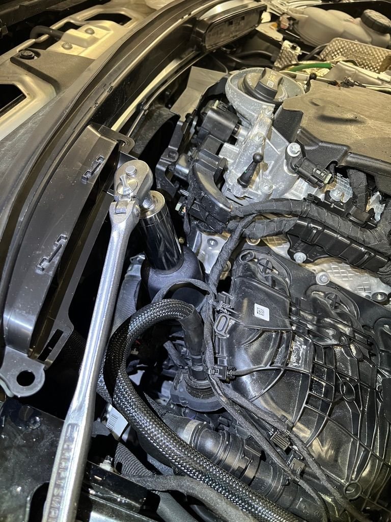

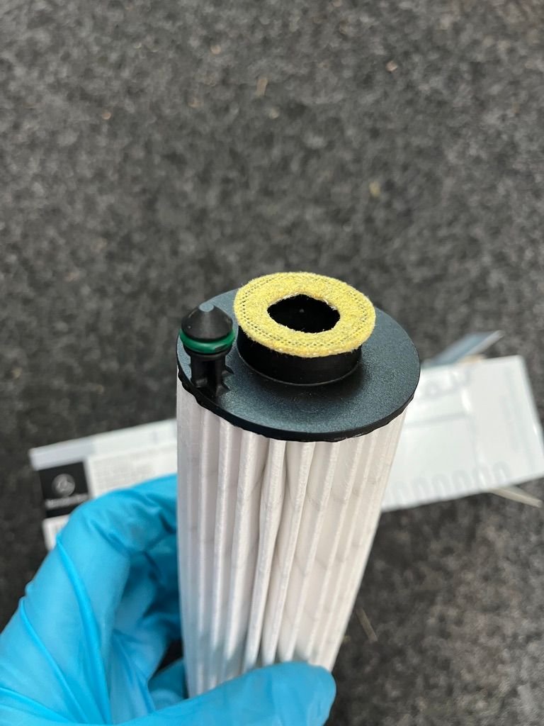

The oil filter cap can be removed using a 1-1/16" or 27mm socket. Quite a bit of force is required to remove the used filter from the cap. I used a paint can lid removal tool to help remove the O-ring from the cap. Insert a new filter into the housing aligning the post with the small hole in the housing. Install a new O-ring on the cap and torque it down to 25 Nm with a small torque wrench.
Removing oil filter cap.

Hole in bottom of oil filter housing.
Insert this end of filter aligning post with hole in filter. Then in stall cap.

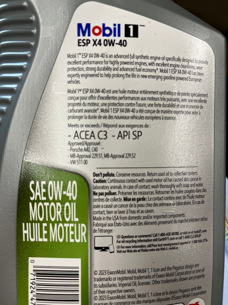

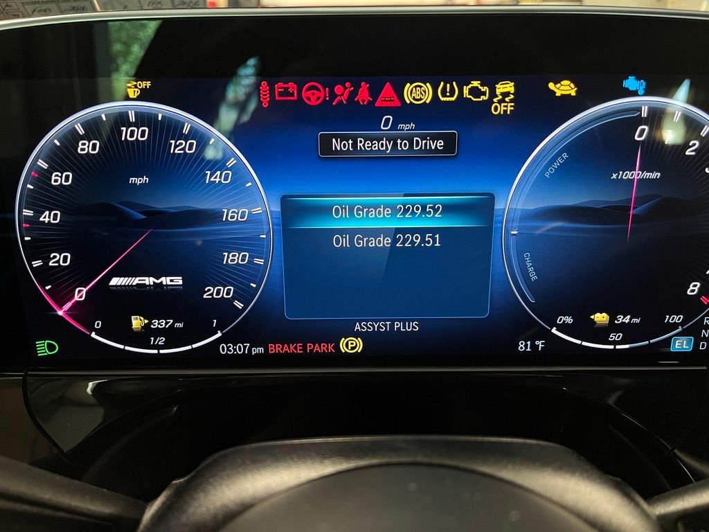

When resetting the service meter you are prompted for the oil grade used. Mobil 1 ESP X4 0W-40 meets 229.51 and 229.52 specifications, but I chose 229.52. This is the most authoritative reference I have seen for the E53 oil grade.
Edit: I checked the current online manual for the E53 and it still indicates the incorrect oil grade (229.71/229.72) and capacity (6.0 liters) as of 21-Jun-2025. MB needs to clean house in the department responsible for owner's manuals.
https://www.mbusa.com/en/owners/manu...s-amg-vehicles
Indicating oil grade in Workshop menu.
Mobil 1 ESP X4 0W-40 container label.

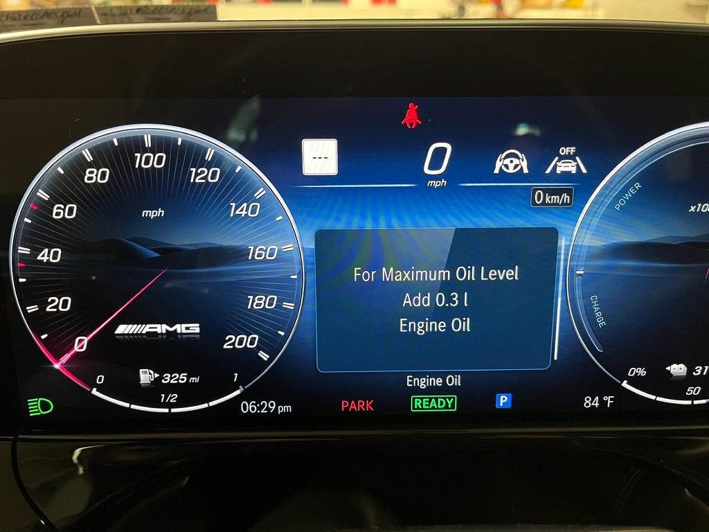

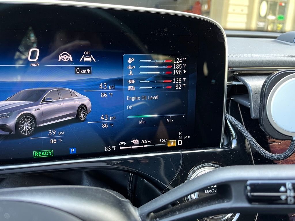

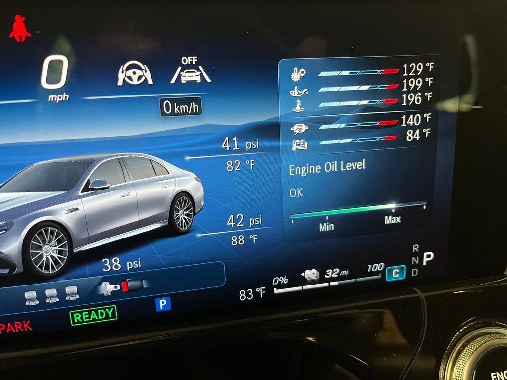

The oil level was at the maximum mark in the Service display of the cockpit screen before I did the oil change. Oil capacity is supposedly 7.3 liters (7 quarts and 23 ounces). I drained a total of 8 quarts of oil from the engine. I refilled the engine with about 7 quarts 19 ounces and took the car for about a 2-mile run. I checked the oil level in the Workshop screen and was prompted to add 0.3 liters of oil to bring it up to the maximum level. I added about 9 ounces of oil (4 ounces remaining in 8th quart container) and the Service display now reads filled to maximum level. Strictly speaking the oil should be weighed in order to accurately measure the oil quantity. It's entirely possible that 7.71 quarts (7.3 liters) of oil at engine temperature could appear to be 8 quarts of oil.
Service display when Workshop screen prompted me to add 0.3 liters.
Checking oil in Workshop screen.
Service display after adding 9 ounces of oil.

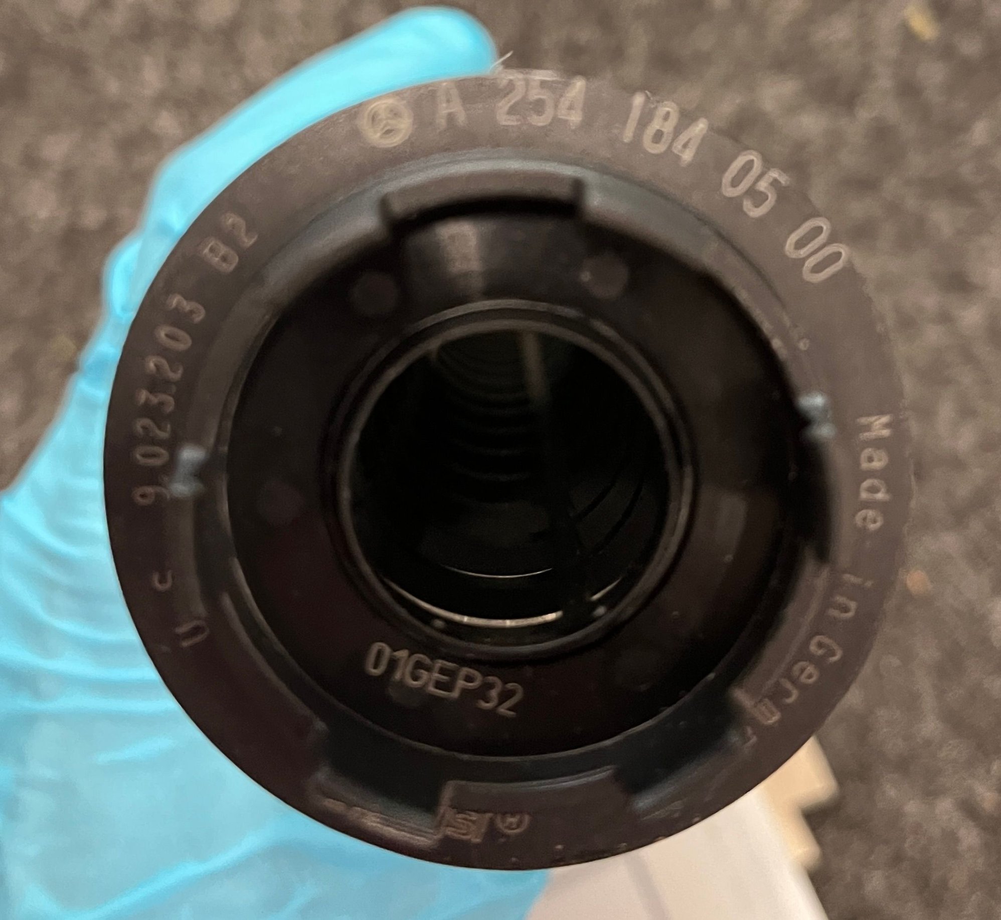

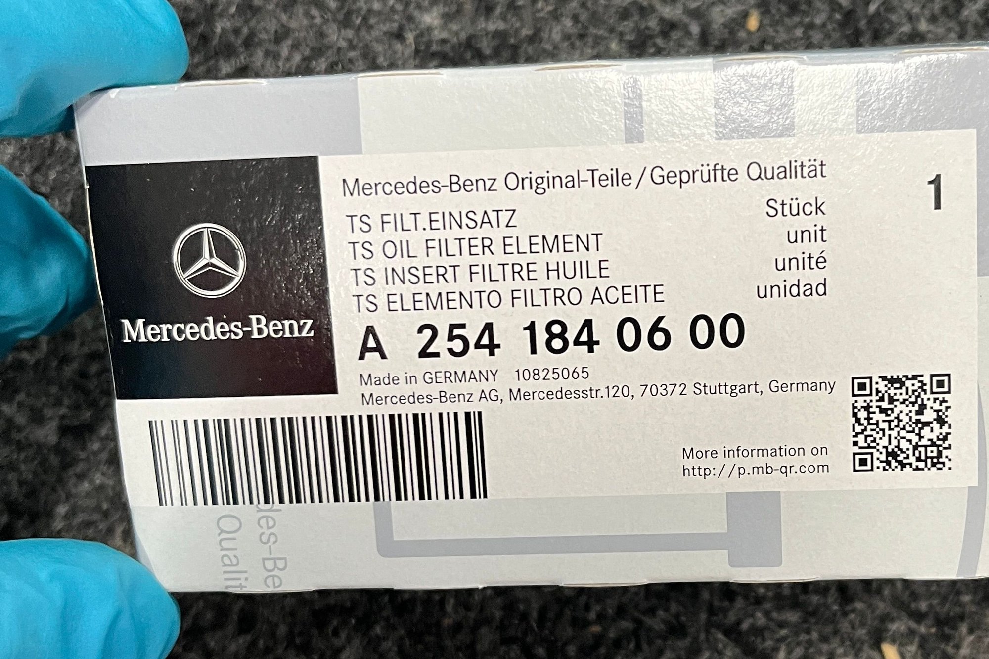

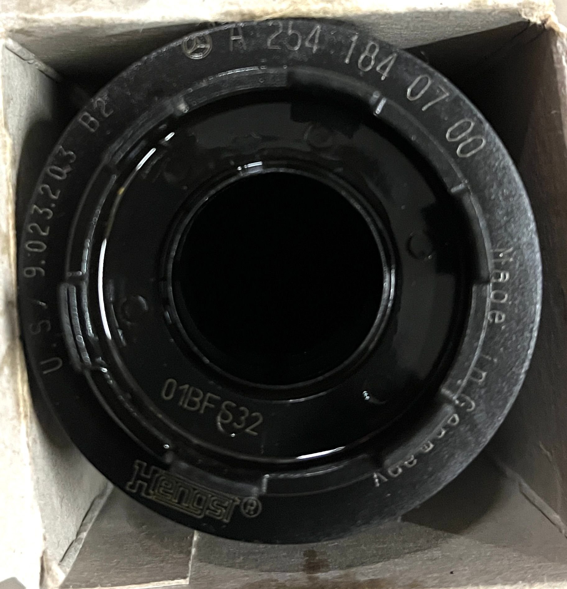

A few months ago @L1Wolf reported oil filter part number discrepancies for his W214 E450 as follows:
Oil Filter:
254-184-07-00 - Original In Car
254-184-06-00 - Provided by MB dealership parts counter
254-184-05-00 - Stamped on the actual part from MB dealership. Box has the "06" PN
I experienced the same with the oil filters in my E53.
254-184-07-00 original filter in car.
254-184-06-00 part number on replacement filter carton.
254-184-05-00 Part number on new filter.
254-184-05-00 part number on new filter.
