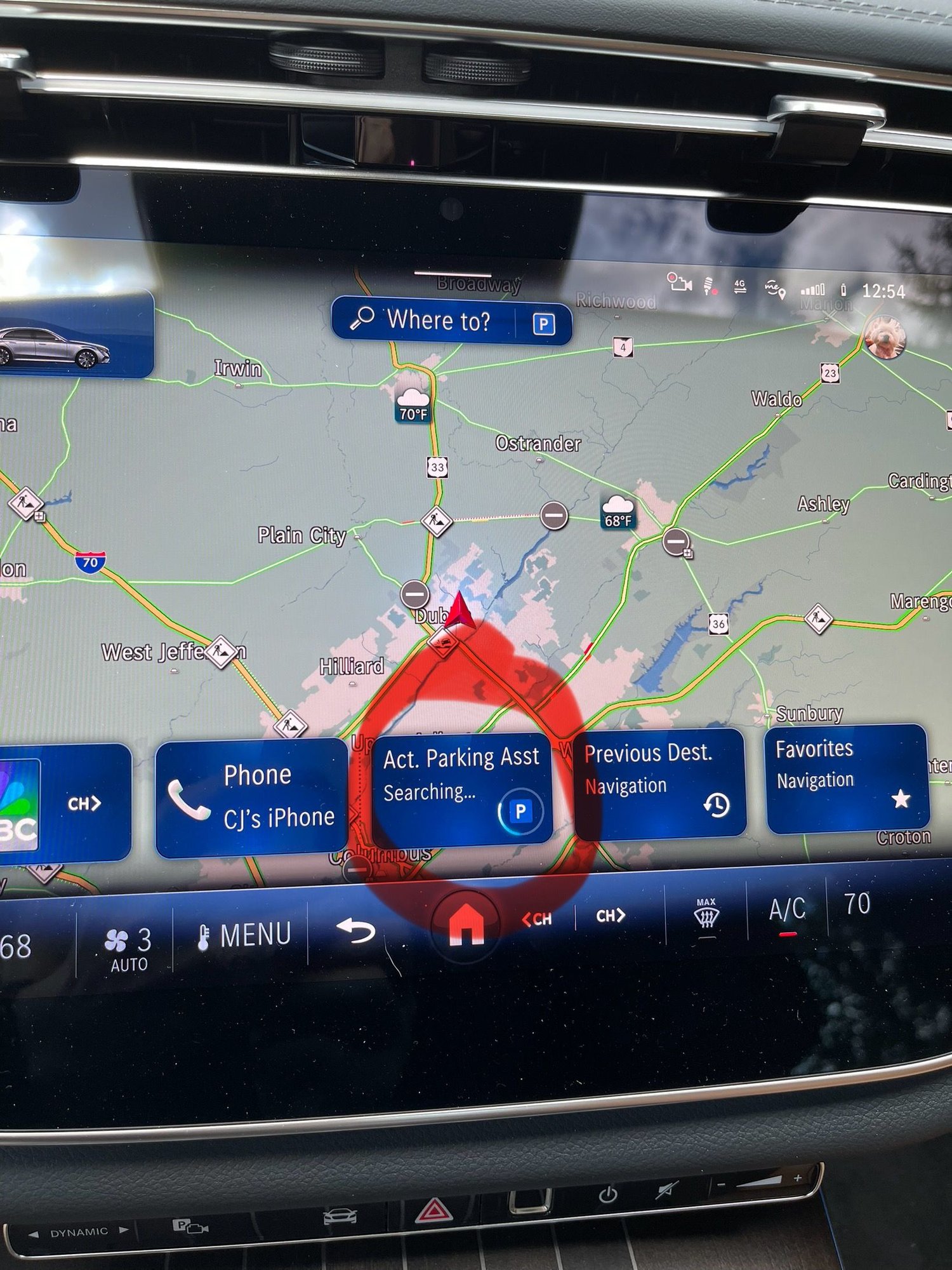

Why did the Active Parking Assist start searching when I was driving at low speed? Did I accidentally enable something?

Check your routines. The car learns behavior and may have added a routine to start it when under a speed and/or at a specific location.

Mine does this too especially when I'm about to pull into my garage. I think the car learns where the car typically parks or thinks you're looking for a spot to park if you're driving at a low speed elsewhere.

In my experience, when the car learns a pattern it creates a routine that you can see and edit. You can also delete it if you don't like it.

It always does that. Has been doing that even before the W214. Below 22 mph it automatically starts measuring parking spaces and indicates in the instrument cluster with an arrow pointing left/right next to the blue P logo when you drive past a suitable spot. No fancy AI or anything at work. Quick search in the owner's manual would have answered this. Now the Zero layer UI uses AI to determine what you use most often and when, and then surfaces those functions in the UI at the appropriate time. So Active Parking Assist has always been scanning for suitable parking spaces below 22 mph, but the Zero Layer AI eventually determined when to show it to you in the UI.

Mine does not do that. The P will come up under a specific speed, but the car does not actively look for spots unless I tell it to. I don't see a setting to do this either. Parktronic is either on or off. In the OPs case, he is seeing it activate in the center screen. I suspect a routine is turning it on and that is super easy to verify. Just look in routines and see if there is one that starts park assist.

I'm not ruling out that they've changed something in the W214, but what I described is how the parking assist always worked so far. The blue P comes up below a certain speed and then as it detects suitable spaces indicates it via the arrows. The button that OP sees popping up is to start the actually parking assist. In older models we had a dedicated button in the center console for this. Now that everything is touchscreen you have to go look for it, unless it presents it to you automatically, but it should still be automatically starting to scan for parking spots below 22 mph. If yours doesn't do that, I'd argue that's a bug. I haven't driven a W214 yet, but I've driven many of the other latest models as loaners and they all still do it as I described.
I pretty much never use the automatic parking, but I take advantage of the P showing up and measuring the spots, so then when it determines the spot is large enough, I know I can fit and park myself. Especially useful when I'm driving a loaner where I'm not used to its dimensions yet.
