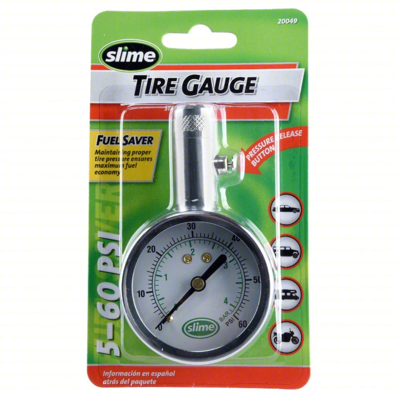

So I've used a tire pressure gauge similar to the one pictured below, but I noticed that it always reads 2 psi LOWER than what the tire pressures in the Mercedes TPMS display shows. So if my Mercedes display shows 38 psi then my gauge will show 36 psi. It's been like that on my old W212 and now on my current W214.
My question is which one is more accurate?
I just bought one of those small portable lithium powered air compressors from Amazon yesterday and when I connected it to a tire it showed the same psi that my Mercedes display shows, which is 2 psi above the tire pressure gauge reading.
I know it's only a 2 psi difference, but I'd like to know which reading I should rely on: my tire pressure gauge or my Mercedes TPMS display

It is time for a more accurate mechanical pressure gauge.
The tire pressure display in my '18 E300 is accurate. It matches the readings from my mechanical pressure gauge and my air compressor.

Same for me: I have an electronic tire gauge plus an air compressor with an electronic gauge on it. Compared to the TPS they are always the same or within 1 PSI.
What you need is an electronic (battery) gauge that records and holds the pressure. There are many on Amazon for less than $20.

The average accuracy of TPMS is around 1-2% across the industry, or +/- 1-3 psi, so they are not super accurate. The resolution is also typically only 1 psi. Mine generally reads 1 psi higher than actual compared to a shop precision electronic tire gauge with a resolution of 0.1 psi. TPMS doesn't have to be very accurate as it's designed to alert you if the pressure drops 20-25%. So if they read slightly higher or lower, that's irrelevant as long as it alerts when the pressure drops 20-25% from the stored reference pressure, which is all the laws require.
