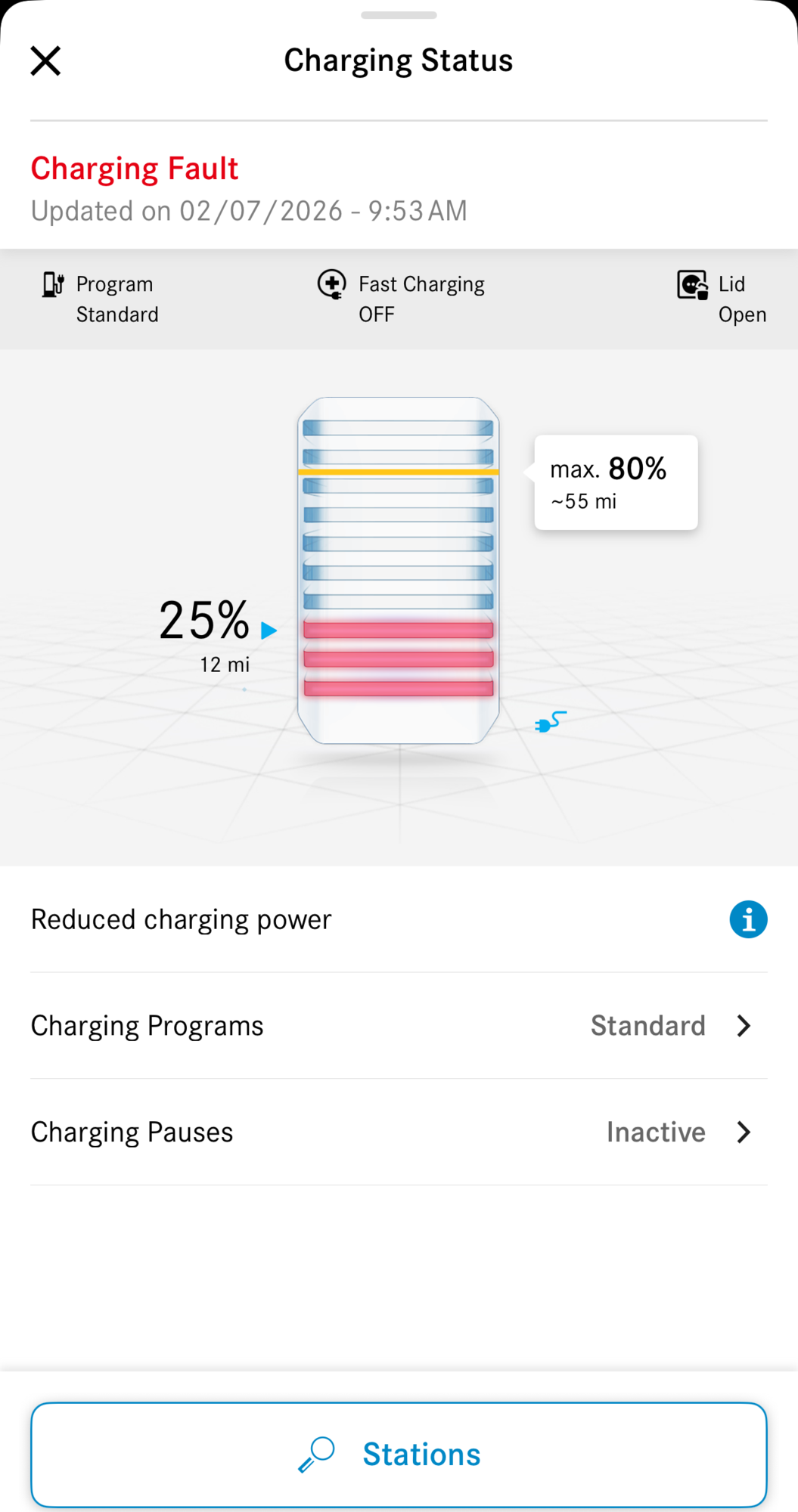

Hi guys/gals,
my E53 started having charging errors yesterday I don’t know if the last update had anything to do with this or it’s just a coincidence. Anything I can do before going to the dealership?

You should try a different L2 EVSE and an L3 DC charger to see if you could determine whether the fault is being caused by the charger or the car.

It’s not the charger because it charges my EQS just fine.
interestingly, I left it plugged and it started charging the E53 but very slow at 2.0-2.5 kW. Usually its 9.6 kW

Just an update for everyone. Took it to the dealership. Turns out there is a coolant leak from a damage in the radiator by a rock chip! Leading to charge at lower speed to avoid heating and sometimes cutting charge. When I took it today the check engine light came on early morning. Unfortunately not covered by warranty
I think its a bad part from the manufacture, the damage is extremely small. Unfortunately they wont admit that.
