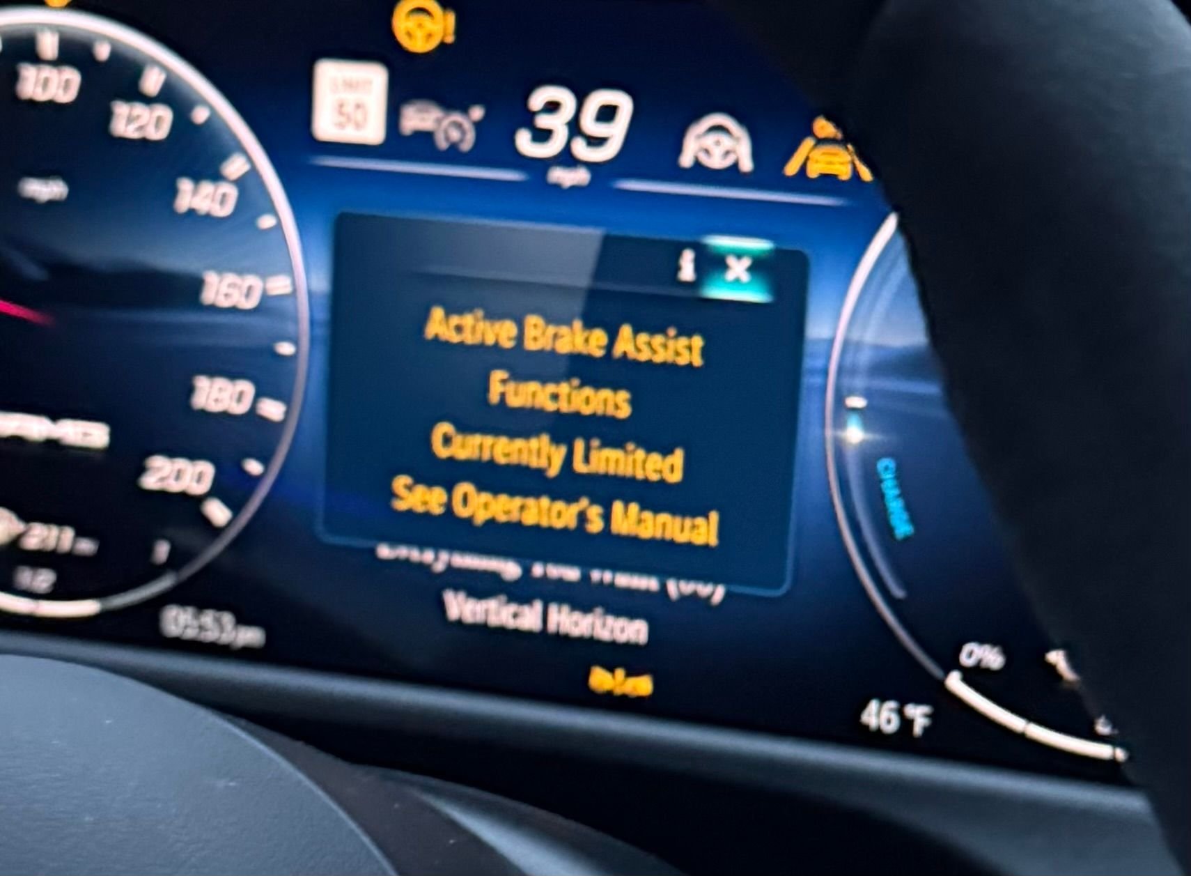

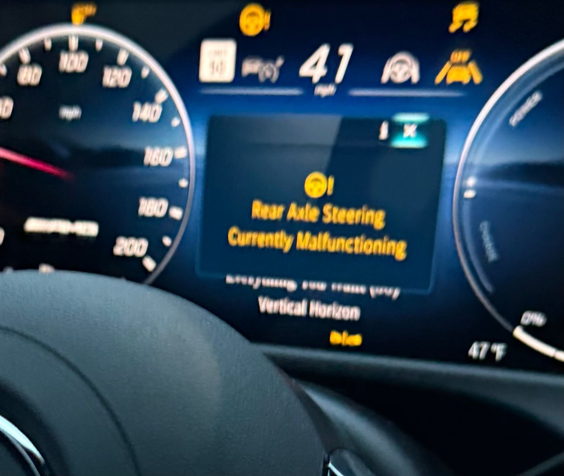

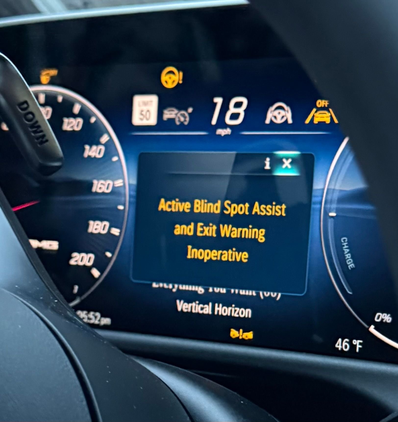

Was greeted to a symphony of warning messages while driving. Started about two minutes into my drive. Pulled over turned off the car, restarted everything, and after a moment they went away. Any ideas? Or just the wonders of modern machine machinery?

Similar reports from W214 owners here that are not unique to the E53. It may be a loose connection somewhere that causes an intermittent signal issue with one or more sensors/modules. Or it could be a software issue. Either way, a dealership is likely the only qualified place to get a definitive answer. Even if the problem went away, I wouldn't trust it. My car had an issue saying emergency stop assist was inoperative and would come and go seemingly randomly. I thought it might be the sun blinding a camera or bug splatter blocking a camera or sensors. Turned out to be a loose connection in the steering wheel.

First thing I'd check is the tire pressure. I (as many others across multiple models) have noticed that the current assist systems are impacted by having tire pressure even 1-2 PSI below ideal rating.

For whatever it is worth, things have returned to normal - no issues at all today.

The rear steer rack failed on ours (9/25 build) within two weeks and under a couple hundred miles of delivery. It seems there may be a bad batch of racks in the supply chain. Luckily the part is common to 214’s and isn’t a bespoke AMG part - was back on the road within a week and no problems since - just passed 2500 miles.
did not get limp mode, did default to all assistance off, dampers to full stiff, etc. powertrain operated as normal, and there was no alignment issue with the rear axle it just failed centered one morning.

I did not and it has been fine ever since. It was exceptionally foggy that day, so wonder if that was an issue for one of the sensors?

During heavy fog, blizzards, or ice on the sensors, my prior Mercedes would show messages that driving assistants weren't available. I haven't yet received those messages on the E53, so I can't compare with the messages you received.
Your messages about stability control and rear wheel steering are beyond the sensors that would be obscured by fog. I would guess that something happened with the control module bus if the errors were across control modules or within a control module if one module controls all those features..
It looks like something more than fog, but it is possible that fog caused a software bug that wasn't handled properly and triggered the other messages.
