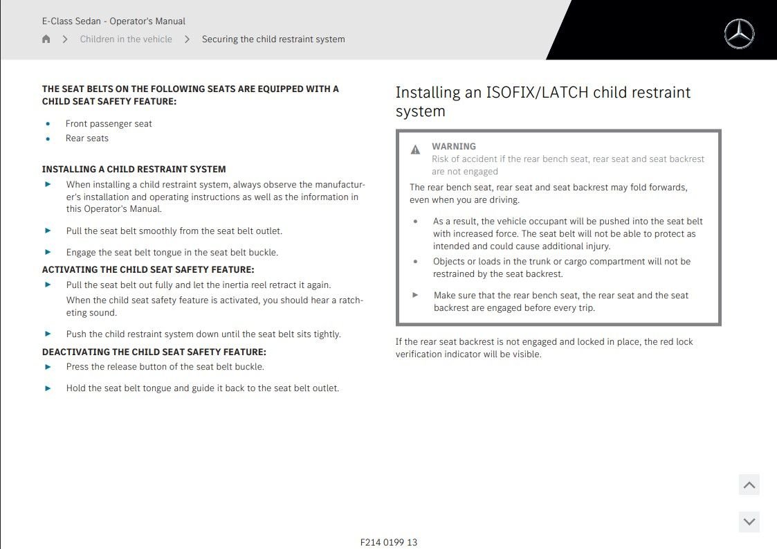

Sounds like the child safety may be engaging. Does it make a ratcheting sound when using the seat belt, may be an indicator.
