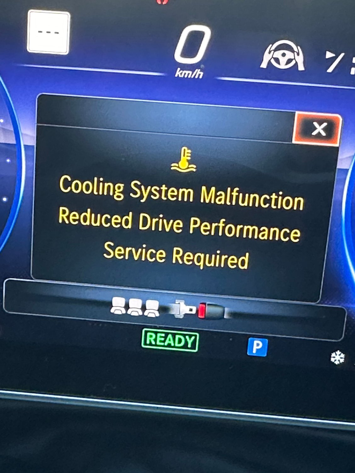

Cooling System Malfunction
Anyone else seeing this error?
Dealer says the car needs a new part - but no guidance on what. 3 weeks and waiting … still driving the vehicle.

That's pretty odd. Wonder if it's some sort of valve in the coolant loop that is used for heat pump, heat exchanger, etc. Though I'd assume that would be more catastrophic and would disable the vehicle. Whatever it is, I'm sure the car will do its best to stay within thermal limits and preserve your battery. Please keep us posted on what it was - did they tell you the part number? Would be interesting to look it up.
Was wondering if someone had part information myself.
I’ll report back. No feedback from the dealer on parts ordered yet.

I wonder if it's the servo-controlled cooling slats on the front? I noticed when it was really cold and covered with ice, my sedan made a crunching noise as the slats opened and closed during the charge initiation. If that servo is stuck, it could reduce cooling during DCFC. Simple fix, but annoying of course.
Could be. I checked them yesterday and they are open when the car is off (not sure if this is the default position or not).
The slates don’t move if I put any pressure on them.
I have noticed no adverse affects just yet with the error. Hoping dealer “parts” come in soon.

When you plug in your level 2 EVSE (I'm sure it also does it with DCFC), head to the front quickly, you'll see the slats close and open. If your garage is quiet, you'll hear the servo as well. When we had snow and cold temps, some ice had formed on the mechanism after a car wash. The servo is quite strong though. Curious if yours is working as described. Do post the job notes when your repair is done!
Just checked. The slats don’t move at all when I plug in (level 2) - they are wide open. Could be the issue (bad servo). Will keep you posted.
It usually takes 15-20 seconds before they start moving. If not, then you're lucky if that's the issue. It closes at higher speeds to improve aerodynamics. If they're stuck open, that's a good thing for cooling. The car assumes that something's wrong, so it may affect charging performance on DCFC a small bit. Looks like it failed safe, so good on MB for designing it that way. Either way, this is most likely the issue and is very minor. I was wondering if that would run into problems, seems like it may be a point of failure on the cars. Honestly not sure how much it really affects aerodynamics.

Yes covered under warranty. One of the cooling flaps in the front grill (bottom middle) got stuck in the open position so it threw that error. I think they changed the flaps and motor running the flaps.
