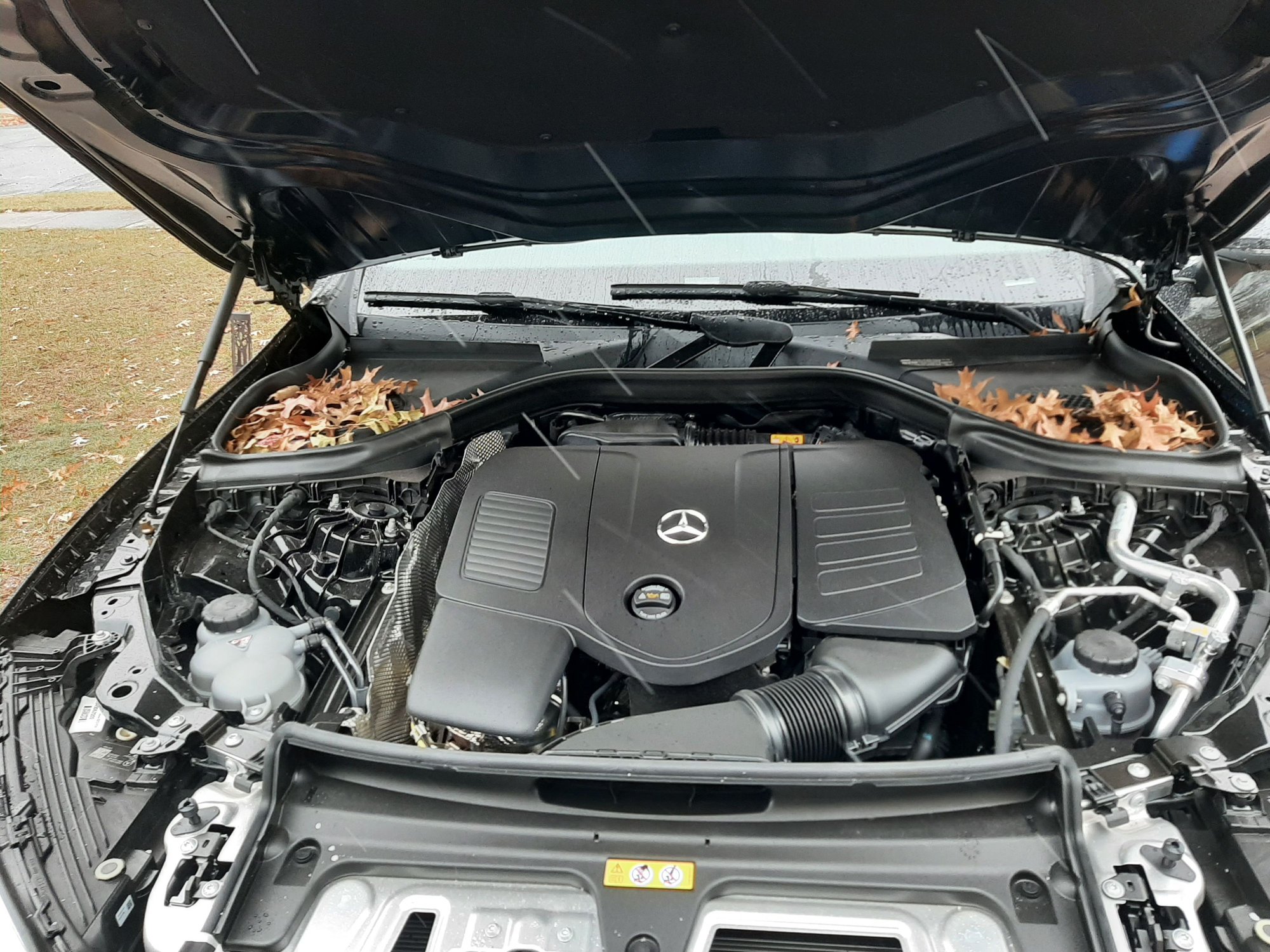

Old Jun 18, 2024 | 08:47 PM
avisiva's Avatar
Joined: Jun 2024
GLC300 2003
Originally Posted by stronkbean
So the same thing happened to me. I bought the vehicle a week ago and it came up driving it out of the lot. Had my partner take a photo of the dash. Took the vehicle in a couple of days ago and they couldn’t find any issues, even after they test drove it, and message didn’t come up again. Anyone else found out if anything?
I had the exact same issue and it was making a lot of noise even after I turned the car off. I opened the hood and there were lots of leaves ( have lots of trees surrounding the driveway) on top of wire-mesh-like set up on both sides. Once I cleaned up the leaves the noise stopped and the warning message also went away. The check engine light icon also went away after driving around for ten minutes. Hope this helps.
Old Dec 20, 2024 | 02:40 PM
DMULLI1's Avatar
Joined: Dec 2024
GLC 300 2024
COOLANT SYSTEM MALFUNCTION - check leaves inside
got this error message - coolant fan would not turn off even when ignition off - opened hood - both fan covers inside were covered with leaves - removed leaves - fixed problem - similar as below post
