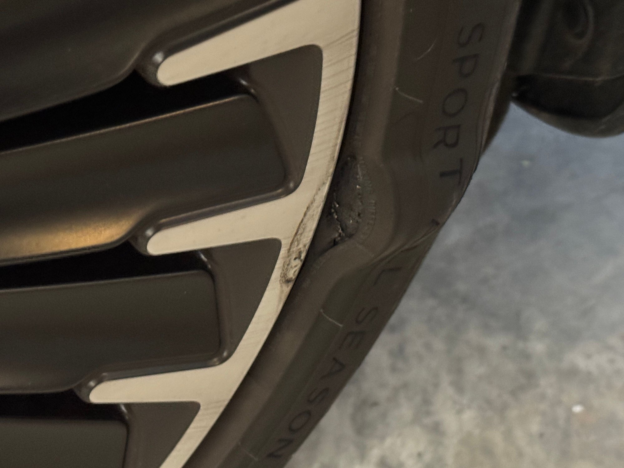

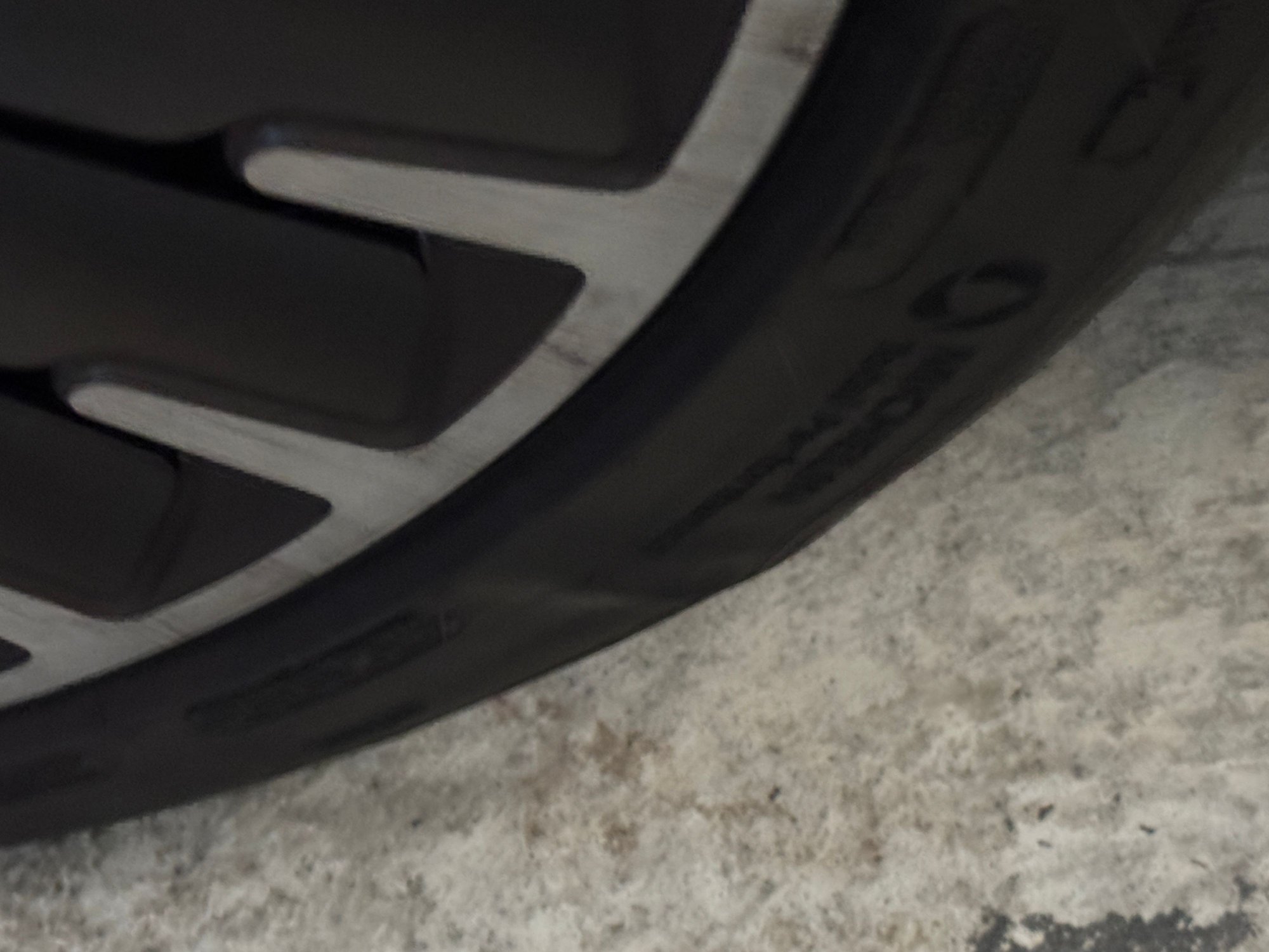

I noticed some tire bubbles in my side wall on both front tires. These happened on different dates.
Is this common? Would the tire be prorated on the Michelin warranty?

I have not experienced this on my car. The picture of your left tire looks like an impact failure based on the scuff on the rim. I keep the inflation pressures at 42 psi all around. Remember I have the original summer tires still installed.

Very heavy vehicle, low profile tires and potholes don't go together. As others have indicated, that's external damage from a pothole. Not covered under any warranty, unless you have road hazard coverage. Tire Rack and many other tire places now include road hazard coverage for free. It's fairly common with heavy vehicles these days. Yes, your tires should have HL load range. It's a new load range above XL for tires strong enough for these heavy vehicles, created especially for EVs. An XL tire will be even more likely to end up like this. Avoid potholes in the future or fit some offroad tires .

As stated, this is something that comes from impact... but imo its impact and a **** tire. The way I had this warranteed a long time ago with some Michelins on an Audi was to ask why the tire had a bubble but the rim was still in balance and not dented. This was to state that the tire pressure was fine but the tire could not handle the job. The left tire is an example of that. Sure we that can always blame the driver, but if you been driving for decades and its only happened on one set, its likely a poor product. Yes we like to increase pressures to avoid this, but the tire should work at recommended pressures or its the wrong tire for the job. Fortunately when I had the issue, it was when Michelin had tons of issues with bubbles in tires so they just gave me a new set of a different brand. Ive never bought a set from this brand since and really like tires that have more rim protection for these low profile options. Ive never had a bubble since, with tons of potholes and even recently cracked a rim on a square hole at high speed with no issue to the tire.

I agree with you on the tire. I drove my EQS580 for 2 years with 21" wheels and never had an issue. And those were Pirelli Runflat tires. I don't recall hitting a major pothole. My sense is this is the result of day to day potholes. I looked more closely and there are two separate bubbles on the right front, and one on the left.
That said since my car is a 2 year lease and the rear tires are fine, I'm just going to replace the fronts with new tires which include 2 year road hazard, and buy road hazard certificates from discount tire for the 2 rear tires.
