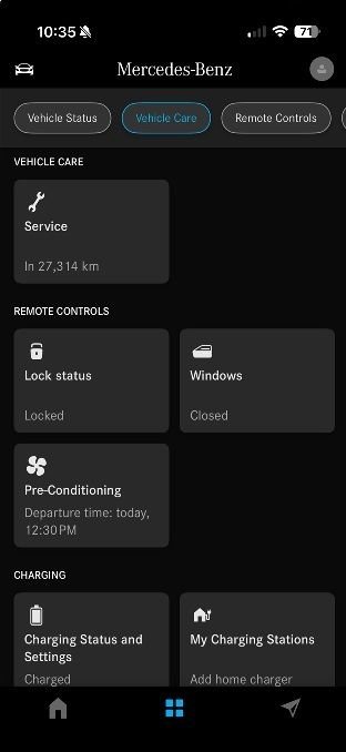

Here is the icon I have on my MB iPhone app that allowed me to enable the function.

And here is mine:

I wonder if you have all of the right Digital Extras switched on, or perhaps you EQE is not outfitted with the right hardware.
Old Dec 12, 2025 | 11:13 AM
LastOne's Avatar
Joined: Mar 2023
Posts: 368
Likes: 136
EQE350 SUV 4MATIC
I have all the possible Digital Extras enabled, 47 in total, except for:
- Beginner Driver and Valet Service Mode
- Acceleration Increase
- Forwarding of Anonymized Vehicle Data to Third Parties
It is likely that my car does not have the hardware needed.
