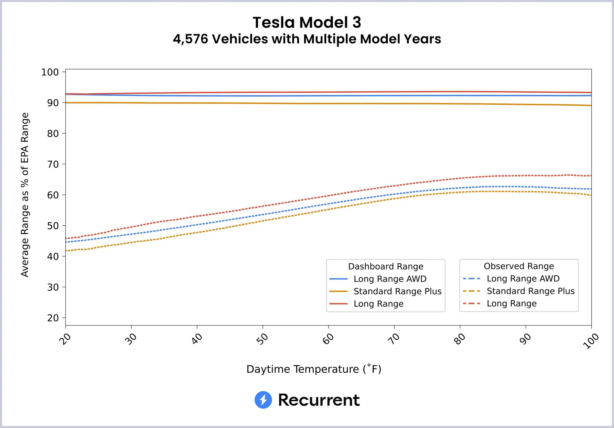

First off, welcome to the community. Hope you can find some answers that help you. As for the range, it is a prediction, nothing more. My experience with Teslas is that the range is only predictive when navigation is enabled. Otherwise, the range is sugarcoated and then non-linearly dives when SoC hits 50%. Like I said, my experience. MB on the other hand factors your driving habits and the temperature a-priori. You are not getting less charging capacity, or even range. It's just trying to tell you ahead of time that winter driving is less efficient. Recurrent had a big meta study that it just released. It shows that Tesla cars, for instance, do not sufficiently adjust the predicted range on the dash based on temperature. The actual range though, varies greatly, by temperature, and so the car has to "catch up" as SoC drops. In contrast, I've found that the MB display is, if anything, quite conservative in its estimates. You can literally watch the prediction change as temp drops, and you can see the contributing factors in the range estimate in the EQ panel. Your battery size hasn't changed, and is the only constant in this equation that cannot change. Everything else will be variable based on energy consumers in the car. Hope that helps, the car is doing what it should and giving you fair warning about increased power usage.
Just so I back up my statements with fact, here's some data from the Recurrent study. This is over 4500 vehicles, some of which have heat pump, some of which don't. As I'd mentioned before, the dashboard-indicated range is temperature-invariant, which doesn't match up to how the battery chemistry and consumers change in cold weather.
Me personally, I love the fact that the MB car will keep ahead of things and let me know how much I can expect. The 100 kWh batteries in the EQE have been excellent for range and performance, based on all of my experiences.

I have owned a Tesla, for 4.5 years prior to getting the EQE. The Tesla's GuessOMeter was consistent from summer to winter, but that doesn't mean it was right. In winter, it was impossible to actually get that range. I took regular 180 mile trips to visit relatives and while it always started with 290-300 miles reported range, by the time I got there, in winter, it would report 50-60 miles so my total realistic range was closer to 220 miles.
The EQE on the other hand displays a more realistic range so while it's surprising to see the lower number, at least it's realistic. I much prefer Mercedes' approach here. I don't want to plan a round trip thinking I can make it back home without charging, only to realize I'm at my destination and scrambling to find a charger. With the Supercharger network, that's not a big deal, but if you have to rely on EA, well...
