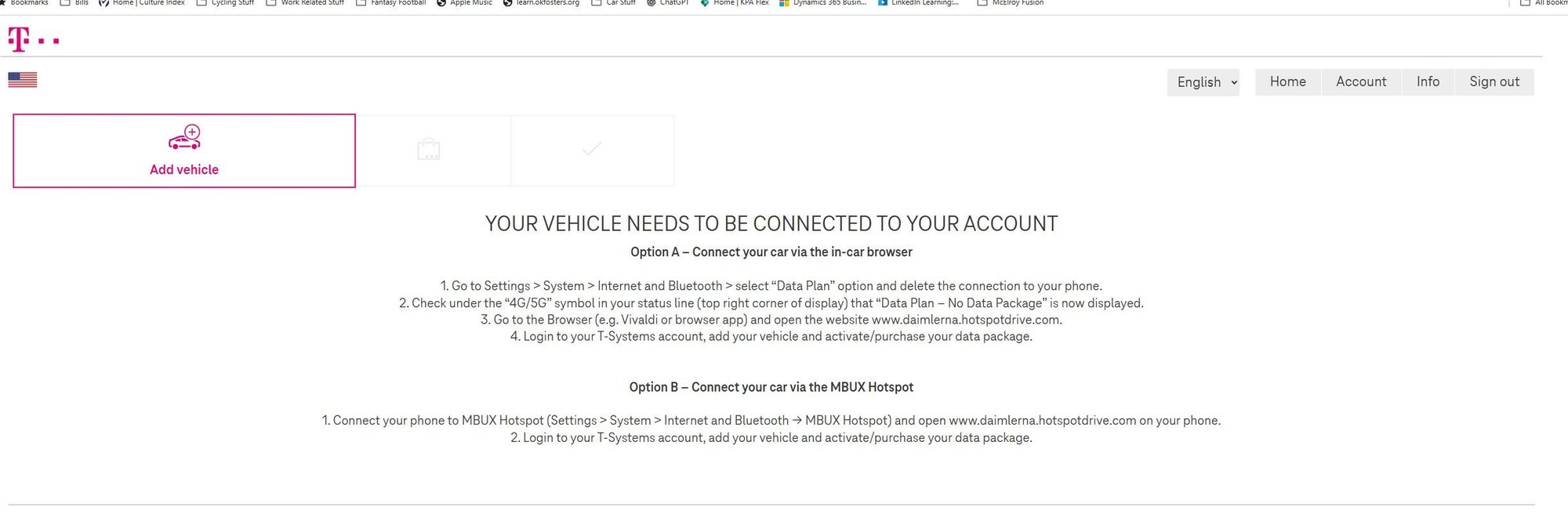

So I searched up on this site how to get the hotspot in the AMG connected up, and I have had nothing but issues. I attempted to go to the site: https://daimlerna.hotspotdrive.com and set up the account, but when I go to the "add car" button, I can't touch select it on the browser in the car, click it on my browser or anything.
It is almost that the site is down or something.
The top left corner won't select!!!!
I'm literally TRYING to give T Mobile my $$ and they won't let me in.
Is the site working for everyone else?
Frustrated...

Did you try the Option A or Option B items?
Tried both with no luck....
were you ever able to activate it? I have the same problem on my GT and the hotspotdrive phone line never picks up for support.
Edit: I was able to activate it! I setup my wife's profile for the first time (new car) and followed option B and I was able to sign up with my iPhone. It opened a portal after connecting to the hotspot for me to activate the plan.
