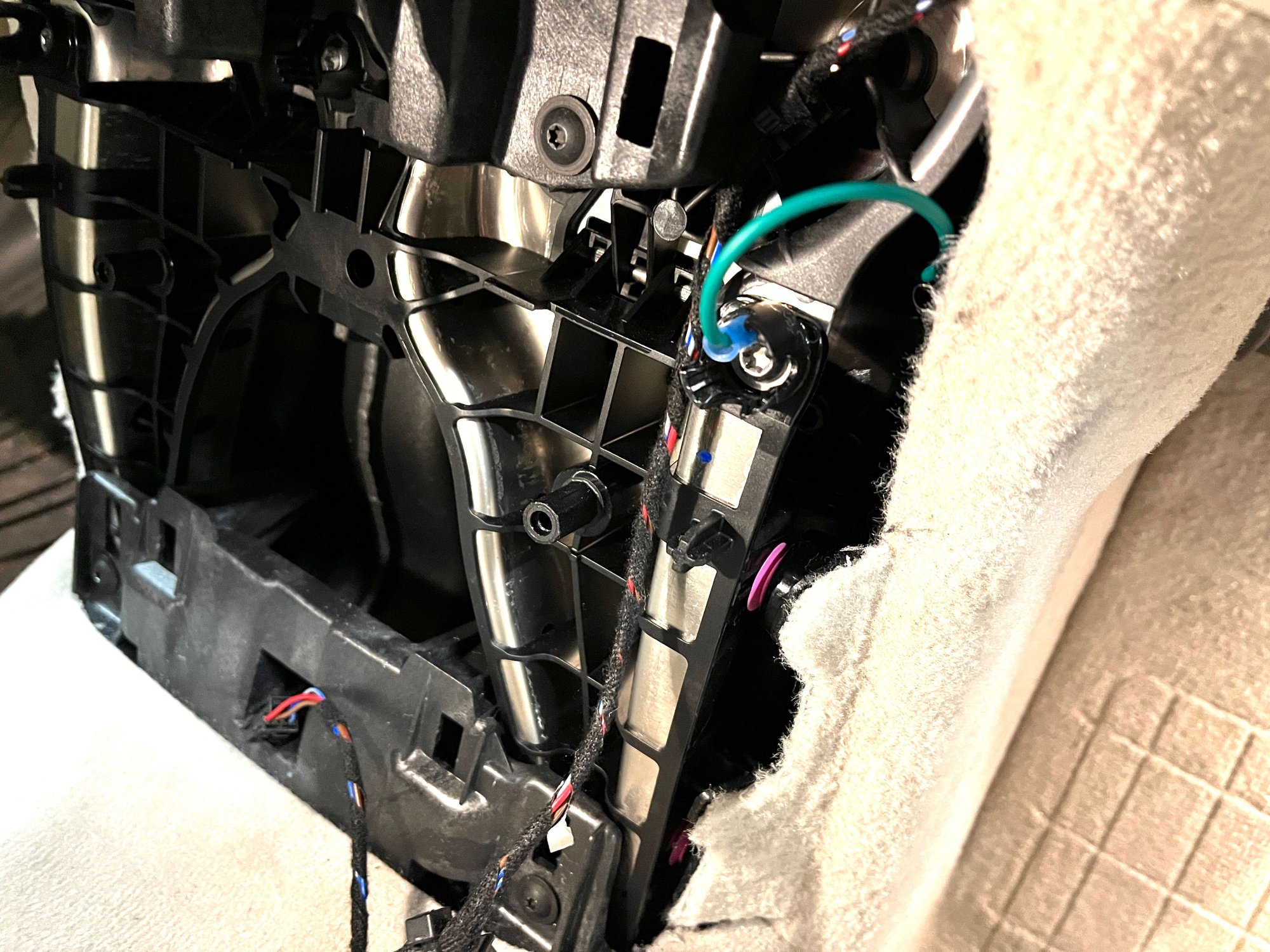

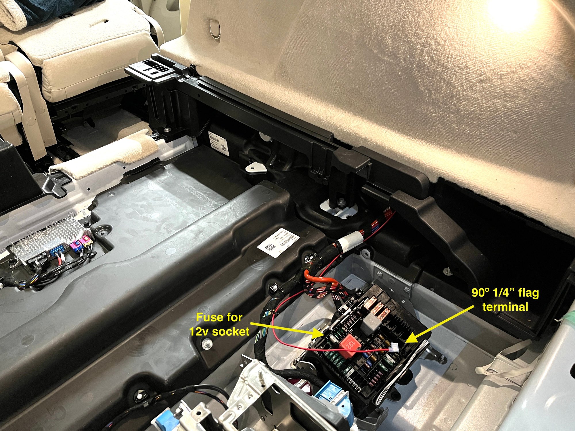

Here are some photos of the 12v accessory socket wiring project. I will post more photos when I get a chance.
Fuse panel below floor of storage compartment below cargo floor (no third row seats).
Ground wire in center console area.
Fuse tap in center of photo works with existing fuse in MB fuse panel.
