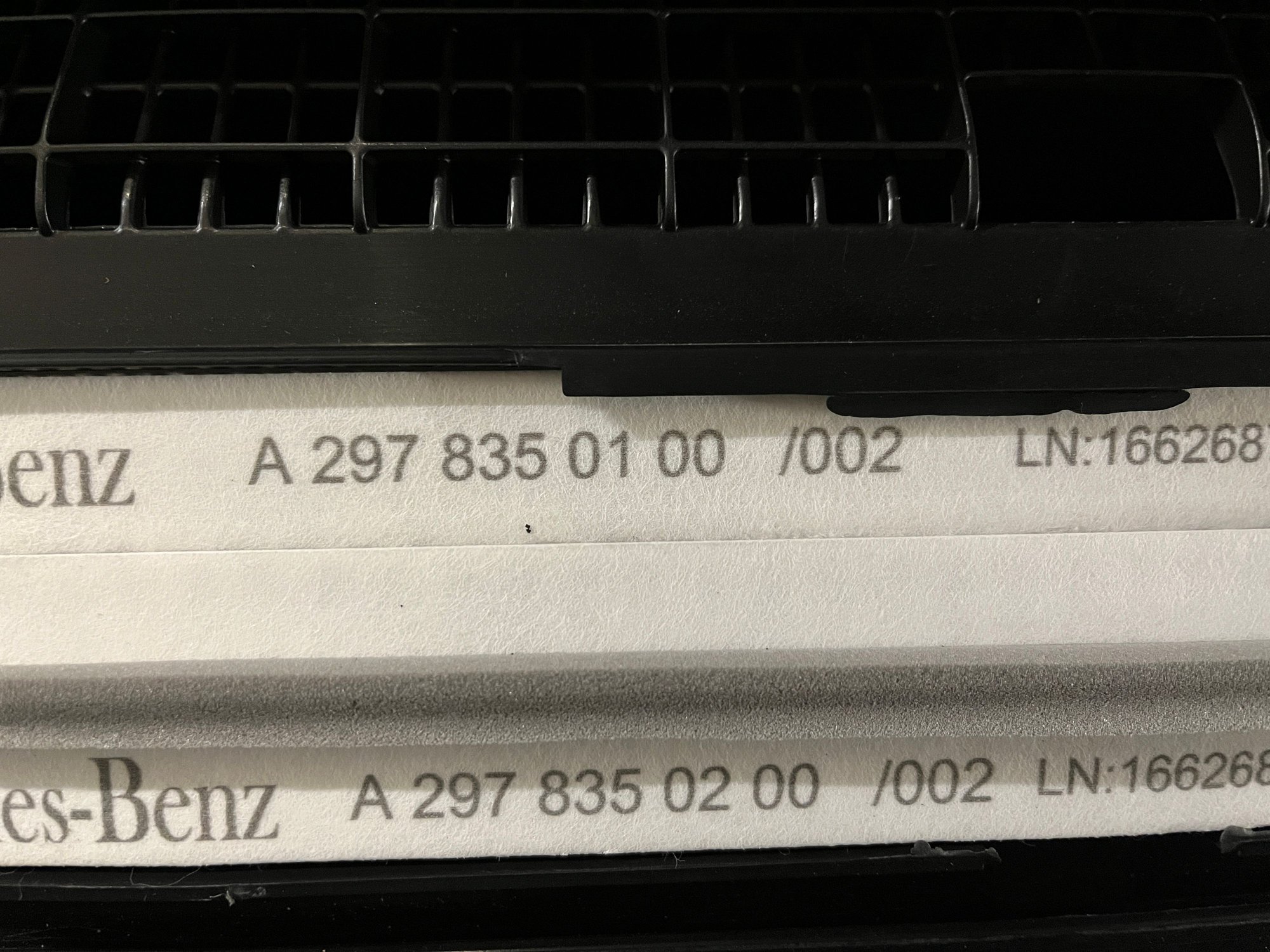

Has anyone changed the EQS SUV cabin filter?
I ordered the following parts in preparation for a DIY 40K mile service in a couple of months. Prices shown are discounted online prices.
Part Number Part Name Price
297-835-01-00 Dust Filer $64.18
223-835-24-00 Fine Particle Filter $87.77
296-820-15-00 Wiper Blades $76.80
167-820-49-03 Wiper Blade $20.74
The part number for the front wiper blades changed. The old number was 296-820-71-00.
It's not clear to me whether the
223-835-24-00 filters are changed from inside the cabin by removing the glove compartment, or from under the hood by removing panels near the 12v battery. Can any forum member shed some light on the procedure for changing the cabin filter? I have not been able to find any online videos for either the W223 sedan or the EQS SUV.
It's also not clear to me whether the brake fluid should be flushed again at the 40K mile mark, or if it's okay to wait for two years to change the brake fluid.

I read somewhere that the HEPA filter replacement is under the hood. I opened my hood, and it seemed like the big *** filter aka the HEPA filter is replaced there. I'm not sure if there is a cabin filter under the feet, but I would like to know as well. BTW, where do you go to get the different part numbers for the EQ? None of the online website will work for EQ search.
The part number for the HEPA filter is 297-835-02-00. My understanding is that it is changed every 50K miles. The 297-835-01-00 filter is replaced every 20K miles. These filters are fairly easy to replace.
Changing the smaller cabin filters is not as straightforward.
